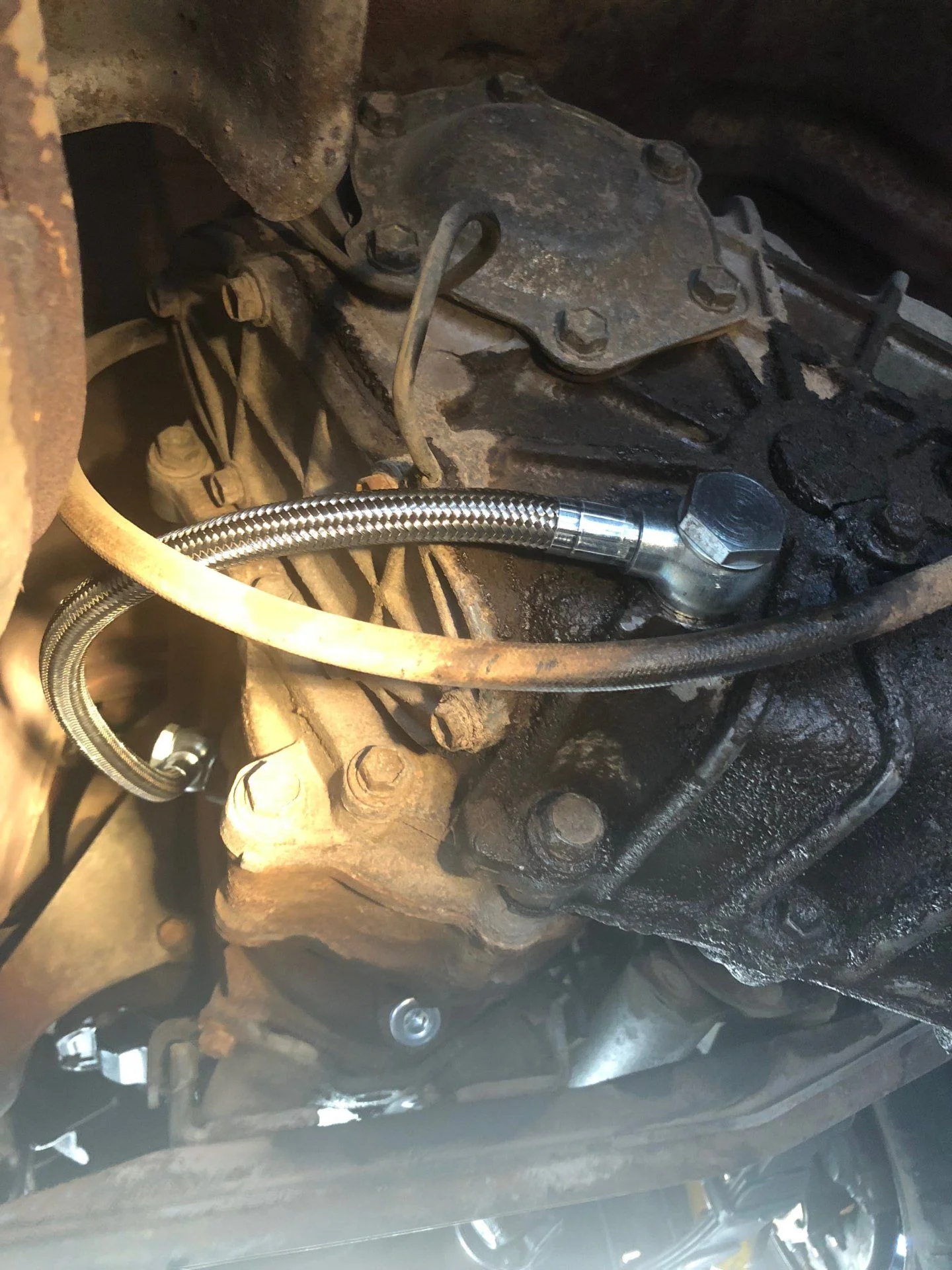

Contact @shipmag he sell a very good quality hose I took my old Man-A-Fre hose off and installed his today. it is very nice and fits real well, no need for adapters or anything and uses the standard size wrench to take it off.
If you have a 60 with the extension between the trans and transfer case (I think late 85 or late 86's had these) you want the 17" hose. otherwise the smaller hose fits fine.
Only changed mine as I needed to change the oil anyways. When I replace my trans i will fix the issue and probably still run the hose.
If your interested in the transferhose send me a pm and Ill send you the paypal info and everthing you need to know. The braidedstainless steel hose with the teflon liner keep the heat from the tail pipe from shortening the life of the hose. But still that tailpipe is hot. Even with this hose you still cant have it resting against the tail pipe.
Drained and refilled the transmission and t-case today and was glad that plenty oil came out of the transfer case. I installed the new Transferhose I got from @shipmag. It was super easy and very nice quality; and it's nice knowing I have a semi-permanent fix in place. You can see toward the back on the transmission I also replaced my drain plugs with the 10mm allen wrench style newer toyota plugs. So much better. In fact I bought enough to replace my diff plugs as well. Here is the toyota part number: 90341-18021. I bought a couple through the local dealer and then paid at least 1/2 even with shipping from toyotapartsdeal.com. They are magnetic and I know I don't need those for the fill plugs, but they fit and I didn't have to go hunt down another part number.
