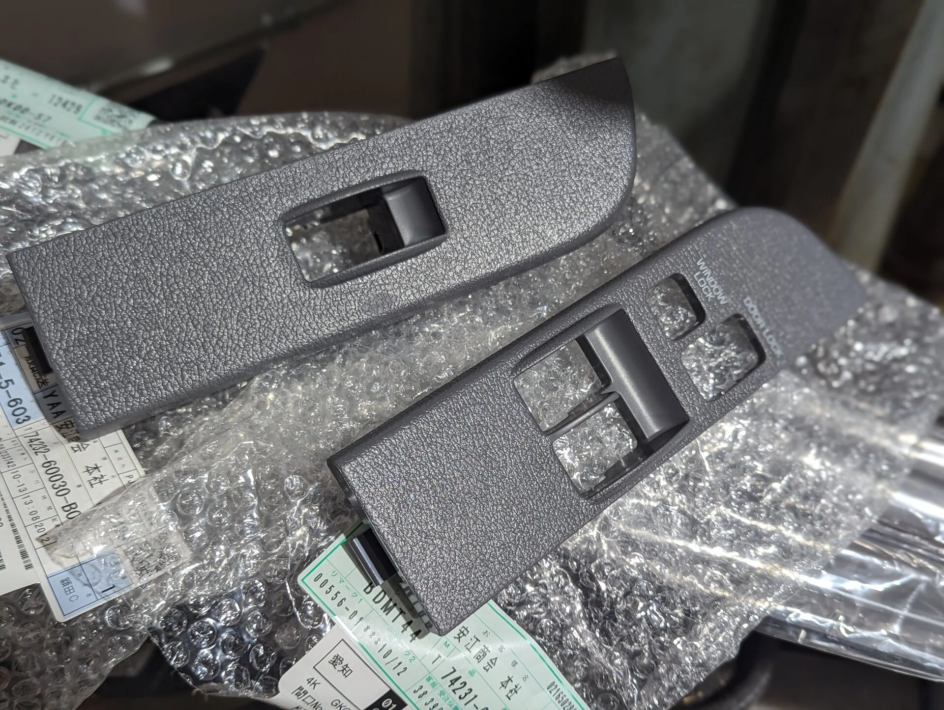

Meanwhile, there's some actual building going on in this thread, for the first time; a few parts that I bought and stored before The Exodus finally made their way west.
Pictured: New door scuffs...
Also Pictured: ...and some armrest dinguses.
Okay, so it's not the most buildy of building, but it's better than me just going back and authoring retrospectives and/or stumbling through lightbulb purchases. While we're on the subject, however: I've mostly finished the edits to Post 2 and Post 3, so if you want to see how the trip turned out, definitely give those a look.
