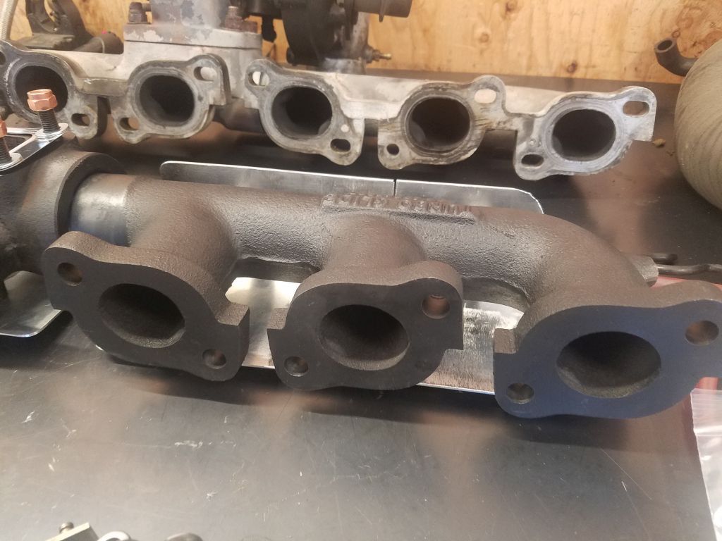

Here are the bits I upgraded with. Turbo Glide in Aussyland made the original manifolds, and have since REALLY beefed them up. Look at the side by sides. Outlet and orientation seemed to match original Safari.

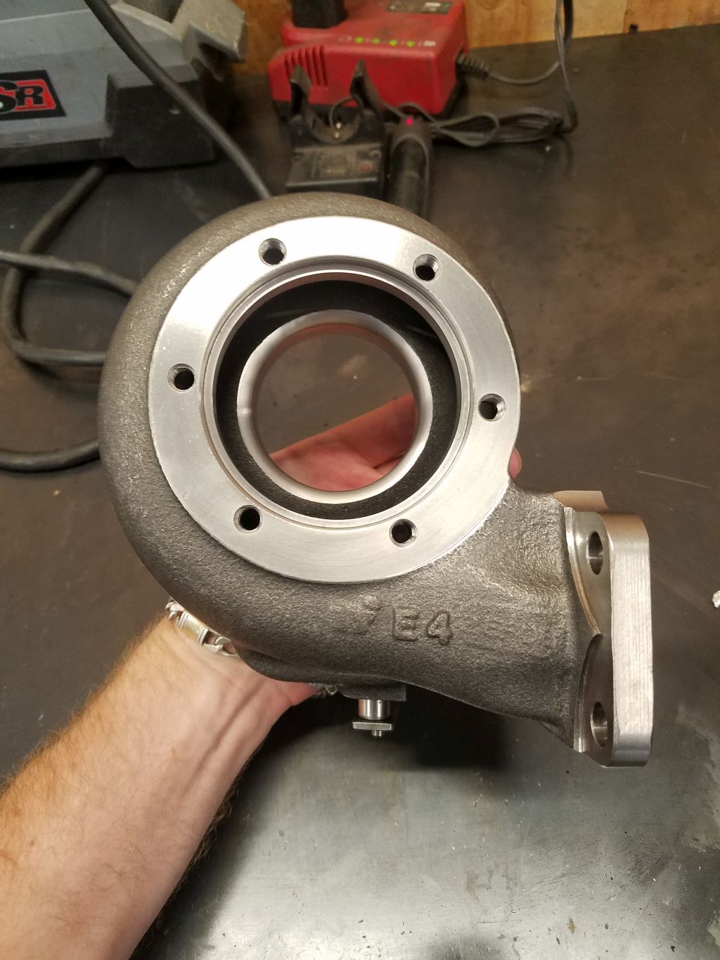

I then found a better housing option that had the exhaust outlet integrated, removing one more point of failure while adding better flow. Then I bought an adapter to convert the outlet to V-Band to allow better flow / easier "clocking" of the downpipe. I also added a beefier / longer flex pipe to the down pipe to help take stress off the studs. Two years and thousands of miles of heavy boat hauling later, its holding up VERY well. Performs close to what the Safari did originally if not better.

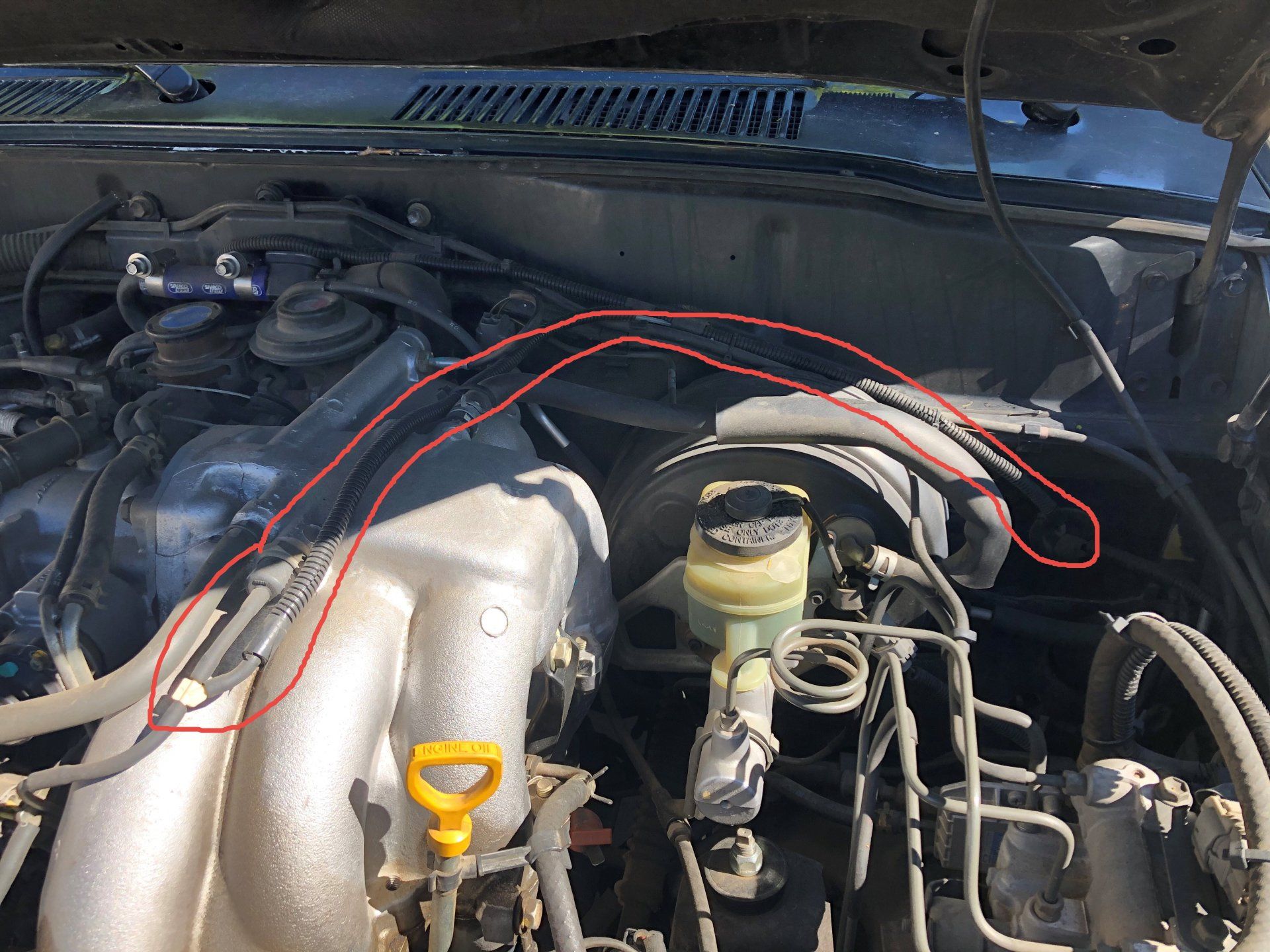

Another issue I had recently was that my PCV hose from the turbo inlet to the valve cover cracked from brittleness due to age and heat. It is a custom formed hose something like a shepherd's crook, and it's pretty long. My short-term, but what may turn into a long-term, solution was to go to NAPA to match it up. I found that by using a 9801 hose, a 9923 90 degree plastic elbow, and a 9802 hose I could recreate the shape close enough to get me rolling. There was a little material that needed to be trimmed off either end of the hoses but it's okay and the hoses are readily available. The 9801 is 1/2" ID and about 10" long with a 90 degree bend, and the 9802 is 1/2" ID and about 16" long also with a 90 degree bend. I used the 9801 to go up and over from the valve cover, then the 90 degree elbow turned down, then the 9802 went down and over from the elbow to the turbo inlet pipe. I may keep an eye out for an OEM application that follows a similar enough routing that it could be used, but am not hopeful of that. I also contacted Safari but I doubt I will hear back from them or I expect their response to be that the hoses were custom formed and no longer available.

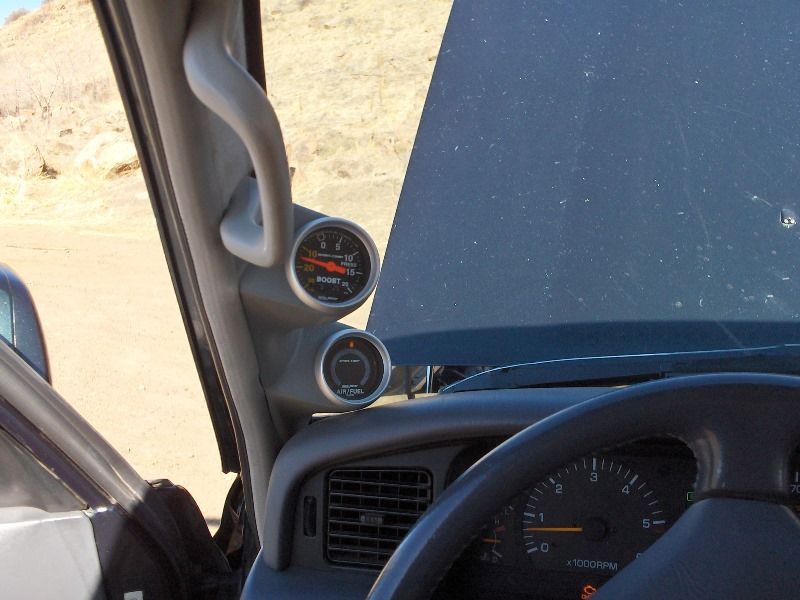

I'd like to put a gauge on my boost and bump it up to 10 PSI as Turbocruiser has talked about on his. I need to put a boost gauge on, where have you found is the best place to tap in? Also would love to see where you mounted your gauges? I might get an AFR just to be safe also, even though it sounds like it's pretty safe with stock mapping from what I've read. If you have any pics that would be awesome! Also if anyone else has ideas, I'm all ears!
Mine has been running with the boost connected here for almost 20 years:
Goes through the firewall grommet and up to a dual-gauge pod (I think from an Acura, and may not be available to find any more):
Here is the current gauge thread:

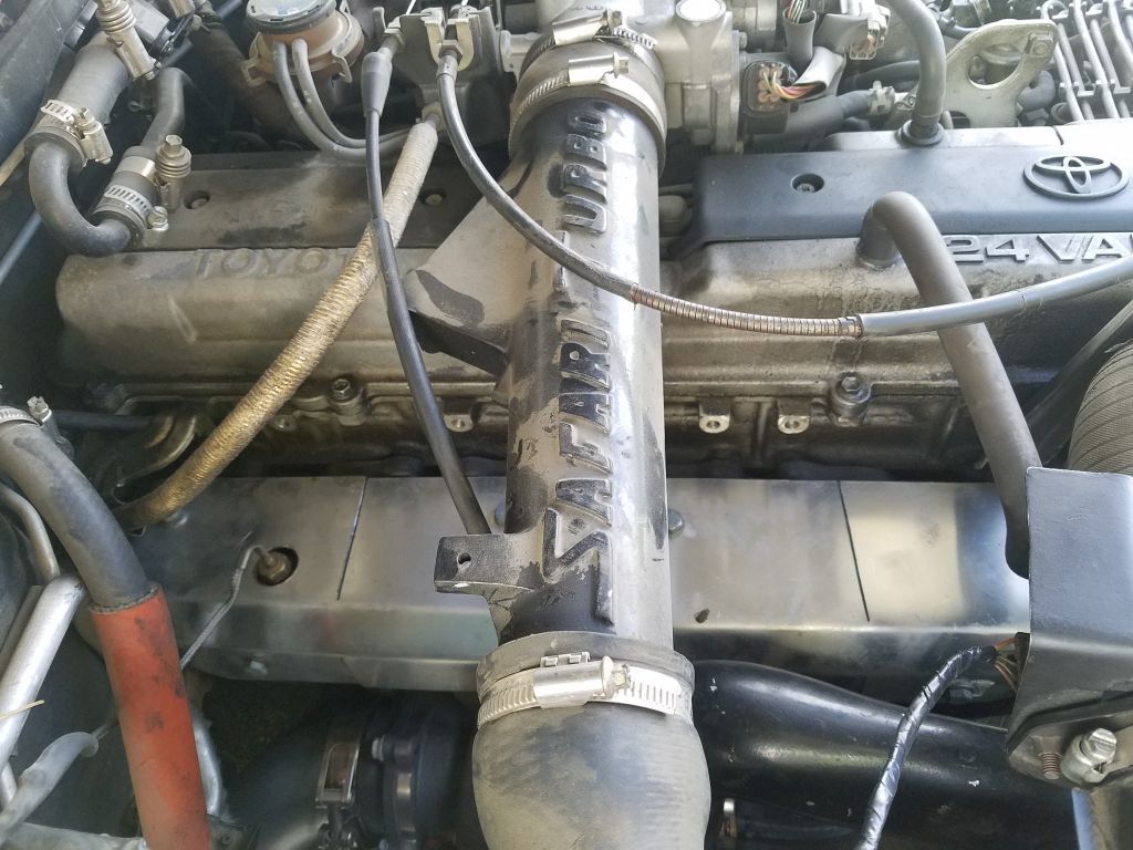

Can you guys get pics of the intercooler mounting and how they moved the oil cooler?
Thanks for the info Sublazi. Got the new actuator in and did a boost leak test just to check and found I have a hole in my upper intercooler hose where it has rubbed on the ARB bumper. Where on earth would I find a rubber hose like this with the 90' bends? I was able to patch it for now but not sure how long it will last...
Most of the intercooler piping is 3" ID, but measure the specific piece you need to verify. I just did a Google search for "3" intercooler hose" and came up with a bunch of hits for silicone couplers and elbows. I'm sure you could find one to match what you need.
Safari provided new brackets that mount the intercooler in front of the radiator:
The bracket provides a new support for the hood lock assembly, and you have to move the horns a bit. You also have to eliminate the stock transmission oil cooler.
For the transmission cooler, the Safari system came with an all-new transmission cooler that mounted low between the frame rails:
If you are interested in A-A, I always thought it would be interesting to contact Safari to see if you could order their diesel A-A intercooler kit. They still make it, and I bet it's the same as this intercooler, except for some of the charge hoses that would come with it. There are probably cheaper/better ways to come up with an A-A though.
