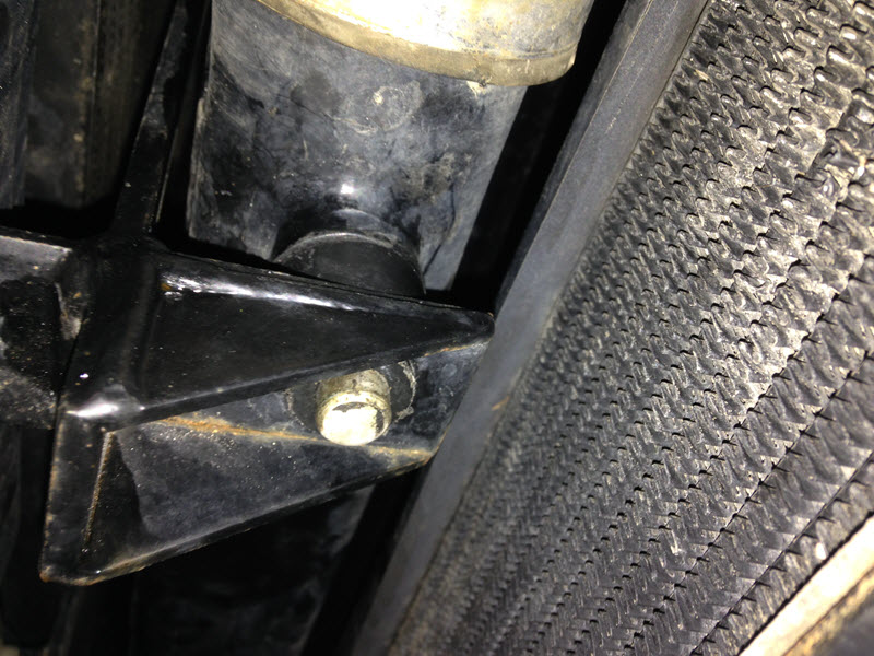

Hi, if anyone has a safari intercooler would you be so kind as to post pics of the mounting setup and basic support bushing dimensions? I am trying to see if these will work on my US petrol 80 with NLA Safari intercooled turbo with rotted intercooler support bushings. Feel free to post here or email me at theonlysubzali@gmail.com.
This is somewhat urgent.
On a related note, does anybody know the part number and whether they can be ordered separate from a full intercooler kit? Any contacts in Australia? I've been chasing my tail on this for months and cannot get a hold of Safari.
For reference I am needing 4 bushings of the approximate dimensions below - these I'm hoping are the same as what the diesel intercooler uses.

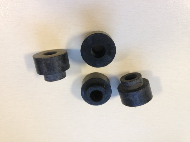

On April 14 I placed my order. On May 11 they arrived in my mailbox.
Beauties ain't they:
As stated above they are for the diesel intercooler application but they looked and measured the same as the ones for my petrol intercooler. As I suspected. Bwahaha.

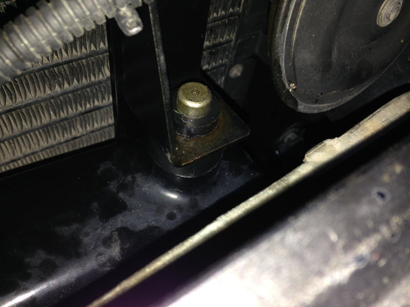

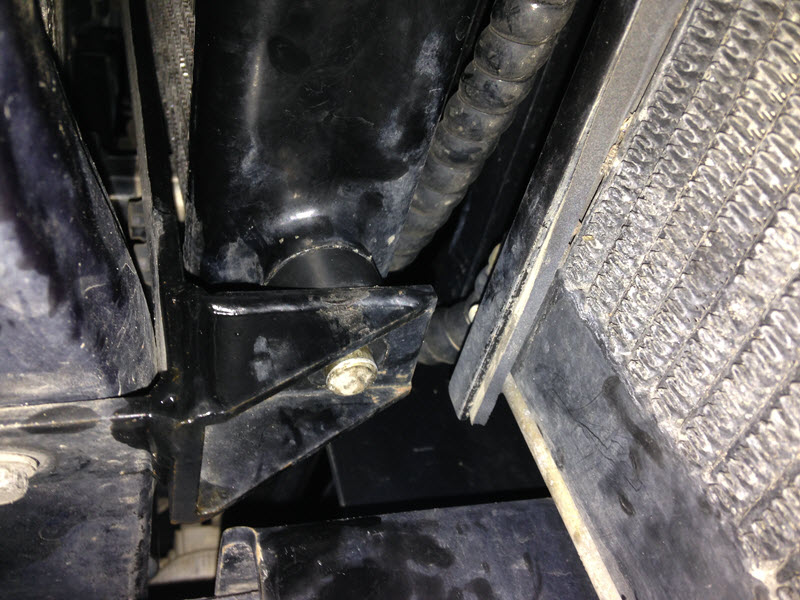

So I promptly went about installing them, and here is the final assemblage:
It turns out they are made of black polyurethane, so if I ever need to fabricate new ones it shouldn't be too hard for a performance/speed shop to help me with such a task.

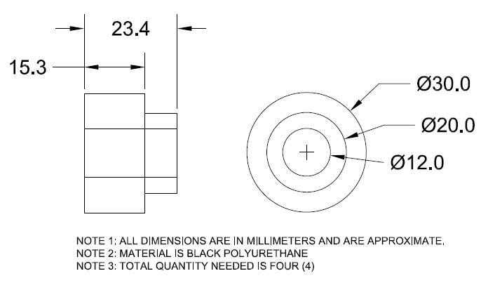

To that end I took some measurements and drew up a sketch for posterity:

I machined my ones out of a bit of red urethane and still have some left over to make more.
