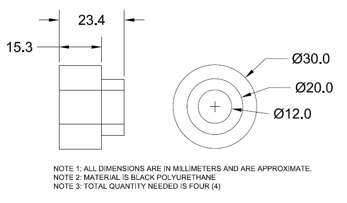

It turns out they are made of black polyurethane, so if I ever need to fabricate new ones it shouldn't be too hard for a performance/speed shop to help me with such a task.
To that end I took some measurements and drew up a sketch for posterity:
