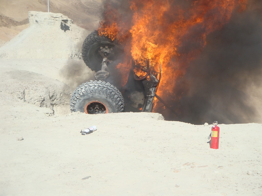

This is probably the best article I have ever read on the subject. My favorite quote in the article " But I have a 5lb extinguisher and my buddies do too. Whoooopty friggen dooooo! I have seen too many fires where a hand held unit did not do squat. What do you see scattered around this picture with a rig still on fire?" A picture is worth a thousand words.

I think chuys article sums it up best....but for sure have at least a 10 pounder steel hardware style
like a badger or buckeye.. Abc type at close reach and easily accessible anywhere you go at all times
You might save a life. And pretty much if you cant knock a fire down with that RUN AWAY.
Remember you wanna be able to put out class A ( your seats ,dash, hoses ,etc) Class B, (liquids) and Class C (electrical)
