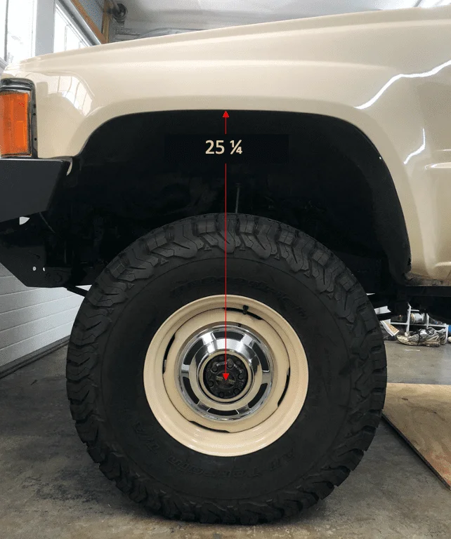

Measurement in the front with the same bumper and winch (pretty much) is right under 27" from the center of the wheel.
Really? I thought my springs were too tall at 25 1/4"... are we measuring from/to different points?
(ARB, no winch)
(ARB, no winch)
Nope! Same exact spot as you. BUT @pappy I do have a 1" body lift, so maybe take that into account? I should be right around 26 then.
That helps, but I was hoping to knock off 2". I had a chat with the folks at Cruiser Outfitters. I told them what I had, and what I wanted to do. They recommended the heavies.

Jon, have you tried removing at least the bottom leaf of your all pro springs?
I haven't. I'm not sure one leaf would drop the truck 2".
Another option is to run YJ Wrangler SOA leaf springs. They Have a reverse eye, which drops the height by 1.5".
Mine were built by Deaver, which are arched to get the right height for 35's. From the centerline of the axle to the bottom of the fender is 26." If I had a thinner spring pack (like a Rubicon Express Pack), I think it would be between 24.5 and 25" tall.
Also note: my truck has a 1" Marlin Drop hanger and 5.5" long shackles on a IFS Frame. If this were a solid axle frame, the these springs would be 2-3" lower on that truck.
