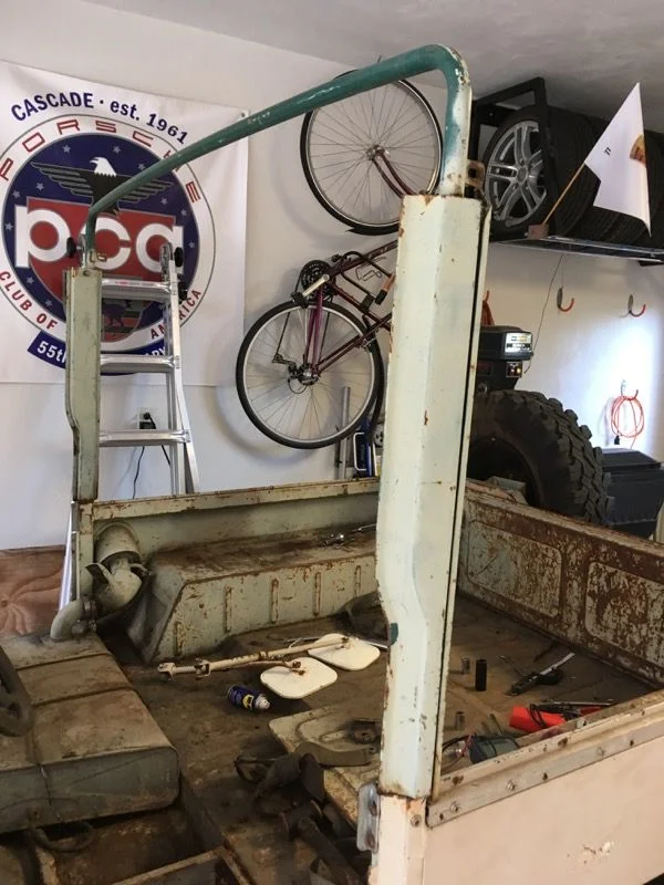

Still assessing what I have, so that I can decide what I need to find. Looking at the top and doors now.

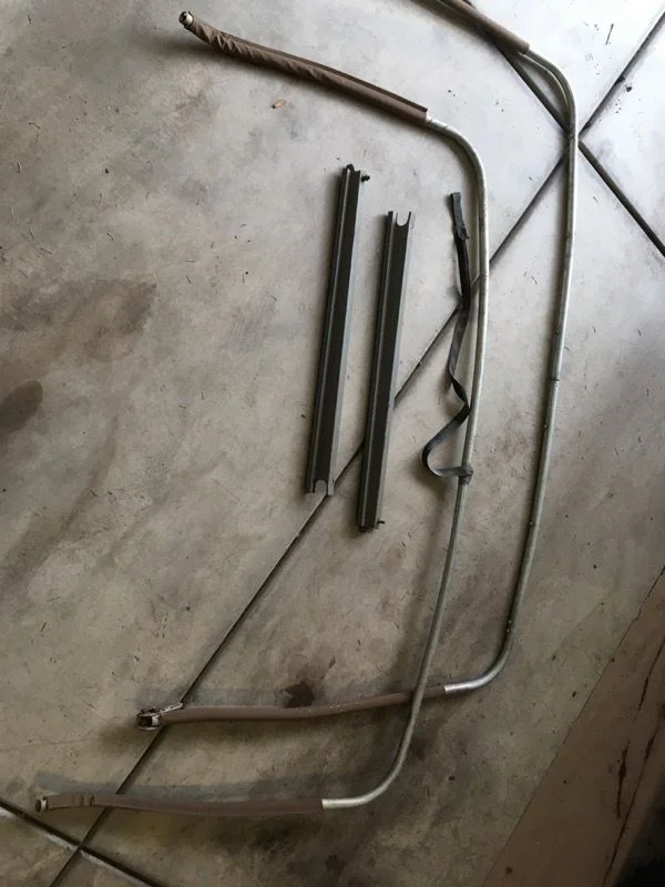

I could use some help on this one. I fear that most of what I have is not original, some of it may not even be for a Land Cruiser at all.
I'm not even going to look at the top itself yet. It is black vinyl, probably a Bestop, possibly for a later truck.

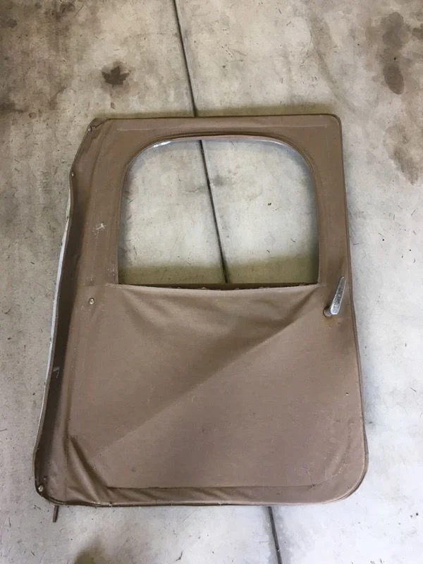

I have two pair of doors — one pair is tan canvas over a wire frame, the others are obviously much later metal framed doors. The later doors were originally green. I do not have correct hinges for the later doors.
But I don't think I have the correct top frame bits for a '64 either. The B post fits OK, also green in color originally, so probably matches the later doors. There are a pair of what appear to be top bars to bridge between the B post and the windshield, bit they don't look to mate up to my early windshield either.
I was given two additional bows, but I don't think they fit any Land Cruisers. They are wider than the tub, no way to attach them at all. I'm leaning toward them being for a boat or something.
Here's some pictures, those of you with early FSTs please let me know if any of this is correct. Would be great if you could direct me to pictures of the proper top frame for a '64 FST, since I suspect I'm going to need to be hunting that down.

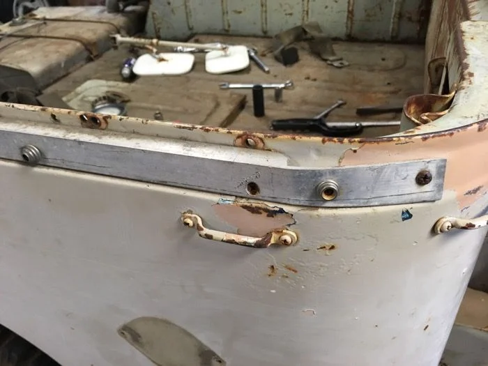

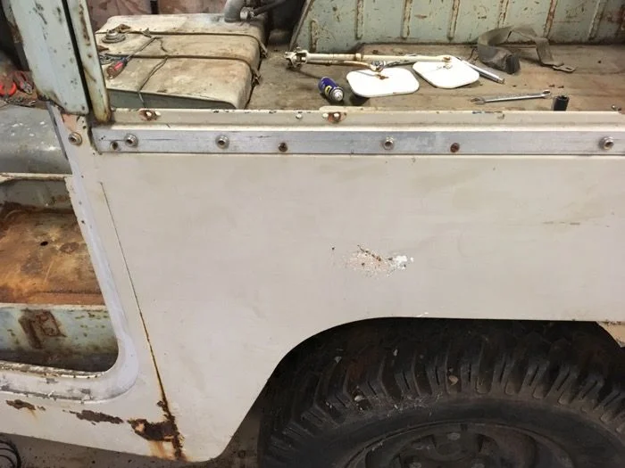

Addendum — Both sides of my tub have an added aluminum rail with snaps for the top. I'm assuming this was added to work with some non-standard top?

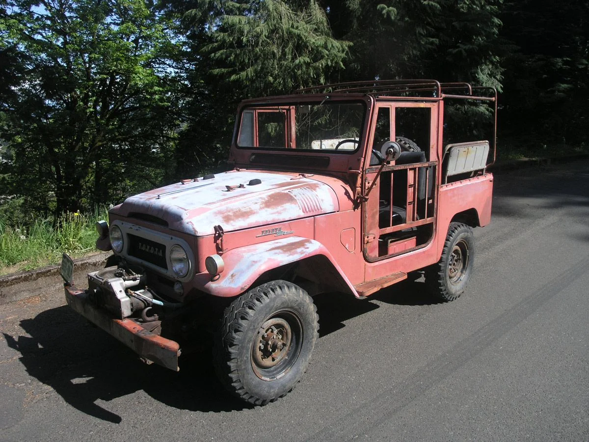

Destin's chronicle of his 1964 fst is an epic resource. Have a look: 1964? 1965? fj40 FST and destins 1964 fj40 FST restore thread Might be useful in determining what parts are correct, and incorrect on yours. Couple of Destin's photos for quick reference:

Well, with the info from the separate top frame thread I had posted in the 40 section, and then the info I’ve gleaned so far from the reference threads posted above by @Old Red , I’m getting a pretty good feel for what I have.
And the answer is disappointing, but not terribly surprising. Looks like the B-post, door top rails and doors are usable, even if not original to this particular truck. The rest is worthless to me. I suspect the soft wire frame doors have no particular value to anyone. The black vinyl top itself might be usable for someone, but I’m going to need to wait for warm weather to be able to lay it out and see what it really fits before trying to find it a new home.
The larger part for me in the future is to acquire the parts I am still missing. I will need to do this prior to pulling the tub for paint, as I probably need to have the top I intend to use in the end first, so I can figure out which of the literally dozens of holes in this rig can be welded up.
As for the parts I know are missing now, looks like I need the 2 brackets where the door top rails attach to the windshield frame, the door hinge parts that attach to the tub, door checks, and all of the frame from the B-posts back.

rest of the rear bows can be bought from replica places, but will be expensive, or bent up, but finding someone with the correct radii die is an issue...for that reason, i'd recommend a replica set, plus they will come with the brackets in the back if yours are missing
last i checked turnbuckles for oem tops were still available at toyota, but that's been a few years. the pieces on the door frames are aftermarket door strikers for the tan doors.

Re: the other bows, I thought that as well, but those bows are way to wide for a FJxx. Maybe it’s the other way ‘round - the wire frame doors are actually for whatever vehicle the other bows fit?

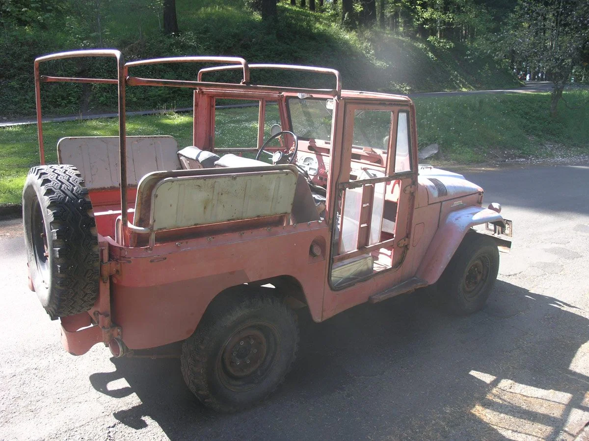

weird. all looks like what would have been on a 40. bows maybe bronco or early blazer...jeeps weren't wider, so def not that. dont have pics of the doors on my old 68, but they looked the same as the brown doors (just in black) with the high side mount and snaps.
the bows look like the bows that were on annie. pic below
Yeah, somewhat baffling. I took another look at the tan wire frame doors, they were obviously designed for a ‘64-up LC. The shape and such is too correct, and would actually fit pretty well if the canvas hadn’t shrunk so badly. No way to stretch it enough to get all the snaps at the front snapped.
But the other bows aren’t even close. At least 6” wider than the truck.

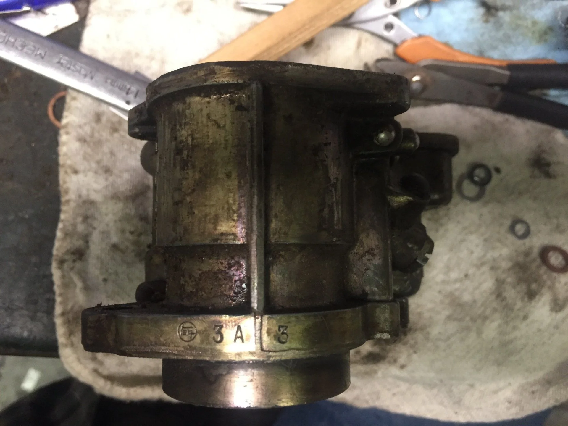

Snapped a close up pic; January ‘63 build date on the carb.
@65swb45 - Thanks for that, Mark. Much earlier than I would have guessed. I’m going to need to hunt around for date codes on other parts now, and see how they compare to the carb date.
Still appears that mine is a ‘64 model despite a possible really early ‘63 build. The obvious stuff is all ‘64 - door openings, TOYOTA sticker on the rear sill, offset rear diff and 4” (overall) brake lights. (Or rather, I have the factory brackets for the 4” lights, not for the small 3” used through ‘63.)
