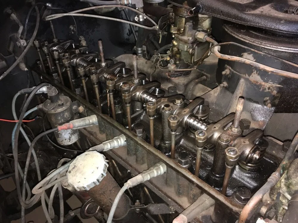

Looked inside the gas tank today, stunned because it is pristine. Pulled the valve cover, beautiful. I'm really pleased so far.

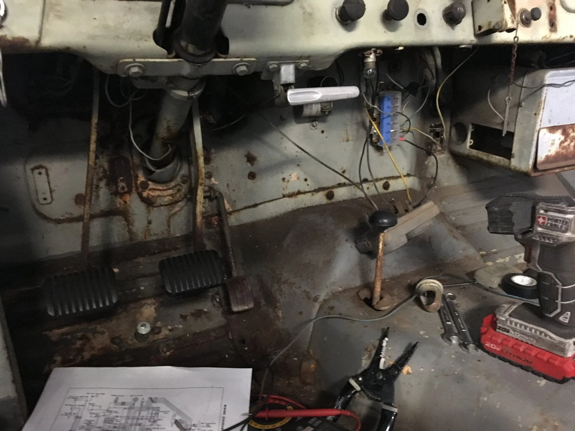

After removing all the add-ons from the dash, I count 12 holes so far that will need to be welded up. Ugh!

Put in a battery today, cranked it no load (without the plugs) to check for oil pressure and such. All good there, the idiot light goes out almost immediately. Also checked for spark while cranking, not so good there. Looks like a bad distributor cap for sure, plugs wires are very questionable, plugs look so-so. Time for a bit of ignition love.
Fuel delivery system looks pretty good. Hoses not too old, tank is very clean, filter looks ok, etc. Looks to be good enough as is for the initial stage of the project. Will plan to put a couple gallons in after the ignition work and see what I get. I’m pretty optimistic about the general engine condition at this point.
Wiring, however, is cr@p. It boggles my mind that someone could hock up the wiring in an early FJ this badly. These rigs are so simple. The changes, additions and repairs to the wiring look like they were done by Cro-Magnon man. Added to the “work” done in the past, the wires are old, brittle and the connectors are pretty shabby. And then add in that many were not covered or masked when the rig was painted in the past, so trying to figure out what color they are under the paint is a job.
All of which means I might want/need to replace all of it. Past experience is that new wiring is a huge step toward reliability in the end. We’ve all heard the normal jokes about English electrical systems, but when I restored a ‘67 MGB years back with a new harness, I daily drove the car for 4 years with zero failures. Good wiring is a key bit.

I pulled the fuel sender and looked in. There is still a lot that you can’t see in all the corners and such, but you can see enough to give a decent idea.
Hey thanks. That is easy, and probably good enough to make a determination if the tank is usable. Plus I need to do that to check the ohms of the sender anyhow.

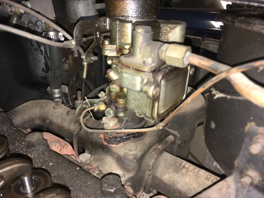

As for recent progress, after a thorough ignition tuneup, I now have good spark in all 6 cylinders while cranking. I will begin tracing through the fuel delivery later today, but I suspect I will need a new fuel pump and filter at least, and perhaps a rebuild kit for the old carb. Most of the carb gaskets look pretty nasty.
Good job on the tune up. These things are dirt simple to get and keep running. For odd ball parts the best source is Marks Off Road. He can also rebuild your carb, as can FJ40Jim here on MUD. They both know these carbs inside and out, meaning if anyone has installed incorrect parts, they will catch it and fix it.

Nothing picture-worthy recently. I’ve been in touch with Mark ( @65swb45 ) and am planning to ship my carb to him soon. So no further attempts at making it run until the carb comes back.
Still spending some time trying to undo all the electrical rape inflicted by the original owner. I’ve got some lights working now, more yet to come.

Disassembly and assessment still in progress. Shipped the carb to @65swb45 yesterday for rebuild. Pulled the old Con-Ferr roll bar today. (An hour and a half cutting nasty, rusty bolts to get it off.) Tracing through the wiring, removing the add on stuff to return to a stock baseline.

Ok, maybe the wiring in this truck isn’t as bad as I thought.
Since the original 5 circuit fuse box was a rusty, corroded mess I bought a new 6 circuit replacement. As I started going through the changeover, I found that for the most part the original wiring is intact and not all that bad. The rat’s nest of wires was pretty much all add-ons from the original owner. A whole lot of it was for accessories that no longer exist. When he removed some gadget, he generally just snipped off wires at either end and left the wires hanging. As I keep going forward with removing the unused stuff, what’s left seems mostly ok.
After some time this afternoon, I now have most of the lights working, as well as the wipers. And it is a lot cleaner looking under the dash.
