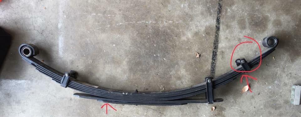

This is mine with the same OME spring packs and no weight in the back. Springs have less than a years worth of driving on them.
I love the way your truck is sitting! I've been researching these leaf springs for a couple months now and just worried about ride being to stiff and most importantly too much lift. I am currently using the zuk mod as a band aid but my center of axle to fender is 22". I would like to stay the same height and it seems yours is.
I just want to clarify what you are using in the back, it is a OME CS009R modified pack right? Did you remove the overload and an additional spring?
I’ll check on the model number on the springs. As far as I know, they are as shipped by OME.

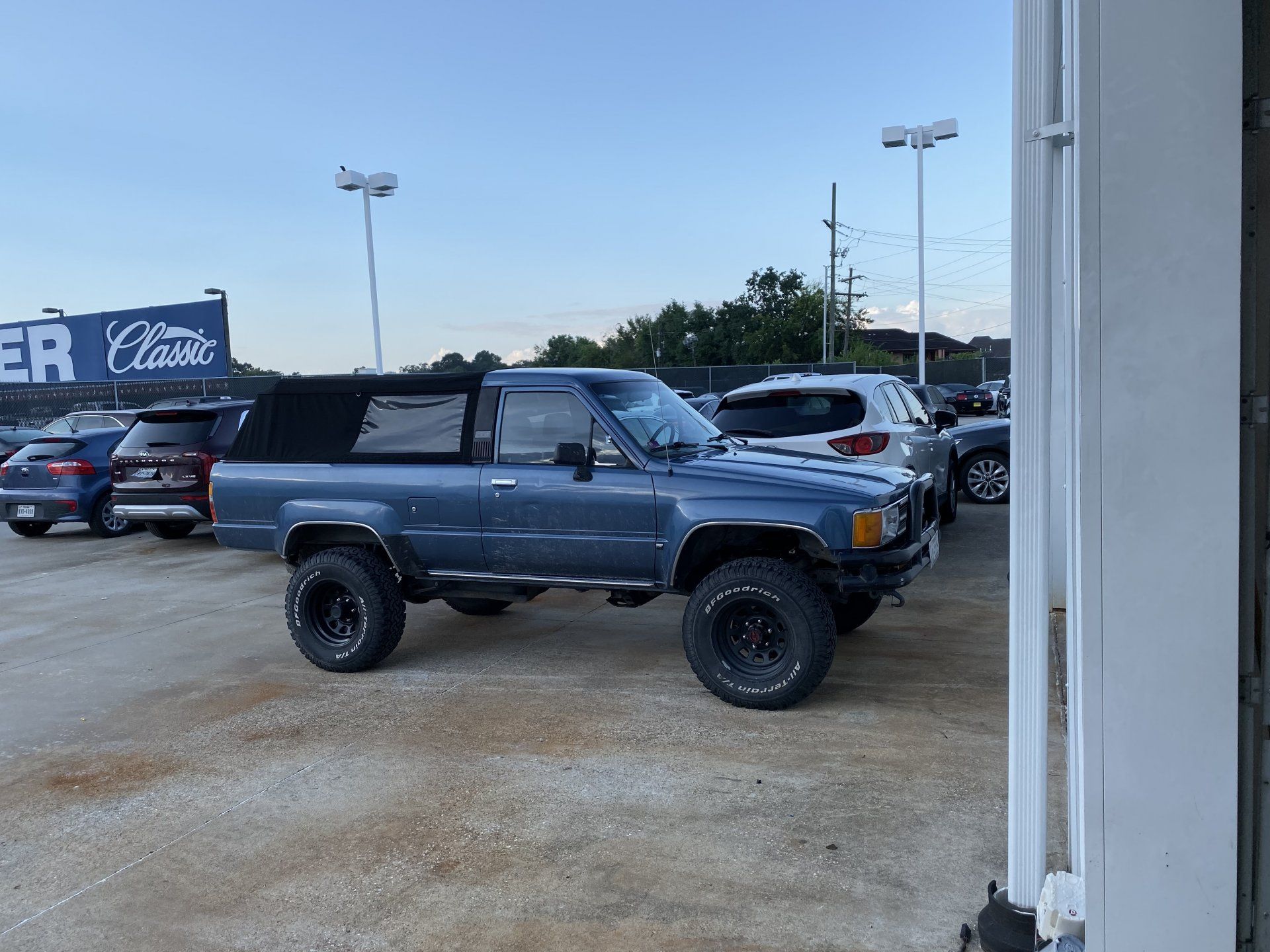

I took these out, sits level with BJ spacers and rides a hell of a lot better, but still stiff as hell, would probably improve if I had a rear bumper.
Do you have any pics or measurements of your truck with this set up? Thanks!

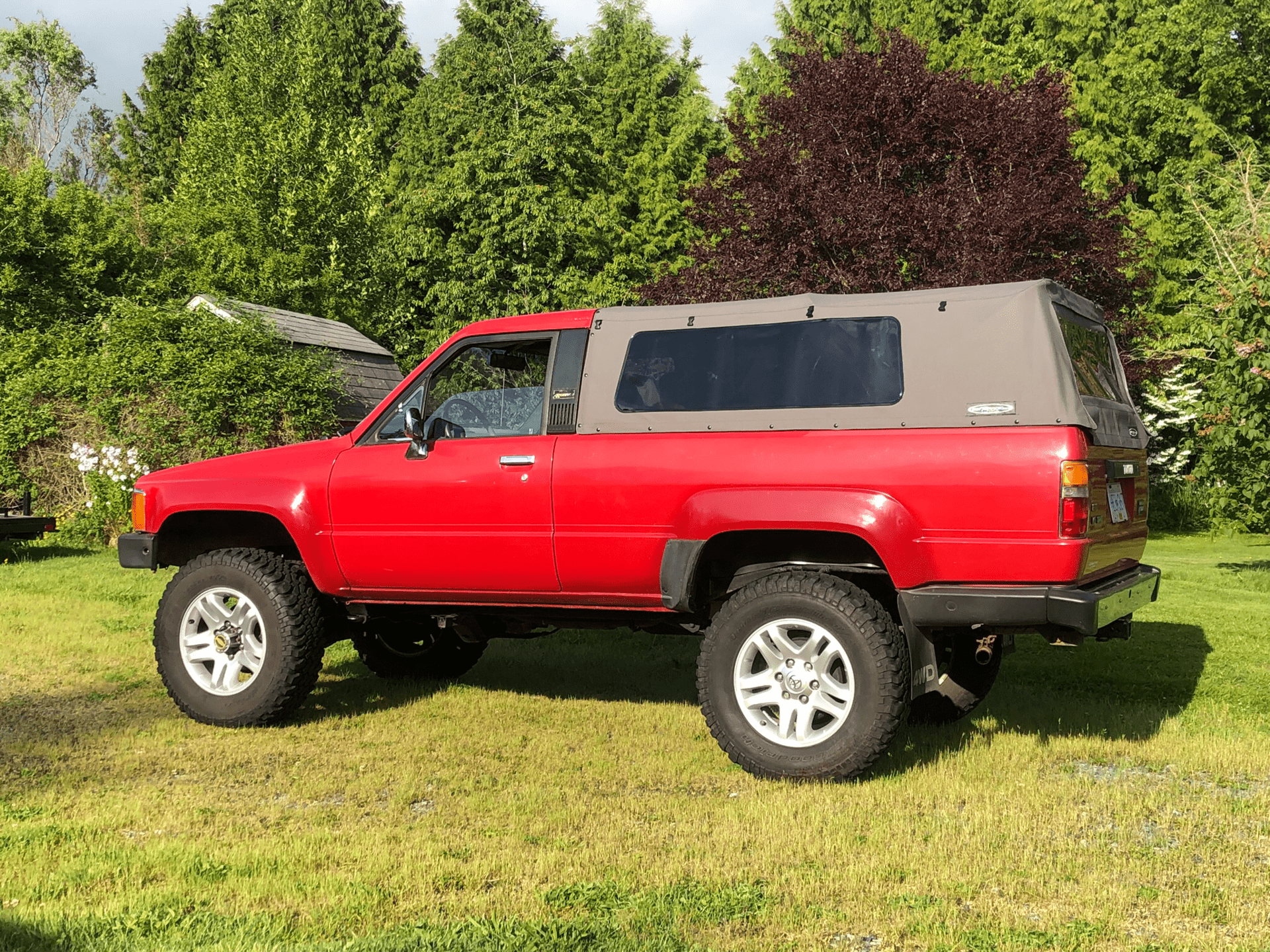

These rear leafs provide way more lift than advertised for sure ,this is before I leveled out the front with a Bj spacer ,these leafs had been on the runner a couple of years and never lost height .
This is with the KTT that I dont have anymore, with the hard top on I have 35 1/4 inches from the ground with 31s and 6in to the top of the tire to the fender
Thanks, that’s a good looking truck you have there and it sits nice. This is the route I’m going to take. There just aren’t that many options out there. With a bumper, hard top and some gear I’m hoping mine won’t be too high.
