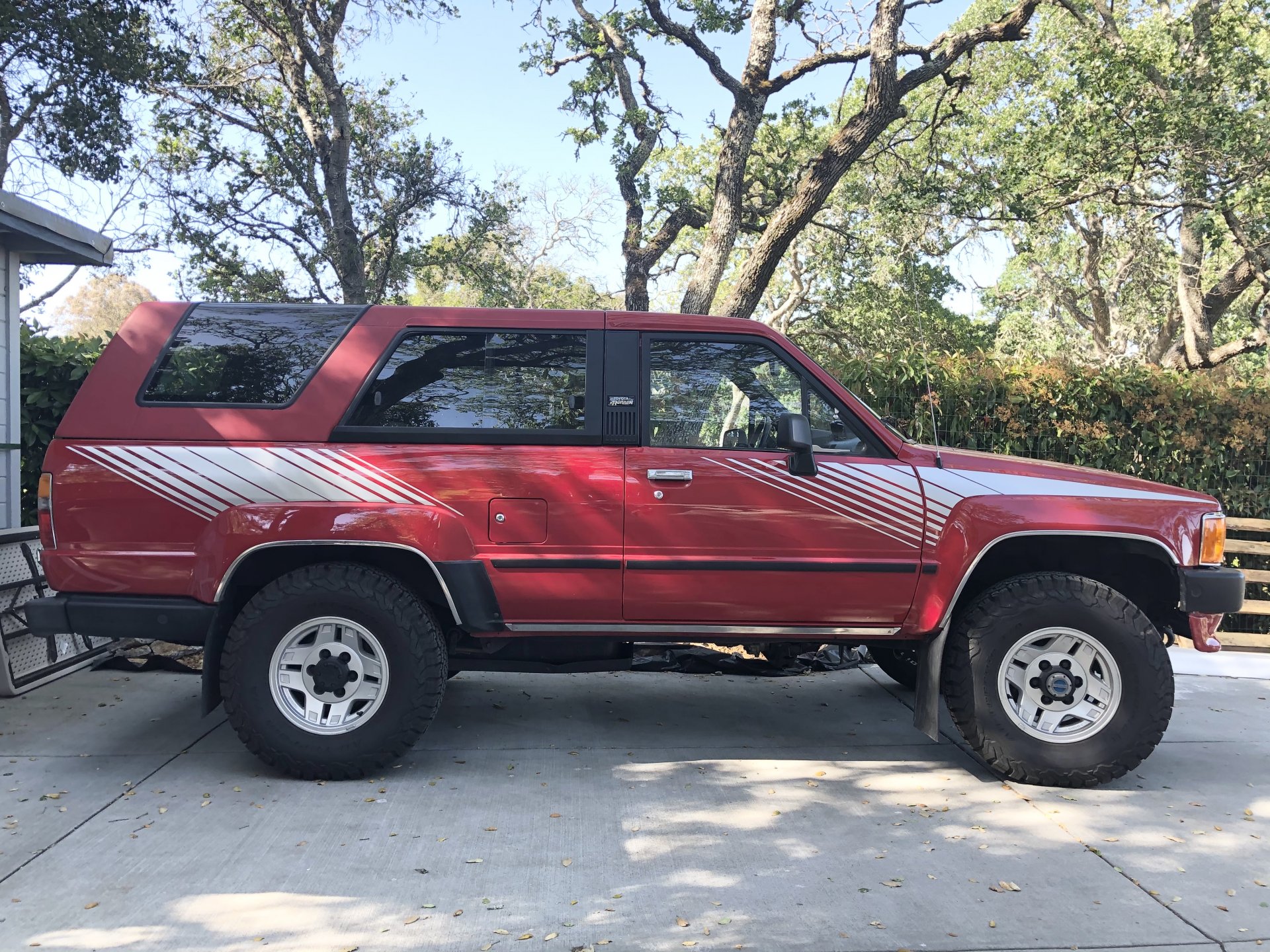

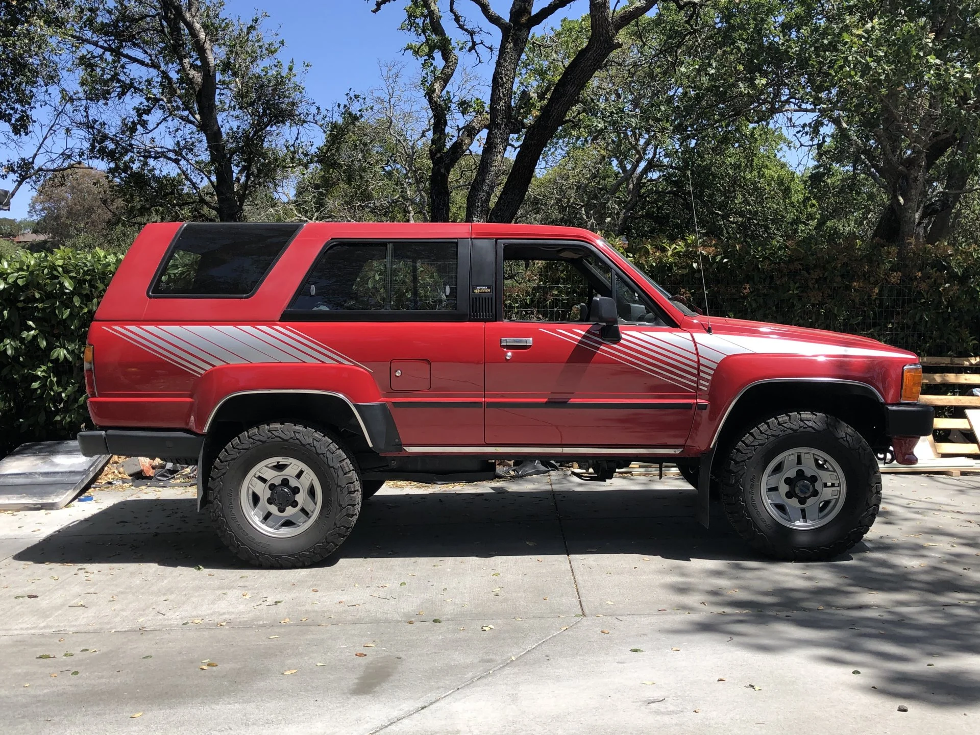

So I did what @1989toy4wd did with the leaf pack and got a similar result. I was at 3.5” from the top of my 31” tires to the fender before and 6” after. It sits a quarter to half inch higher on the passenger side where I put the + pack. Driver side got a - pack. We’ll see how it settles out.
I’m pretty happy with the result. It looks much more athletic and the ride is much better. Though it’s stiff, I have plenty of travel now and it doesn’t crash over small bumps. Doing some off roading this weekend and I’ll see how it handles.
Thanks for everyone’s help in this thread.
before:
after:
Looks great! Thanks for posting! What size are your tires?

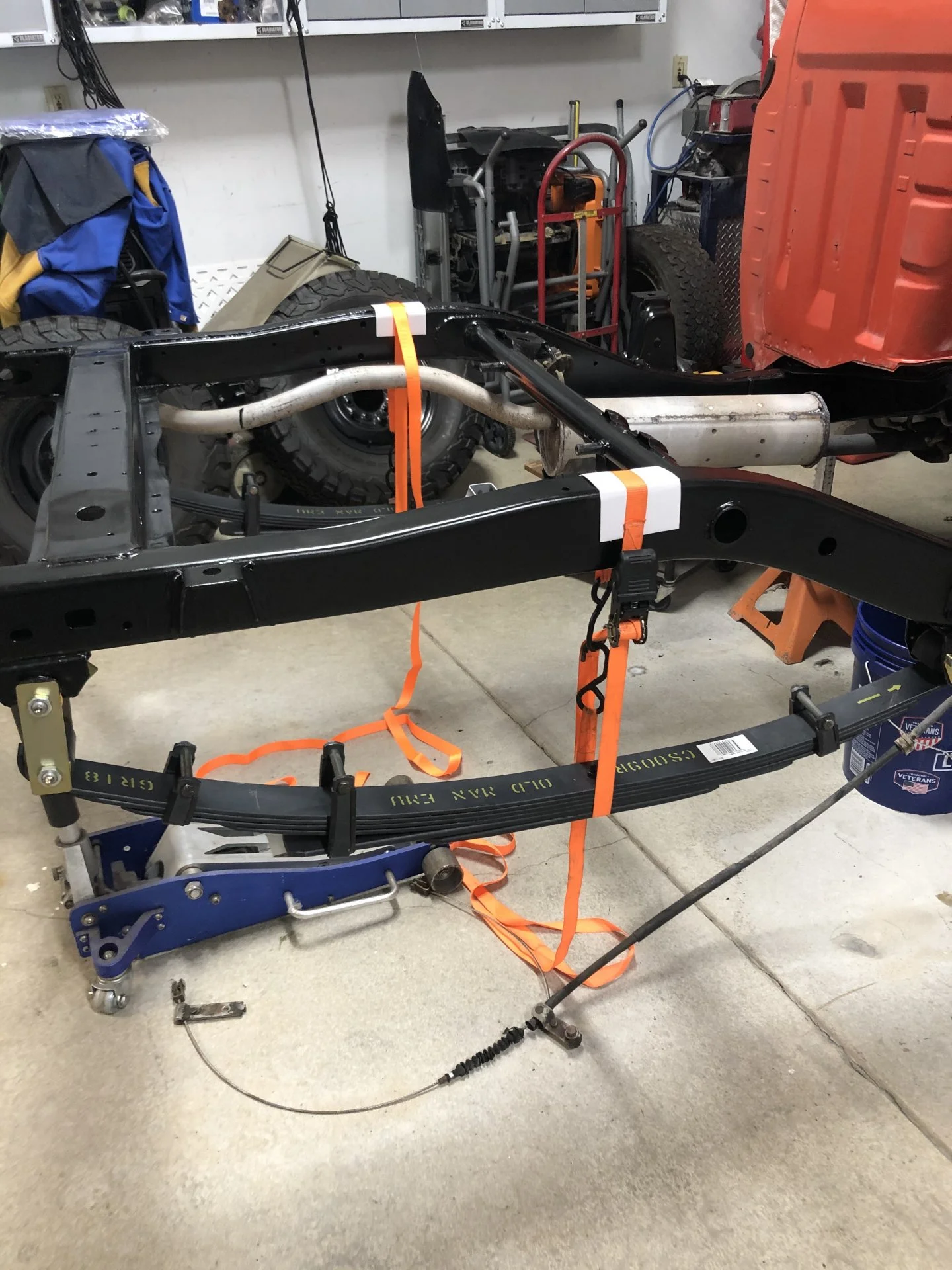

Hopefully this will help as I rebuild the rest of the truck. I did remove the 3rd leaf. Only time will tell.
