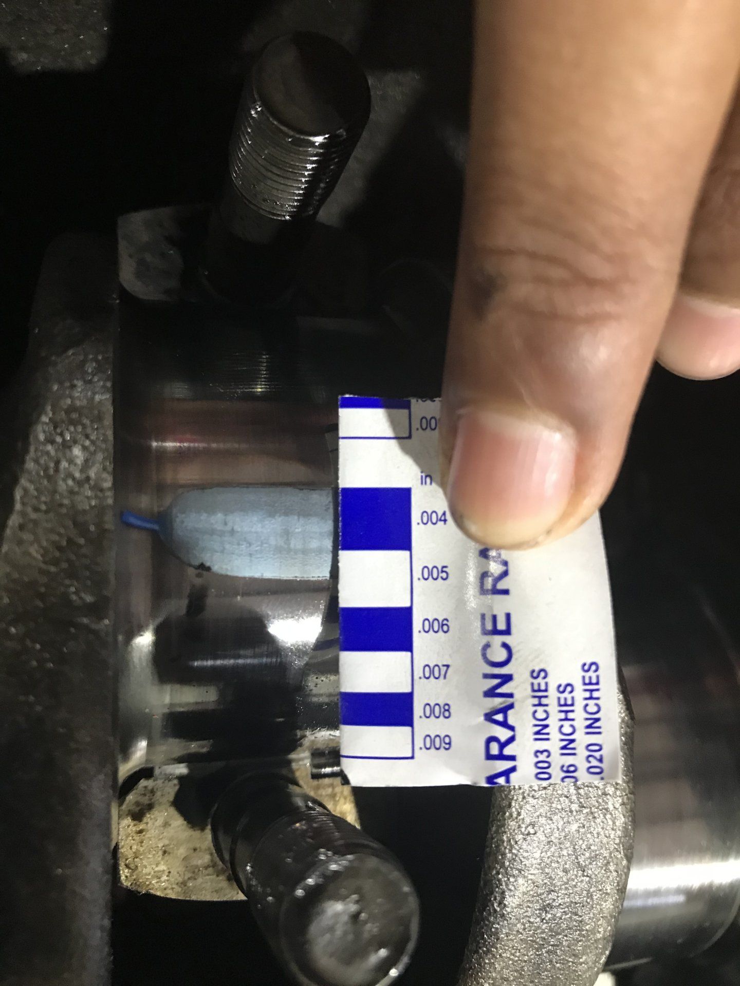

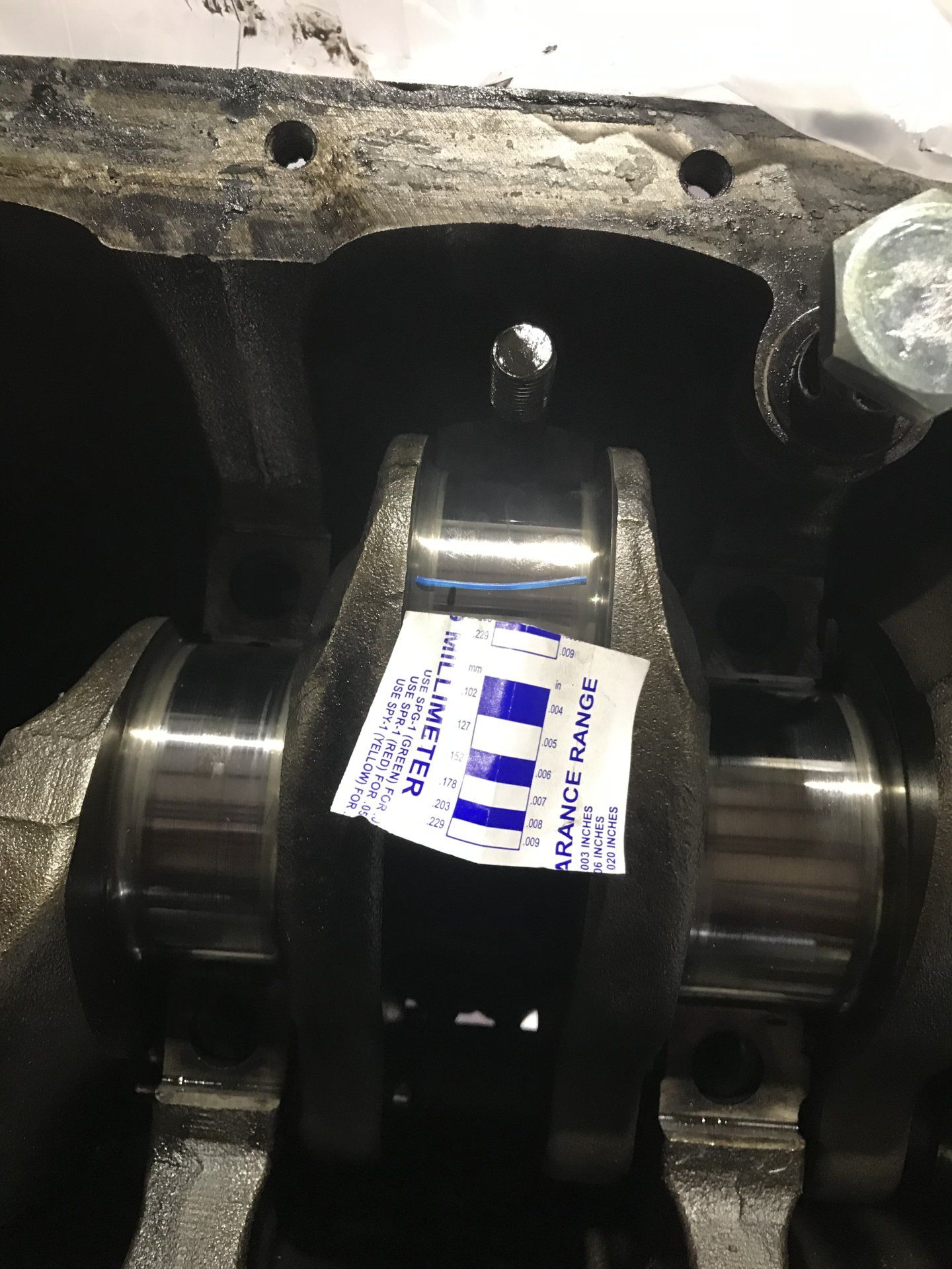

Thank you for posting this. Please excuse my ignorance,,my manual specs for crankshaft journal says .0012-.0028in yours is .005in range? confused?
You’re absolutely right just checked the FSM and I guess I thought I was measuring in millimeters instead of inches. Good thing I replaced races I guess 😅.

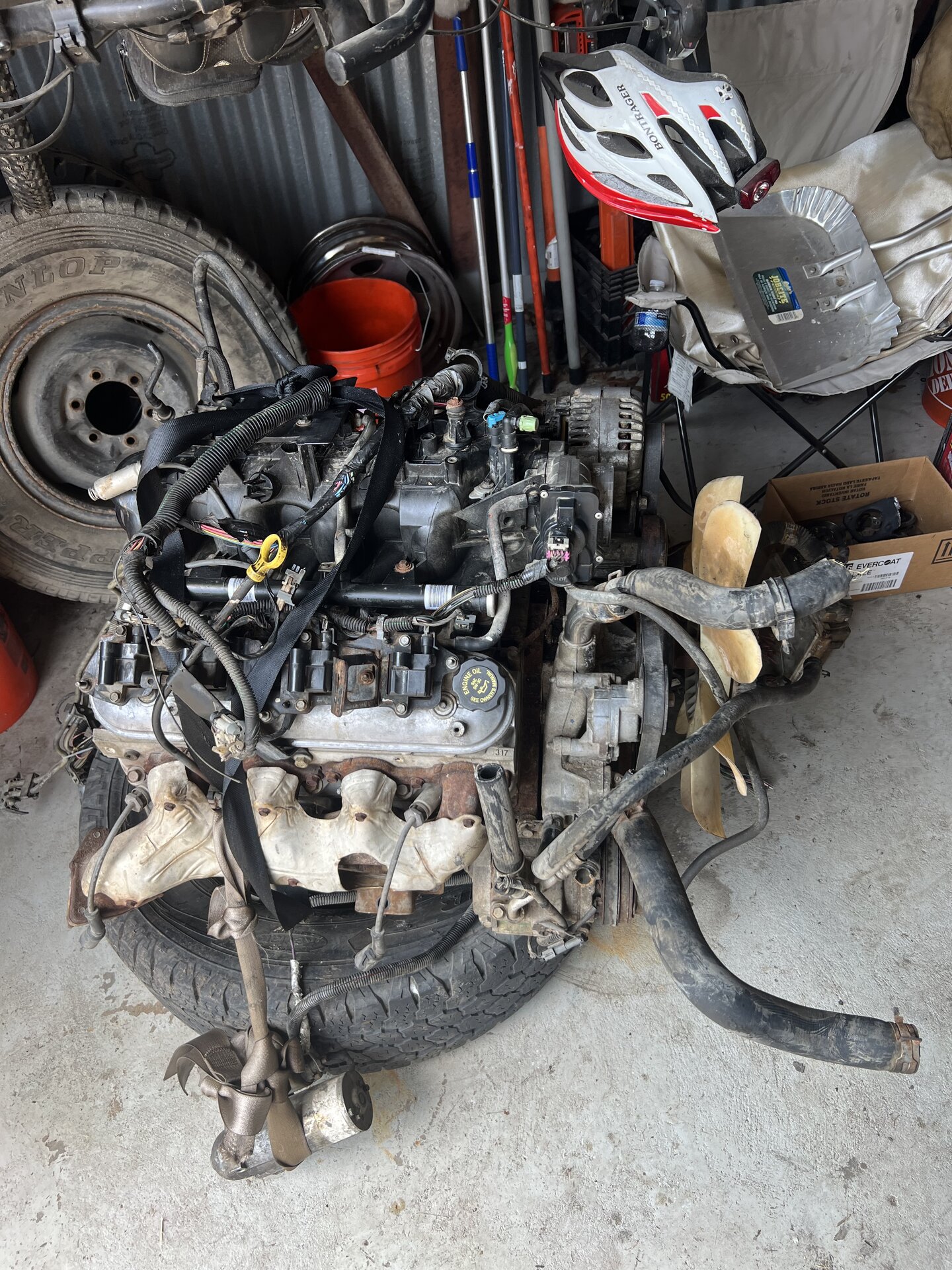

Been a minute since I’ve been on the thread… I ended up just bypassing the ground and hot wire with large gauge alligator clips for the purpose of “firing” it up. Sadly the 2H is out the window and going into a different rig. 6.0 going in ;).
good choice
I dig it K. You will still be able to go anywhere you want to go in Old Landy but without fear of being run over on the open road. Great choice man!
:clap::bounce::bounce:
More power, better fuel mileage and you can buy parts for it at Walmart at 3 in the morning. :hillbilly:
