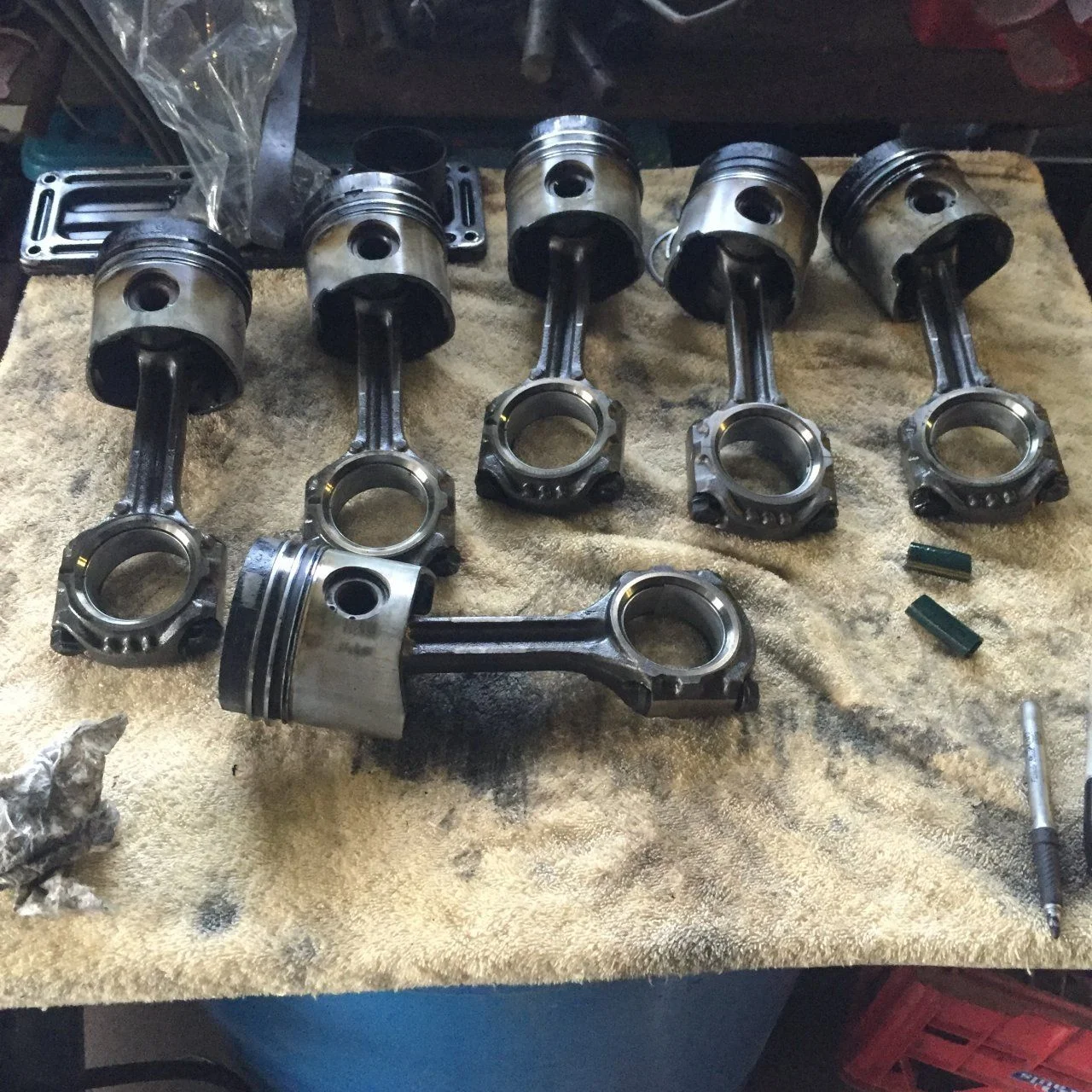

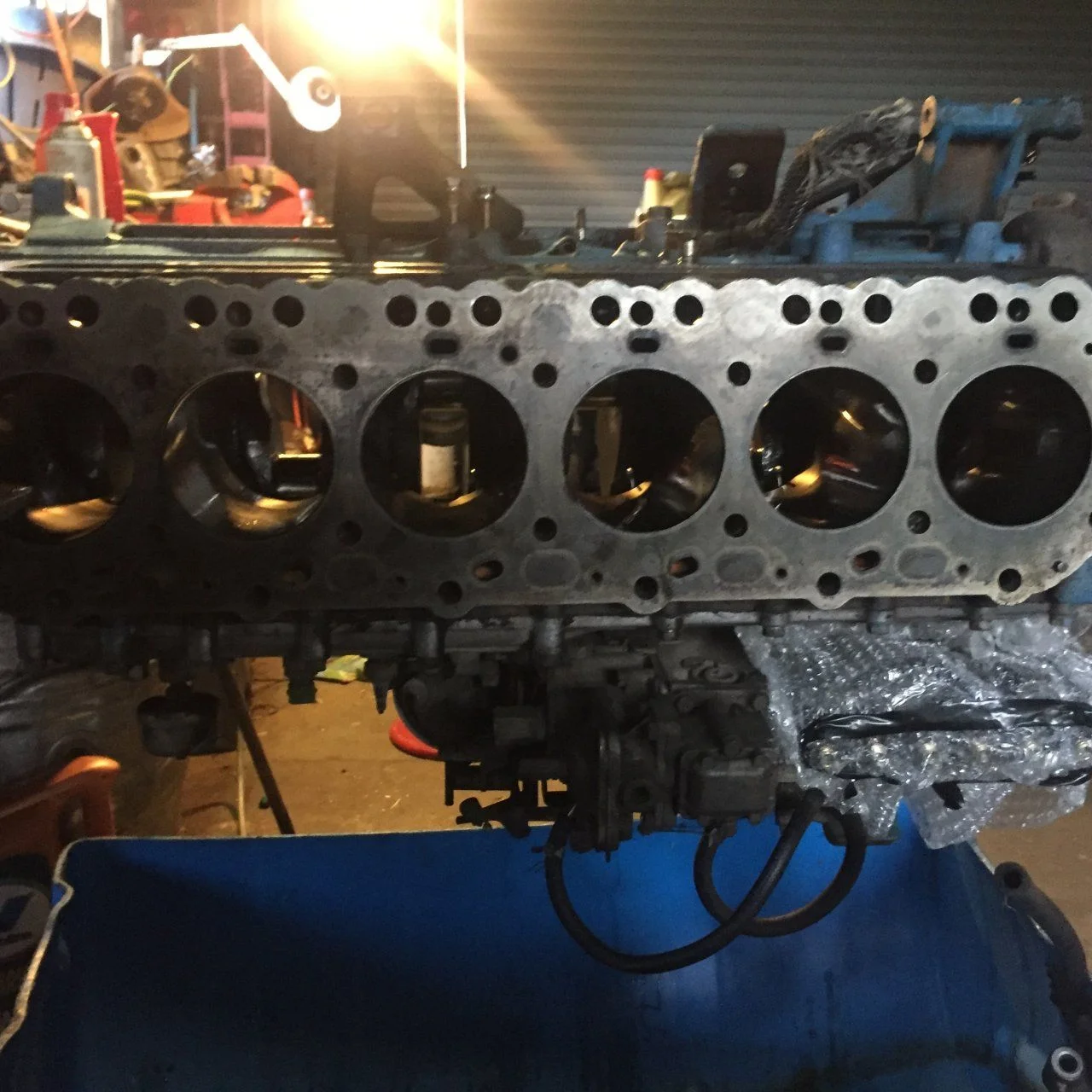

I pulled engine and lifted the head and found number five cylinder has slight scores probably caused from broken rings with number 3 looking good with good hatch.
I'm getting my engine stand sorted this week and hopefully be able to check the BEB bearings and decided what way I'm going full rebuild or a full kit with main bearings.
If you check the pics you can see how the pistons are out off the bore so will give them a good clean and spec + old head gasket thickness for squish on rebuild

How tight are the ring grooves? cylinder number 5 seems to go fairly often - in my 2H the rings were eating through the piston, which is a common problem- not sure if the 12HT shares that issue or not.
Yes, all the Toyota pistons did this, but you wont get Toyo replacements and all good aftermarket pistons have alfin inserts, a metal band around the top ring groove. You will be pointed towards Engine Australia for these but there are a few others, but getting info on them is difficult.
if this is your only problem, then order a set of first oversize, get a re-bore replace the big and small ends and away you go.

We pulled number 5 and found 1st ring broken and 2nd ring shattered quite surprising as I have never seen a ring like this.
The bore is looking very good with some slight scores and big ends are in great condition. We caught her at the right time before one of those rings pieces tried to exit.
The cross hatch is still visible in all cylinders so the guy I brought it from told me it had 280.000 so its close. Also all the pistons where 10 thou out off cylinders if anyone is interested.
