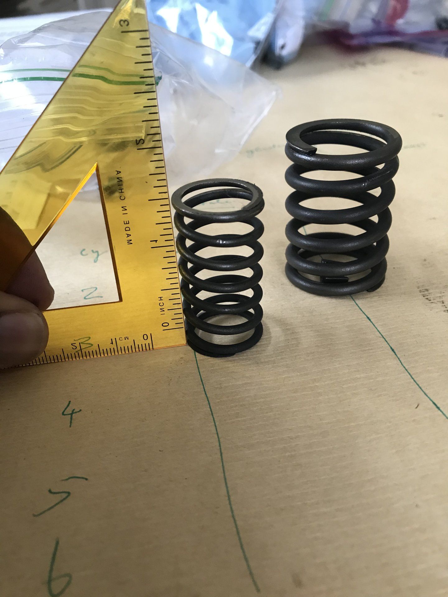

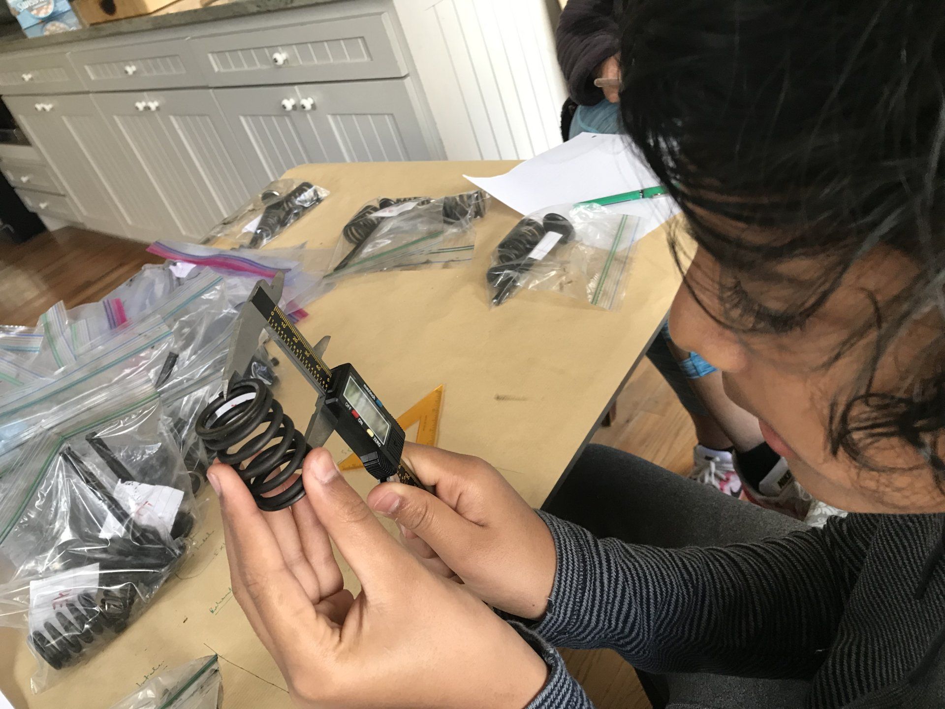

Today was a huge step in the engine rebuild process. As you know we have taken the head, valves, and valve springs home to measure and see if the parts are up to spec. We started off the day by measuring the squareness and height of all the springs.
