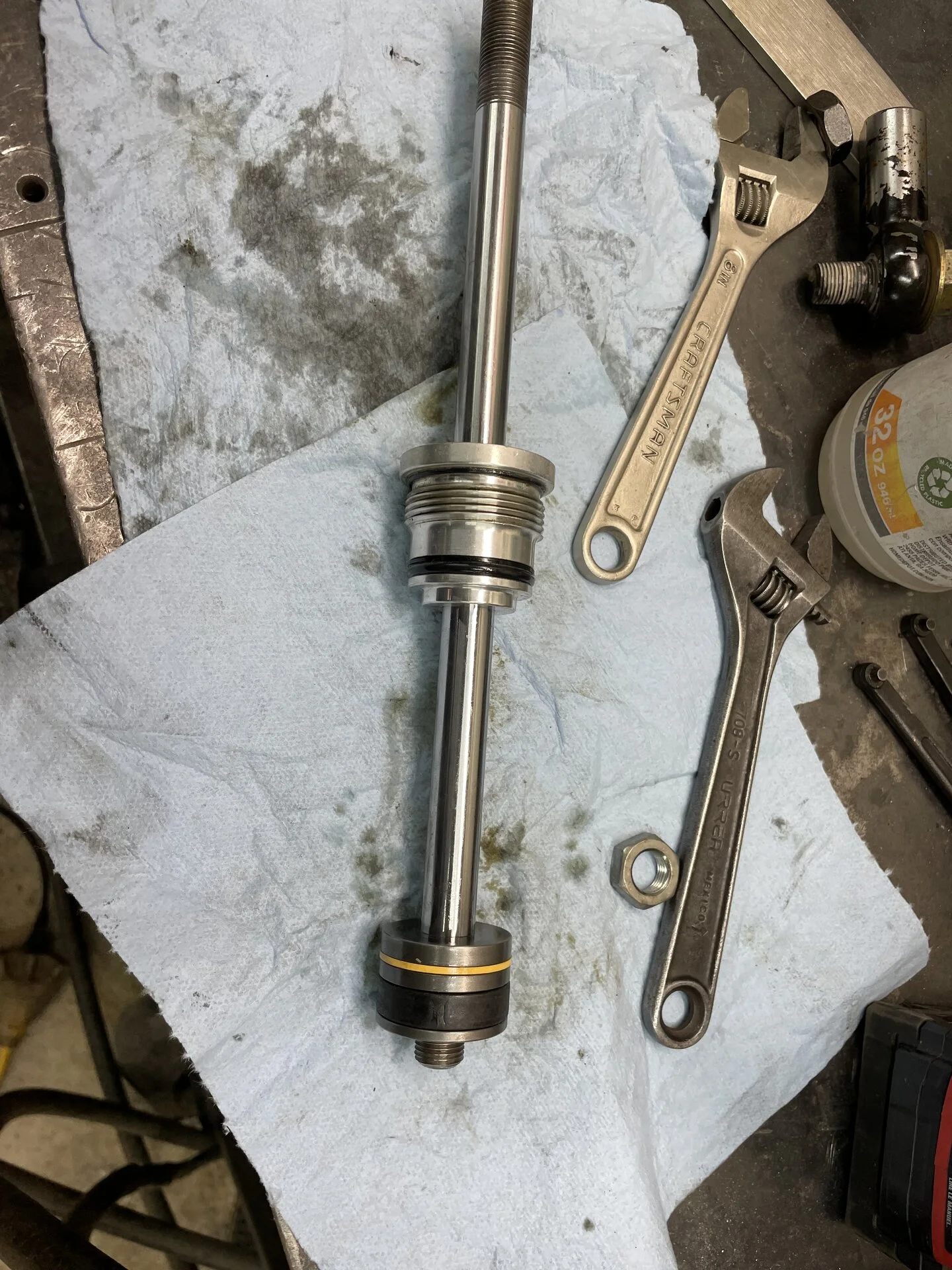

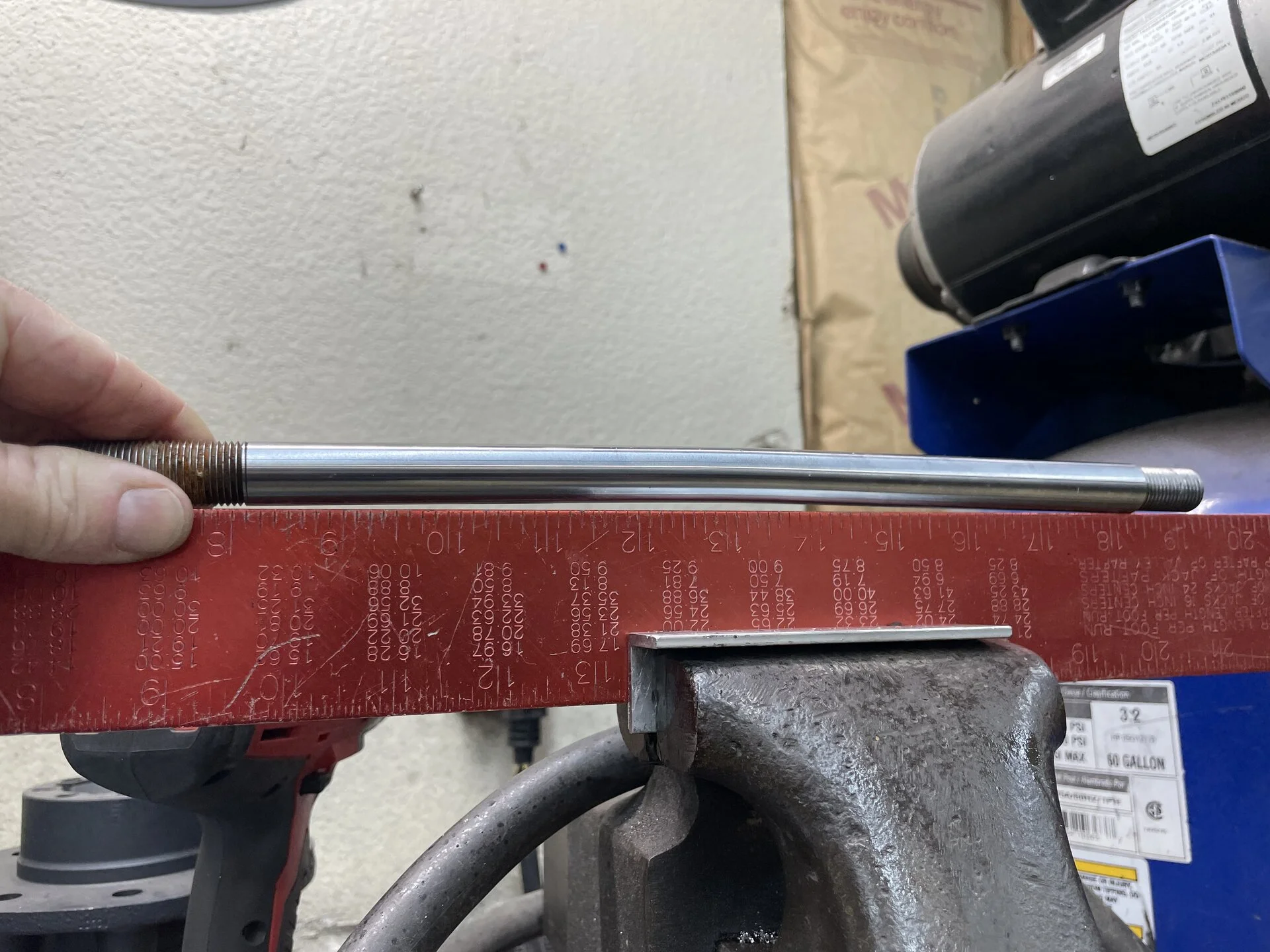

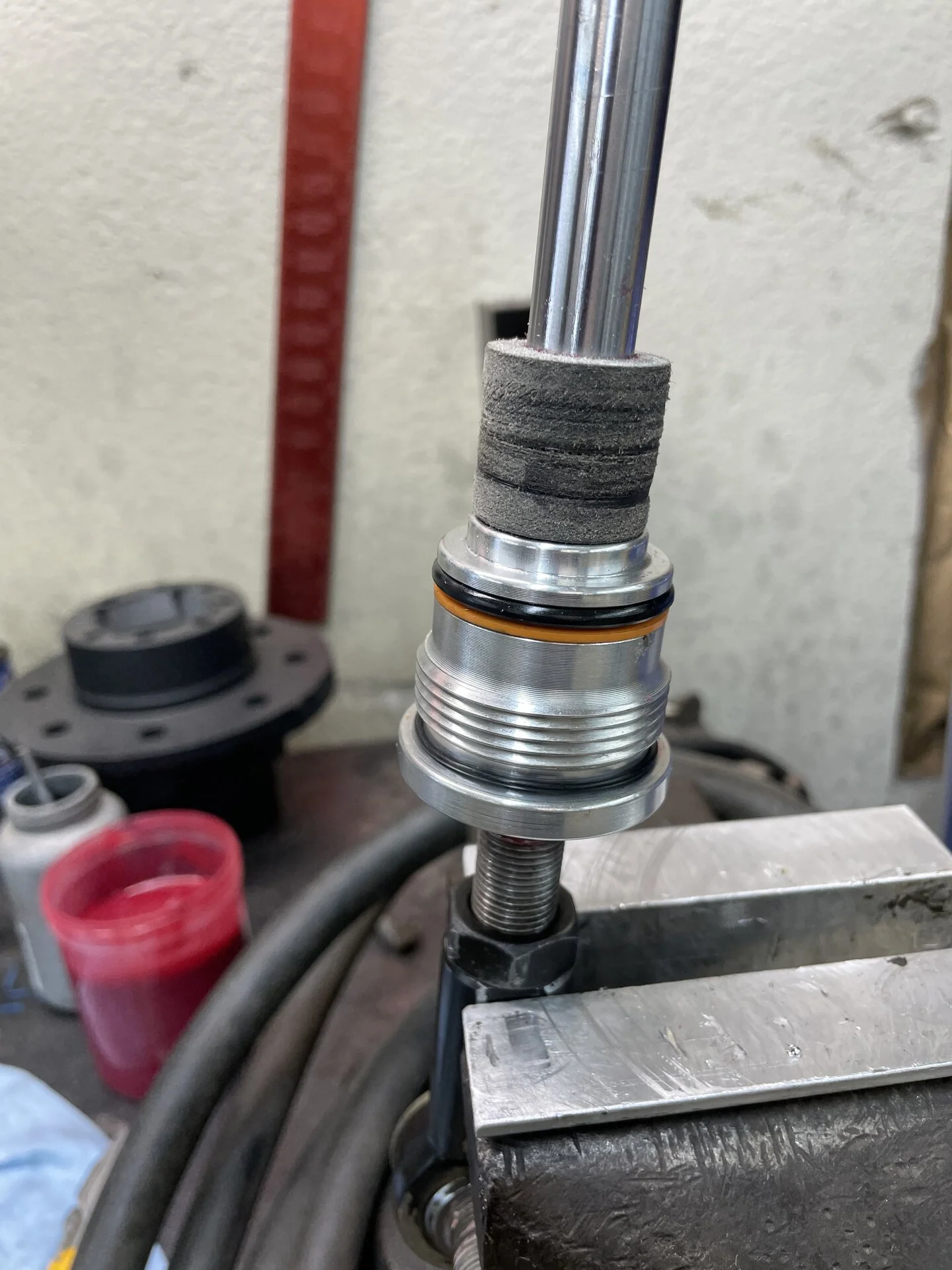

Ugh, the price you pay for hardcore wheeling. Took the PSC ram apart today in order to internally limit the stroke. Pretty obvious that the shaft is bent 🙄, 2nd one in a year

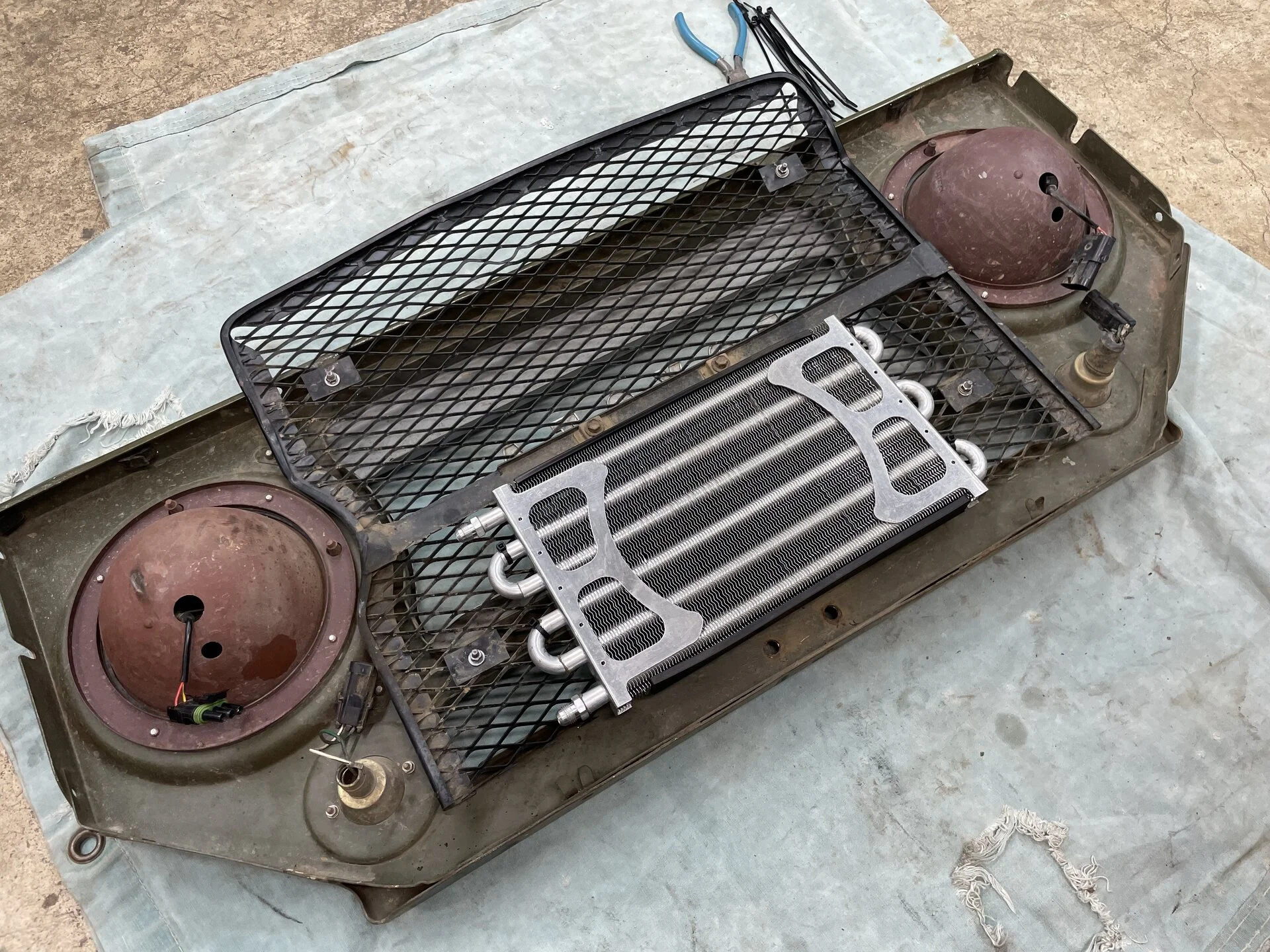

Cooler arrived tho and I got that installed and plumbed.

Limited the stroke of the PSC ram to 7” using some pieces of UHMW

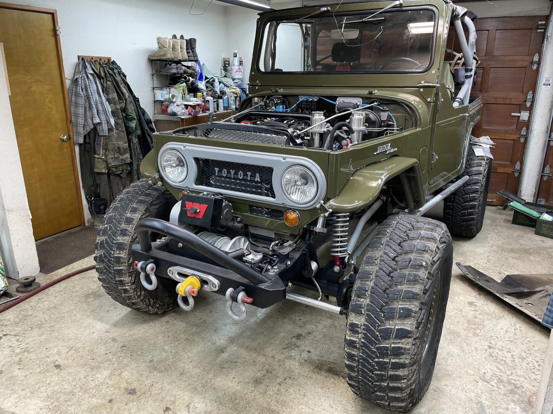

It drives 👍
I like how clean everything turned out.

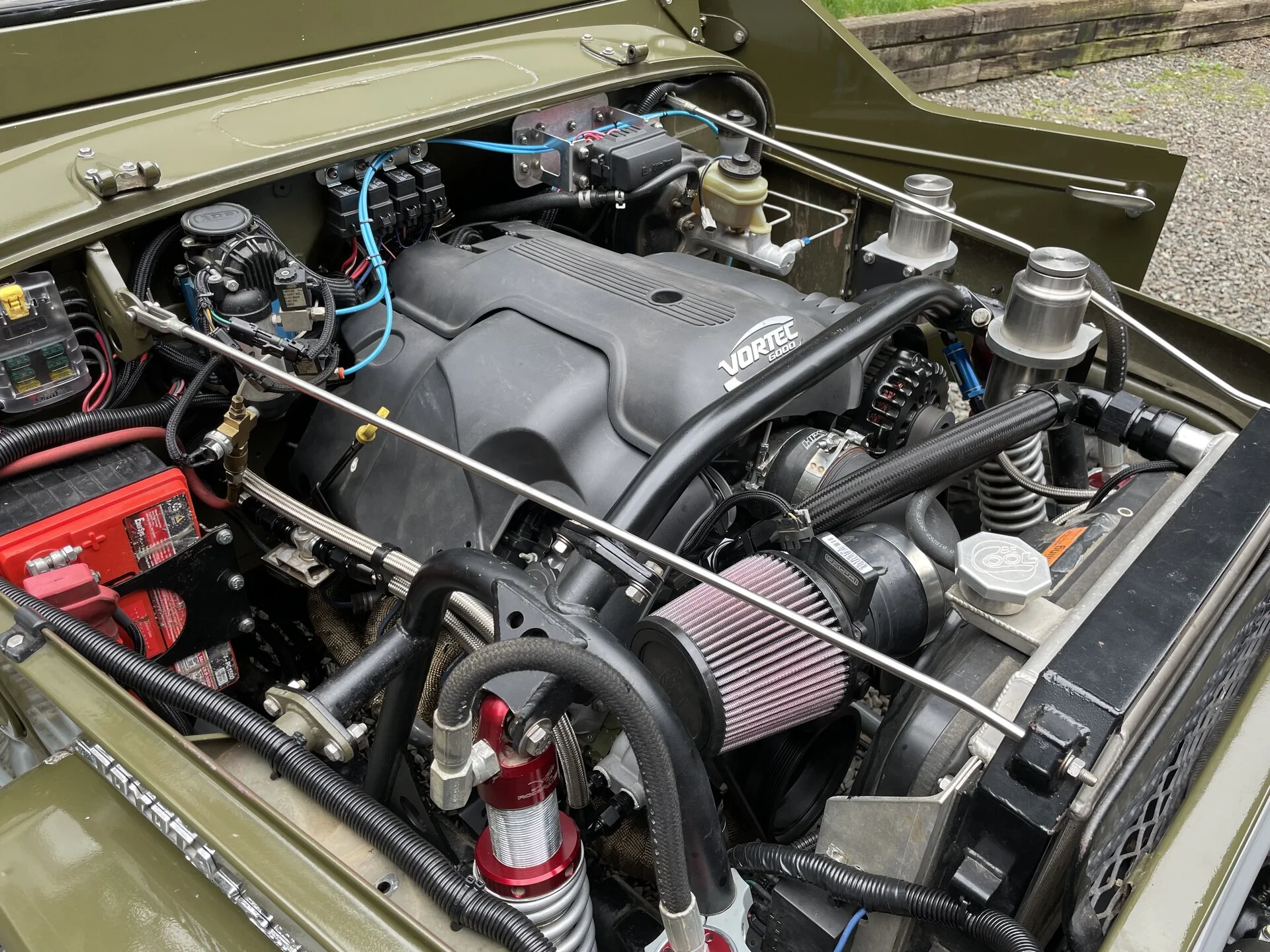

Where did you tie steam vent in ?
Steam vent, that got tied into the water pump actually since my older BeCool radiator didn’t have the appropriate fitting and I didn’t want to weld one in,

Here’s the steam line. Found an OEM 4 way piece from a 5.3 in a junkyard, both the front and rear of the heads are tied together
Used a 4AN compression fitting on the GM tube and ran it over to the water pump outlet. Threaded the water pump 1/8” NPT and called it good. Seems to work, doesn’t leak

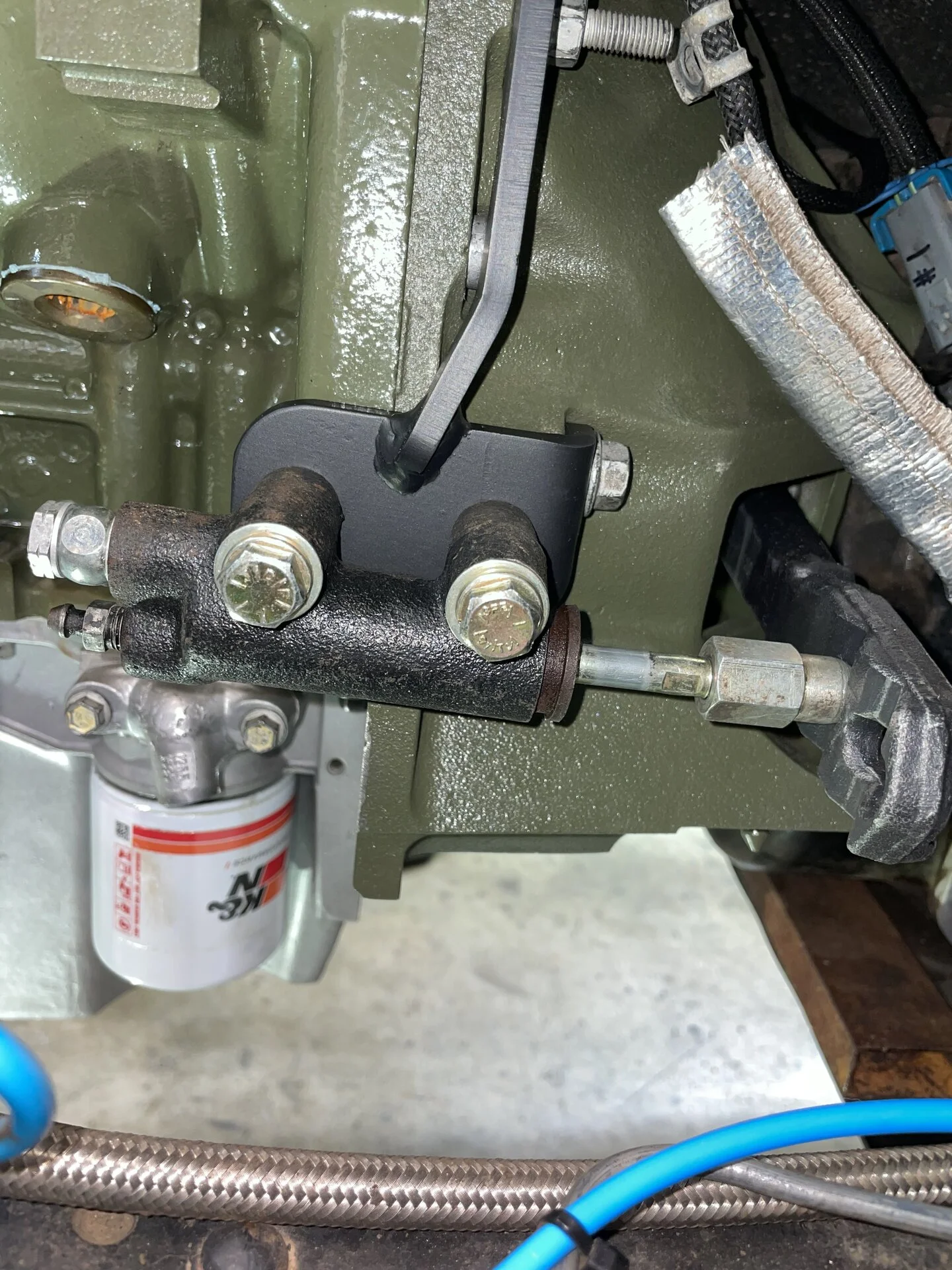

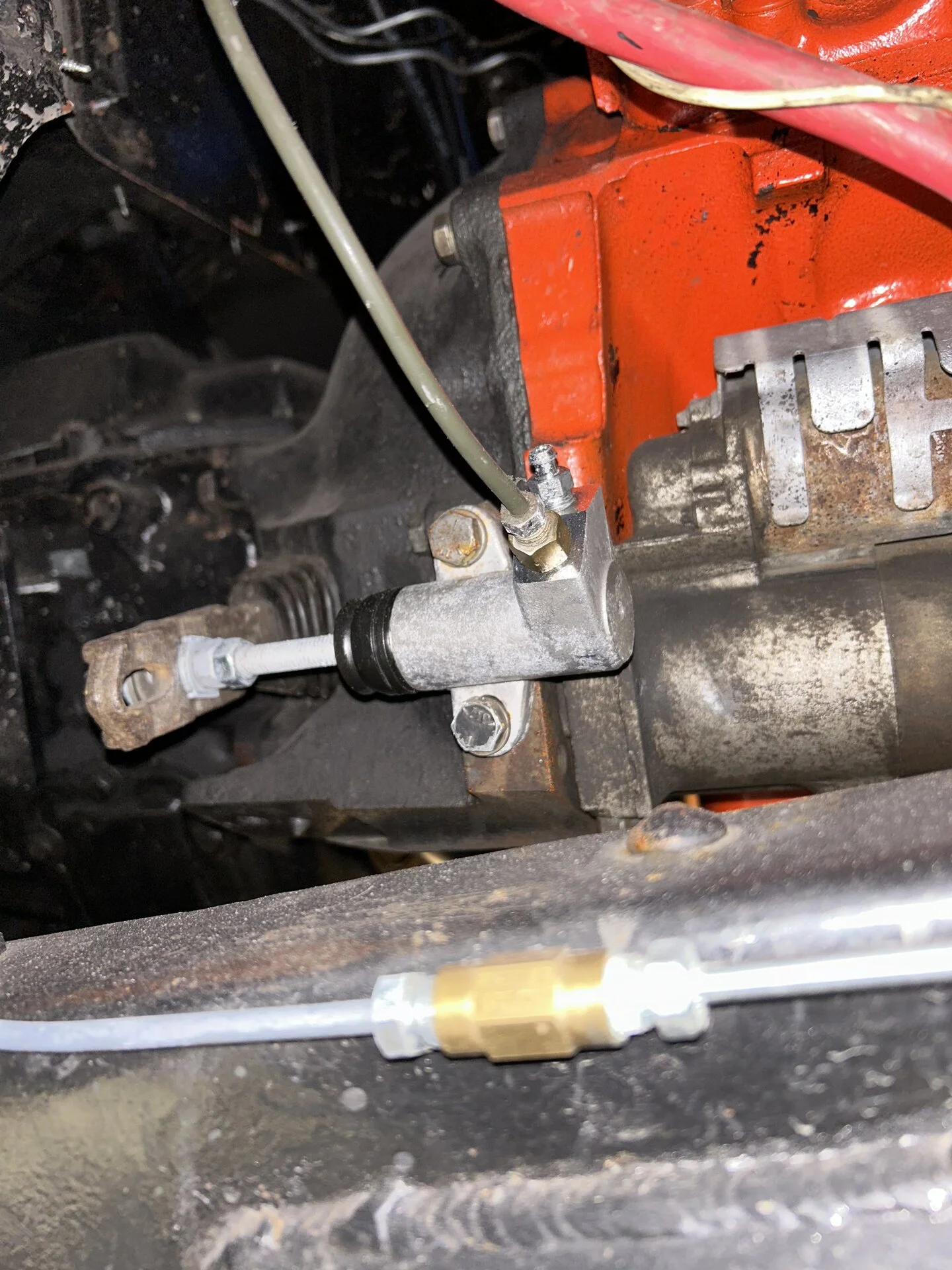

For now, stock FJ40 clutch master and slave. I’ve already replaced both with Japanese made units. Old ones were working fine but I wanted to eliminate that as a potential issue
I have a stock SM420 bellhousing and stock fork.
I essentially cannot get enough “travel” out of the slave to properly release the clutch as McLeod calls for .050” clearance between the disc and flywheel when released. And that is with virtually ZERO play between the throwout bearing and clutch diaphragm fingers

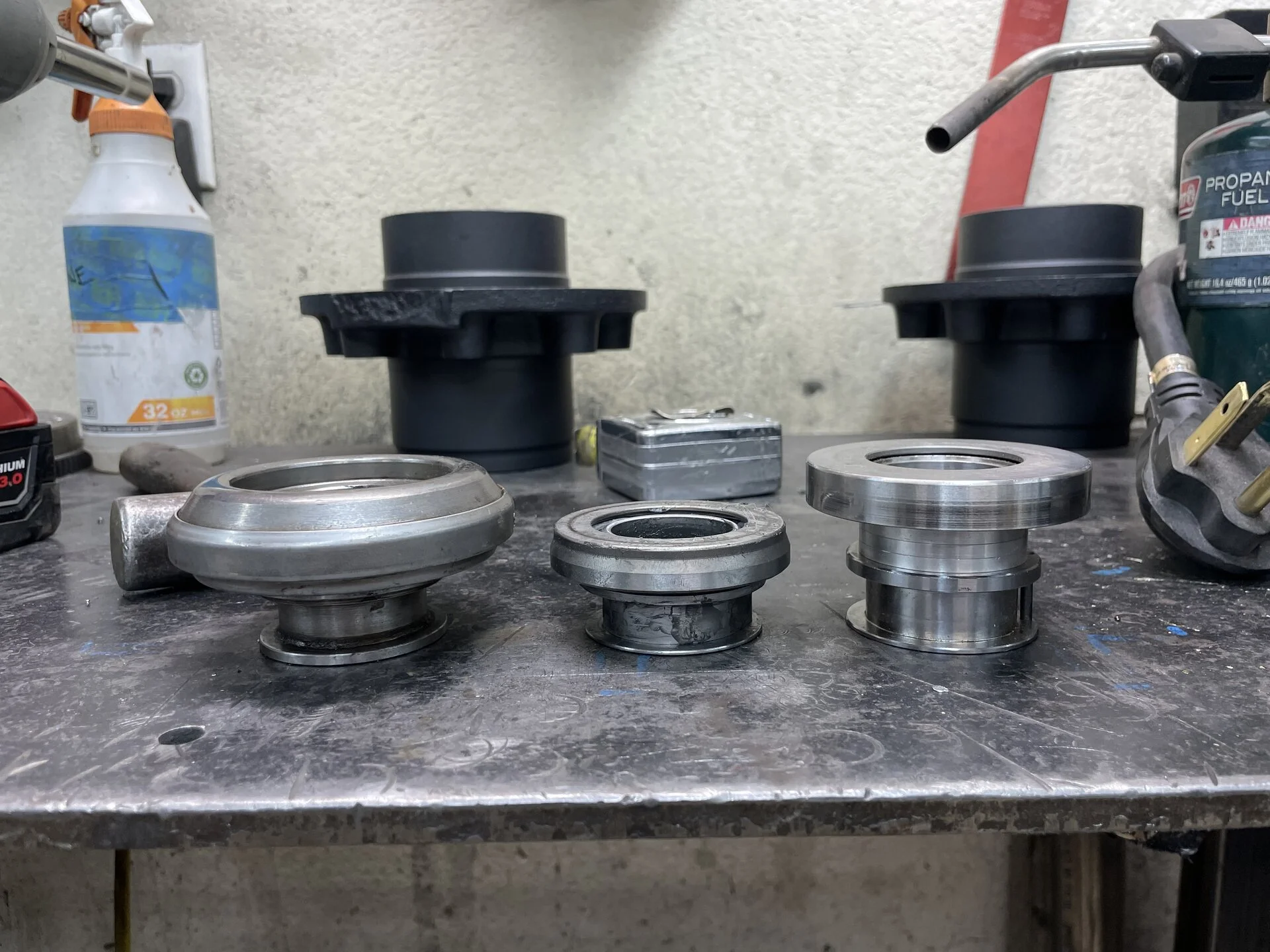

I’ve already pulled the motor (again) to swap throwout bearings AND now I also have an adjustable clutch pivot ball
Throwout bearing: left to right
Original CenterForce from the 5.7, original McLeod that came with the clutch and adjustable height McLeod

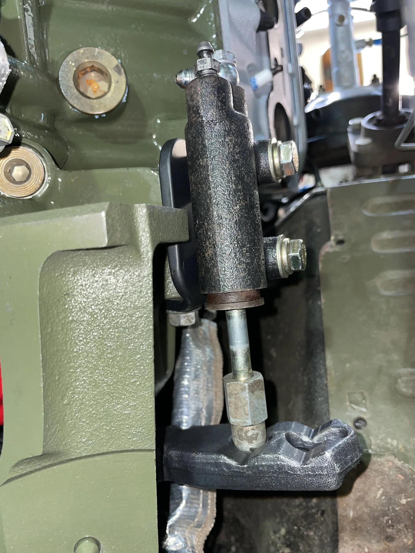

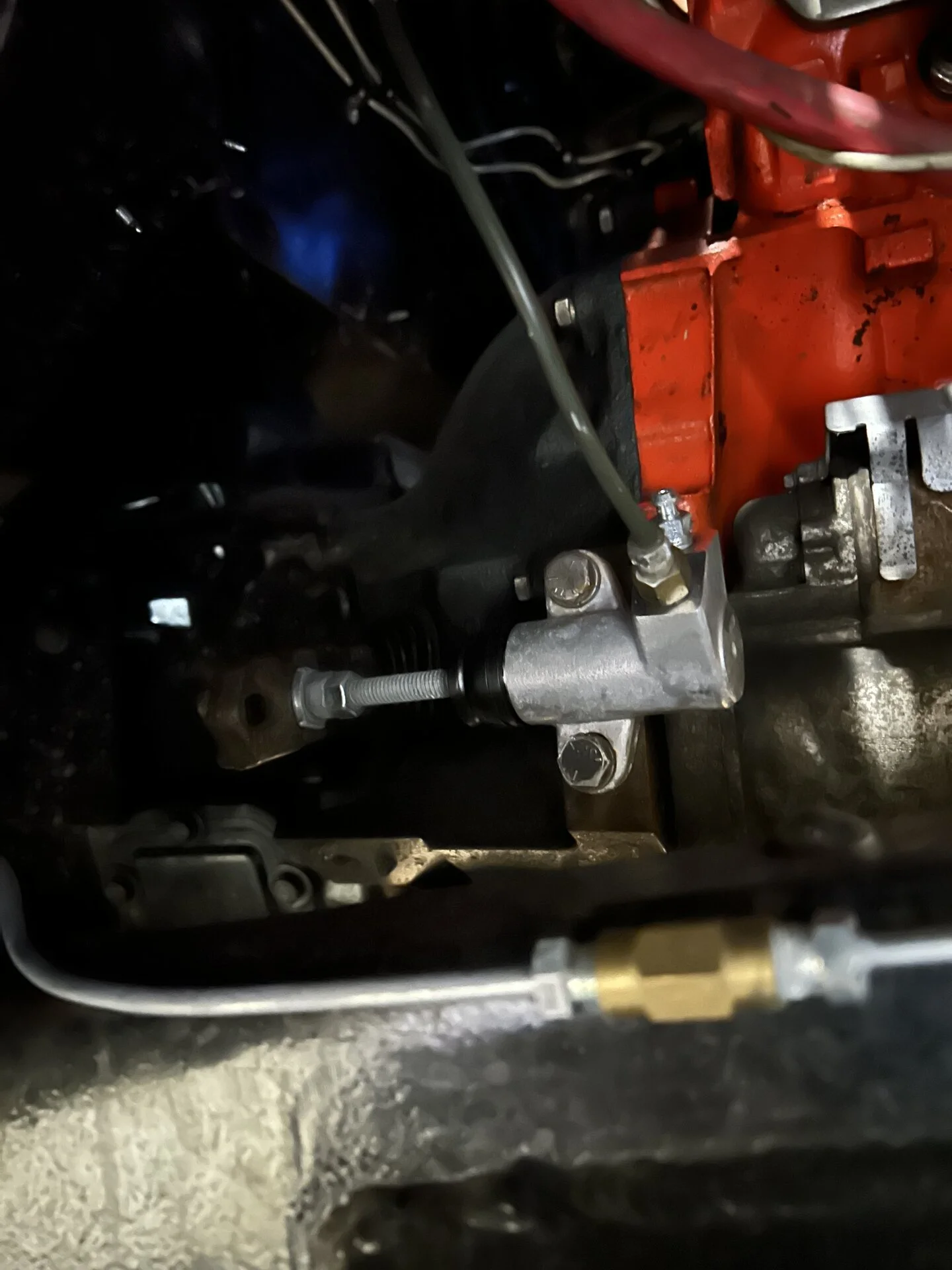

I also cut up the dumb AA slave bracket AGAIN. Shortened one attachment point so the slave moved inwards towards the centerline of the crankshaft. Now the slave can push on the innermost point on the fork which should make the pedal heavier AND provide a bit more throw
So….. even with the adjustable pivot ball and the fancy adjustable McLeod throwout bearing, I’m nowhere near the .050” McLeod is calling for. I’m probably more like .010”-.015” if I was to give the throwout bearing any free play.
It nearly impossible to get the transmission into 1st without grinding and the disc is obviously dragging on the flywheel
Should also mention that the clutch pedal is adjusted ALL the way out for maximum stroke on the master cylinder. Still can’t get there
Of note though, is the fact that the Toyota master cylinder has a 3/4” bore and the slave is right around .810” (yes I know it’s actually metric but my Mititoyo calipers aren’t metric). I believe the next step is swapping master cylinders to something with at LEAST an .810” bore or greater, probably 1” Hopefully that will be able to push a greater volume of fluid and as a result, achieve a longer stroke out of the slave cylinder
I’m open to suggestions and also somewhat stumped. The old CenterForce clutch never had any issue properly releasing. The McLeod is a full 12” clutch but I wouldn’t think that would cause an issue

Thx, this is good info. I’ve got the later version master cylinder, truck must have been a late ‘69 as it’s the common triangular 3 bolt mounting pattern.
I’m suspicious that the pressure plate fingers are likely different from the CenterForce somehow. As in they need more overall travel to release. I’ve never run a LuK clutch, only CenterForce but decided to branch out and run the McLeod 🙄
I’ve got a Wilwood master with a .0875” bore on order. At about $70, it’s an inexpensive attempt at least. I should be able to make an adapter bracket easily so it’ll mount to the factory 3 bolt pattern. Being a larger bore in relation to the slave means it should push more fluid and get additional travel out of the slave. We’ll see

So I’ve got no idea if this will help or not. I have a similar setup in that I have a GM v8 (5.7 vortec) with an SM465, stock iron bellhousing, what looks like the same basic clutch fork, and a 12” clutch. I run a later model FJ40 master with a slave from a ‘81 Nissan 280zx. Why? Because I had the same problem you do when I put it all in with the stock slave.
I measured the bore of the master, went to the parts store with calipers, and found that slave. It had the mounting configuration I wanted to the GM bell, with the bore that was about the same as the master. It works. Pedal travel and effort are fine.
Fun fact: It needs to use the inner mounting on the fork, if I put it in the outer one, the slave has so much travel it pops the piston out of the bore.
Other fun fact - I make my own pushrods from all thread, carefully rounding and polishing the end in the slave as the length is beyond what the Nissan one can handle.
Final fun fact - they’re really cheep. Like $14 online or less than $20 at the store.

Really interesting. I’ve never seen that setup before using a Nissan slave. Looks to be mounted on the passenger side of the bellhousing? I will have to see if the SM420 bellhousing has those mounting holes, they are different from the SM465

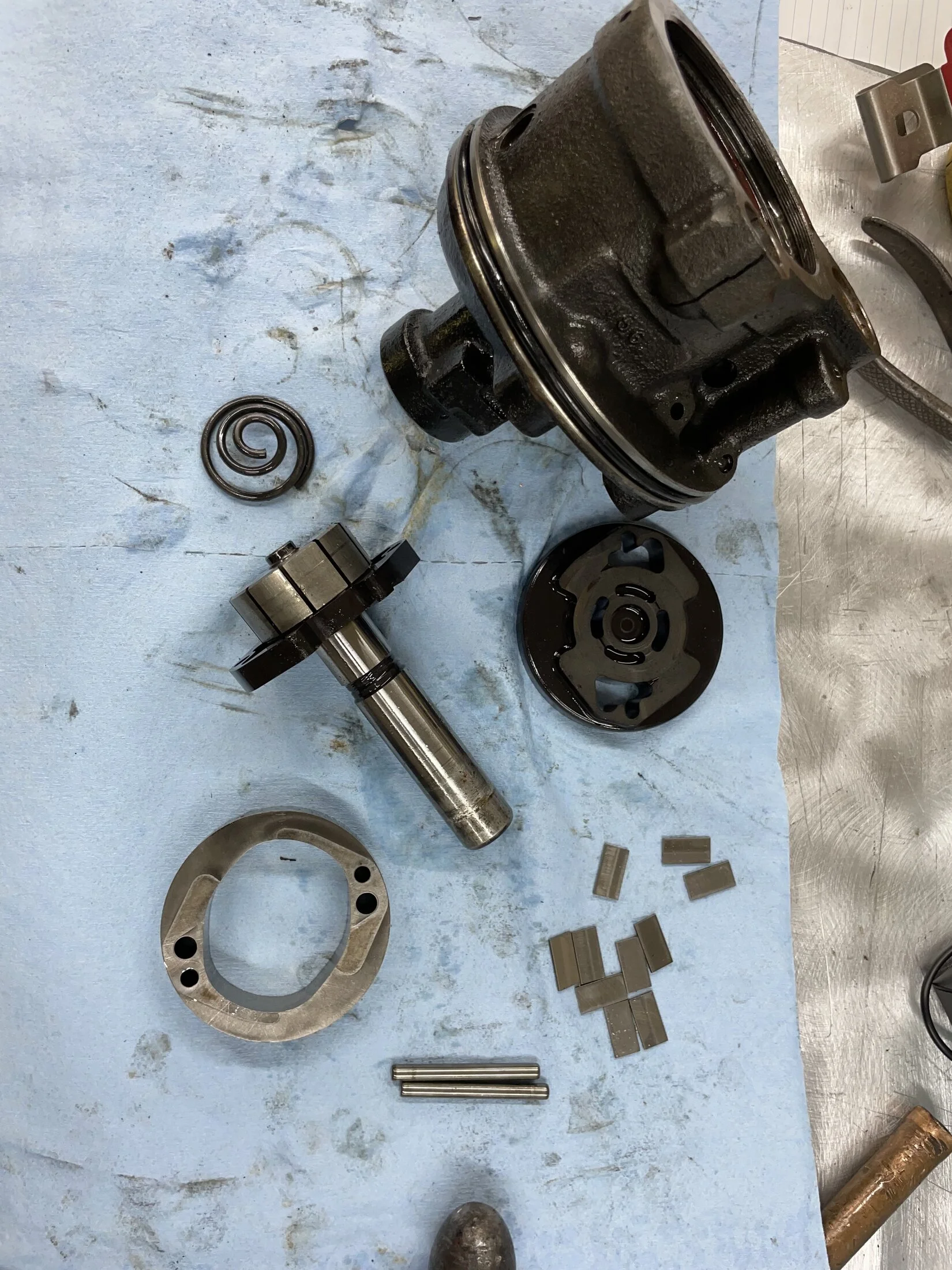

Gently breaking in the LS at the Tillamook State Forest this past weekend. That’s about 6k rpm at the top of the hill and I think the PS pump had more or less grenaded at that point. That modified factory pump lasted less than 4 HOURS
THANK YOU @mr jits and @boots4 for the help with swapping pumps back in camp 😂
It was great helping on such a clean rig!
Honestly, not as much damage to the internals as what it sounded like when we shook it. Makes sense why we hardly saw any metal in the system.
