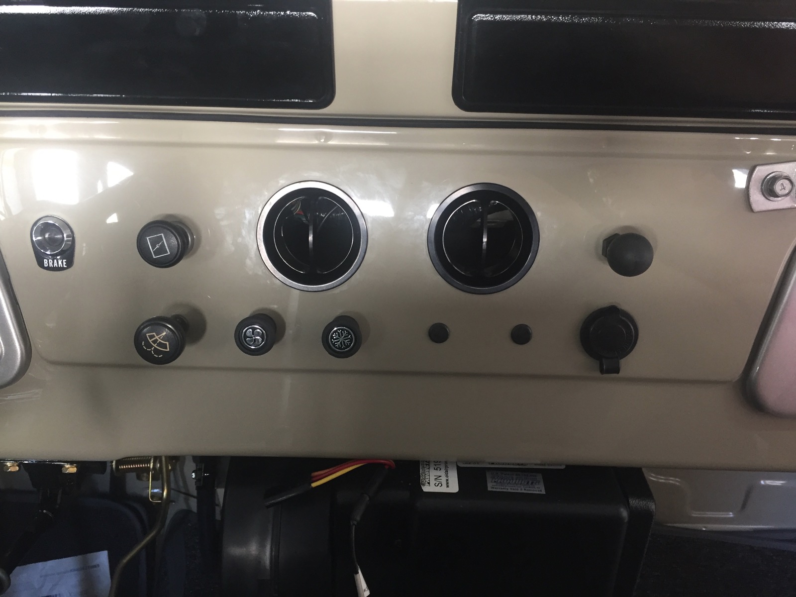

How about a pic of the finished dash?
Stay tuned...

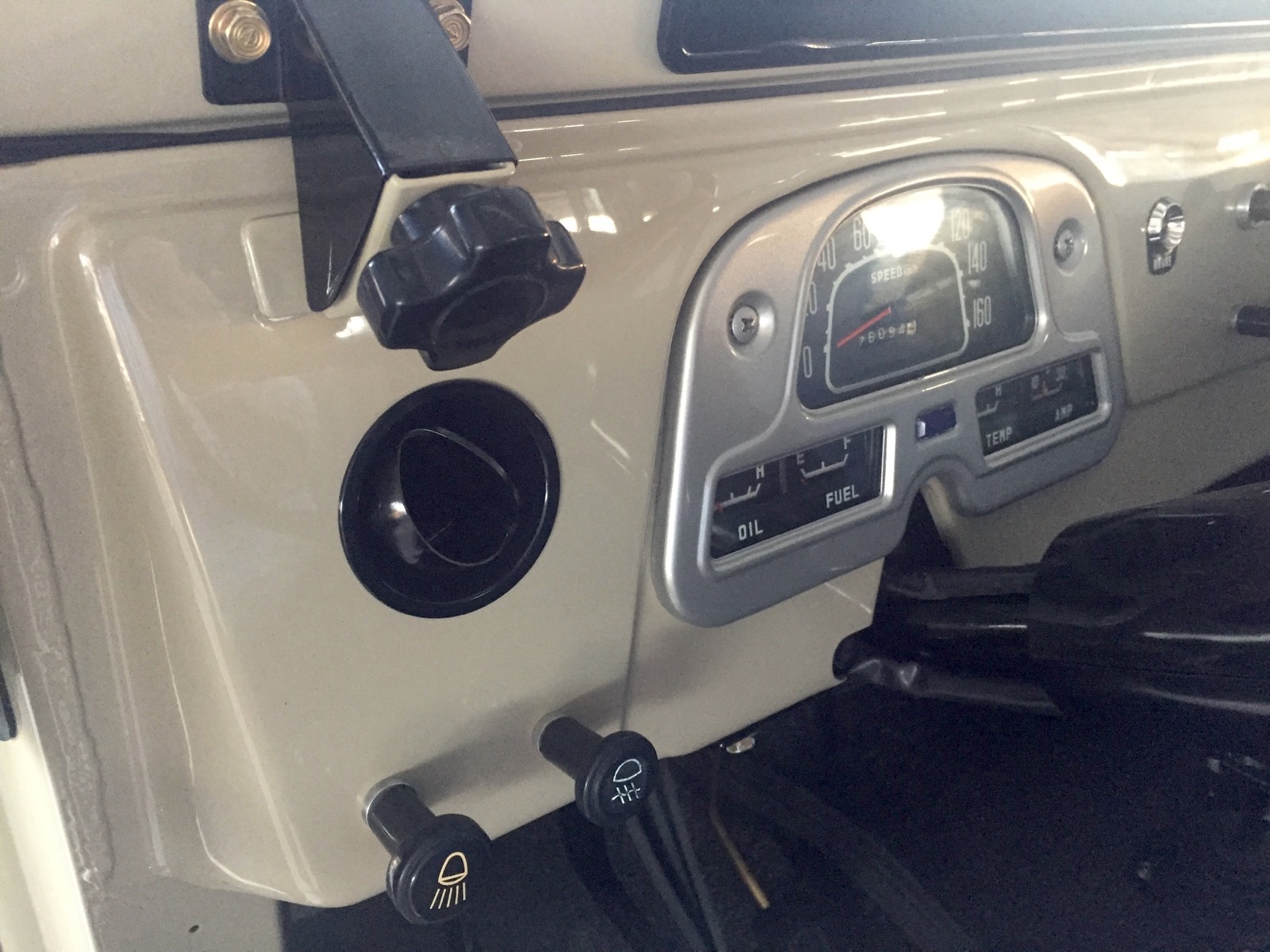

Very nice. I really like the setup. Not a fan of the dash holes but those could always be moved into a different location. It also looks like you could retrofit the fresh air duct back on the truck.
Here's a few...
Thanks!
Yeah, the holes in the dash aren't gonna be my most popular move. =) But there were a few non-original aspects to this truck that freed me up to take some creative license. I almost changed the color, but stuck with Dune Beige in the end. I could easily be the purist, but it wasn't meant to be for this truck.
I've never liked the mis-assigned switches and ash tray in the 40... nor the radio pocket. So I took the liberty of bringing some refinement to the dash layout.
The dash vents could be done quite differently with the system still located as I've done. And I agree, there's likely a way to easily retrofit the fresh air duct... if I had one. =)
