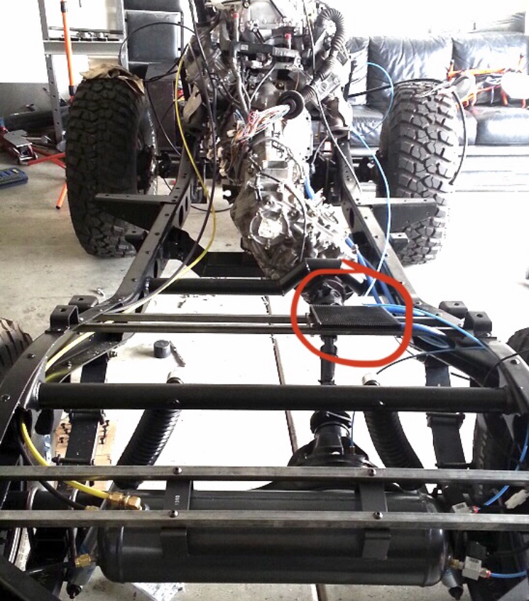

I did a little snooping around. I assume this is the UZJ40 setup you are referring to?
That's actually a transmission cooler pictured, but I think UZJ40 sandwiched an A/C condenser and SPAL fan in there somewhere. Pics of your setup would be awesome regardless!

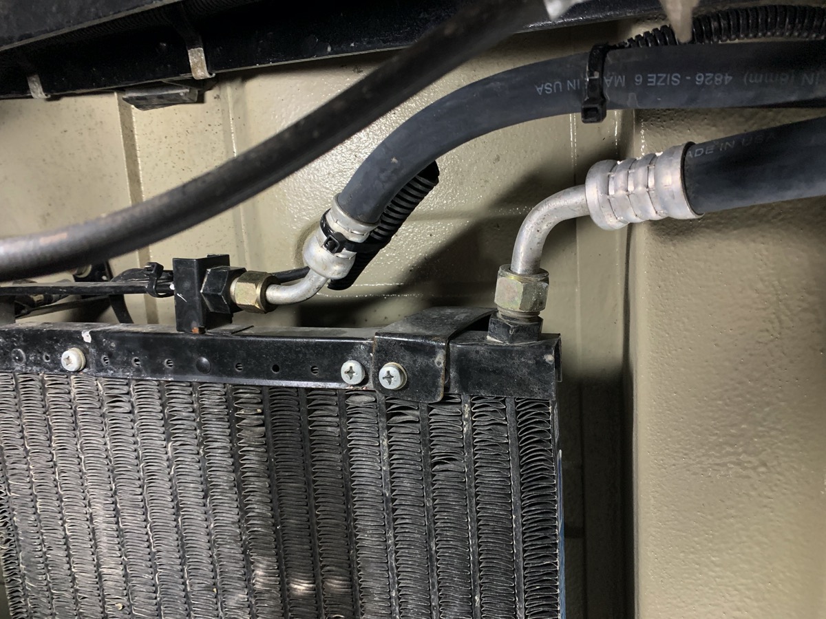

By popular demand!!
Some photos of the condenser mounted up under the tub.

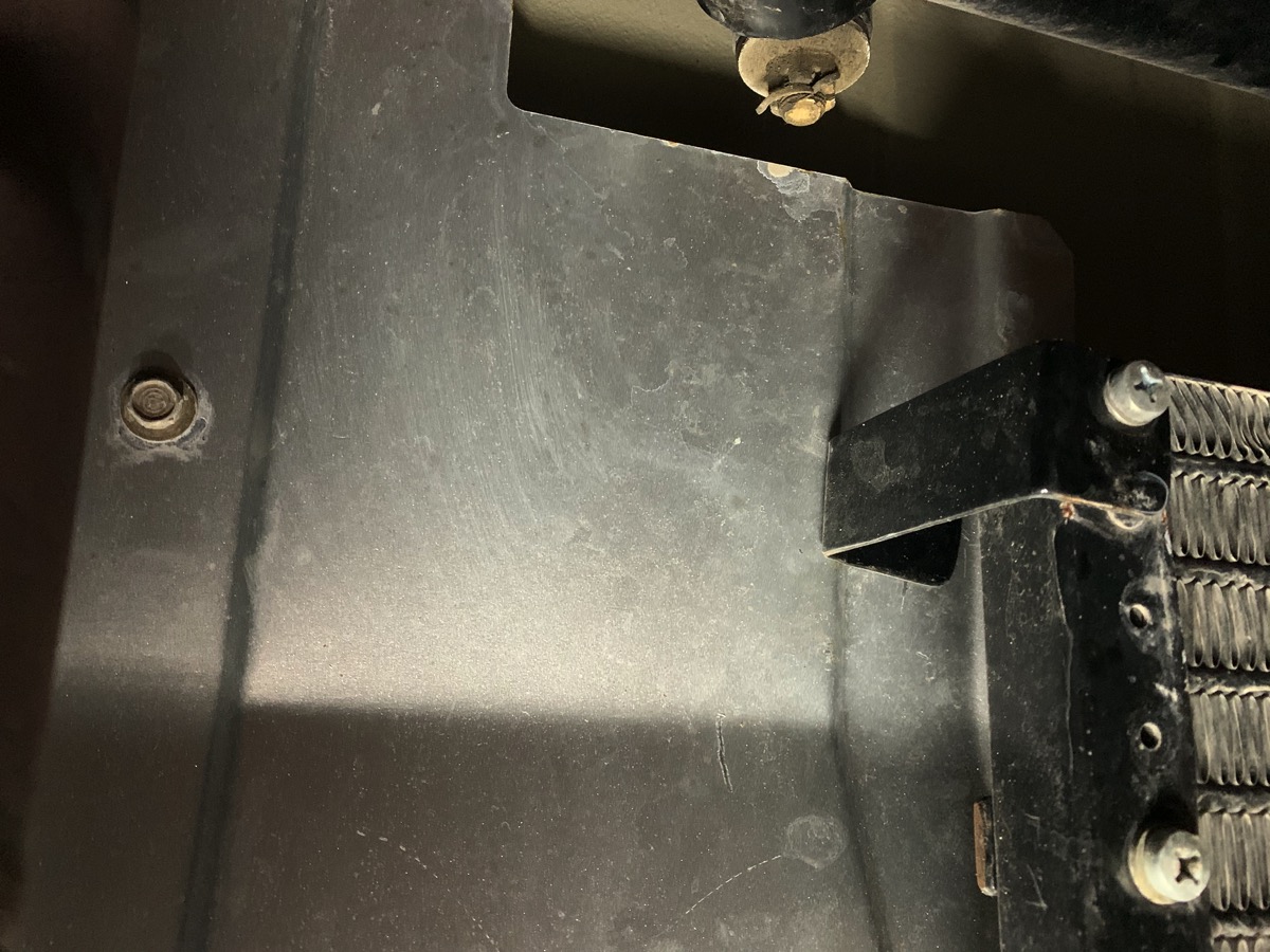

To mount it we made some stand-off brackets that bolted to existing captured nuts in the body. Two of those captured nuts were there already holding in a heat shield. So we stood off of that. The other two captured nuts were ones that I had welded in during the restoration to eventually bolt down a platform into the back of the 40. When it comes time to do a platform back there I'll have to figure out how to make that best work.
Mounting looked something like this...

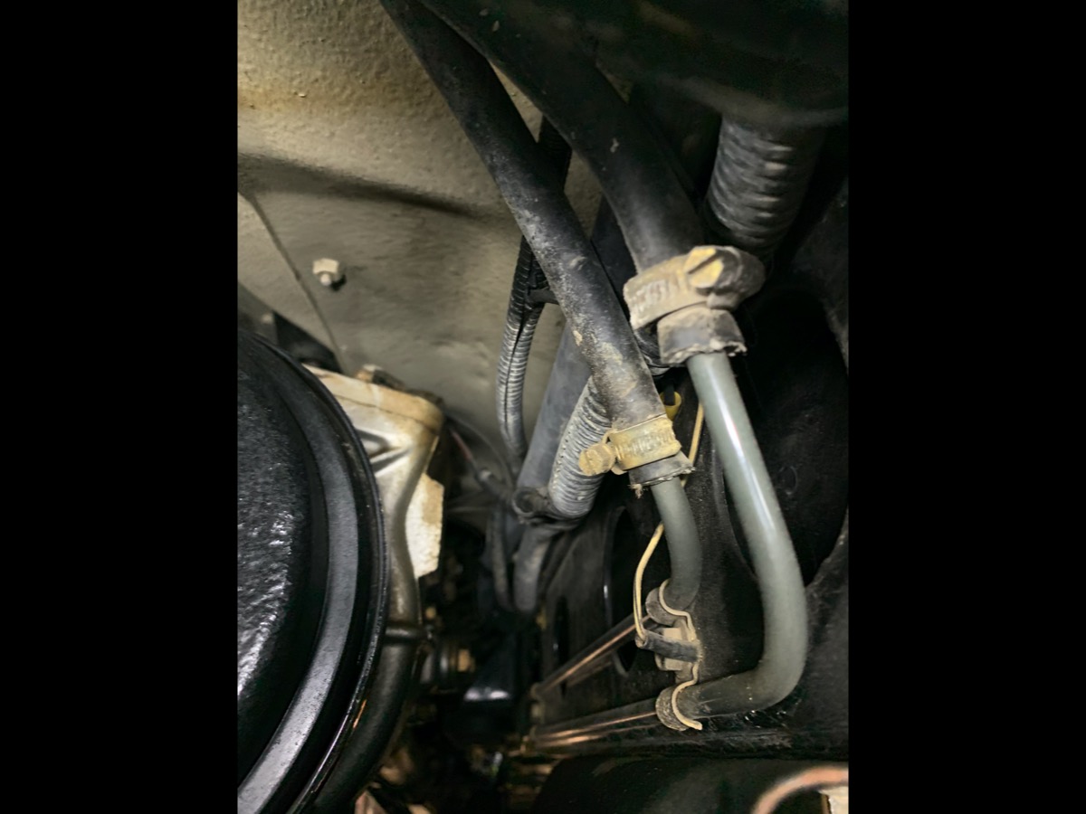

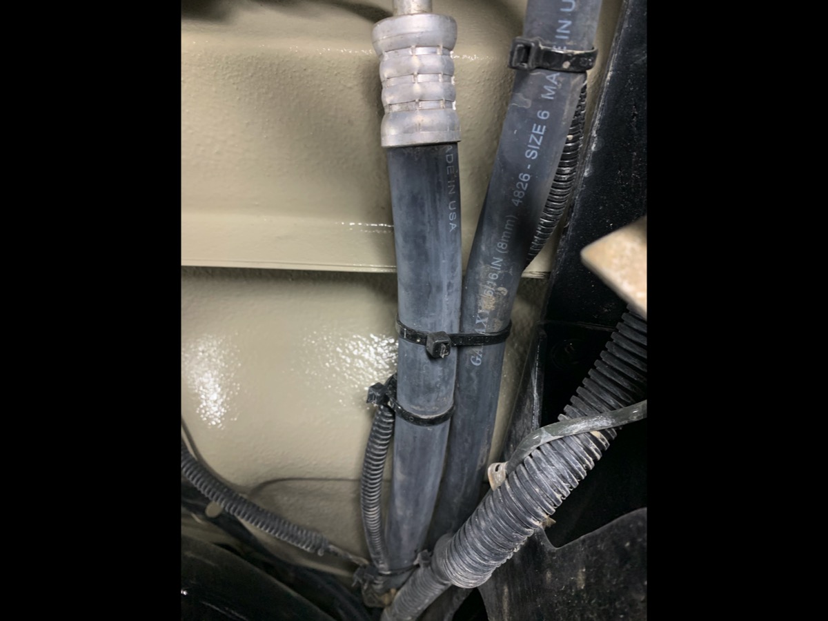

Here's how the hoses exit and fun...

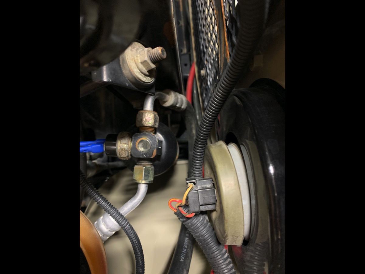

And the drier bottle still sits next to the radiator up front.
The condenser is the same one I'd originally mounted up front, a 14" x 18" x .86".
