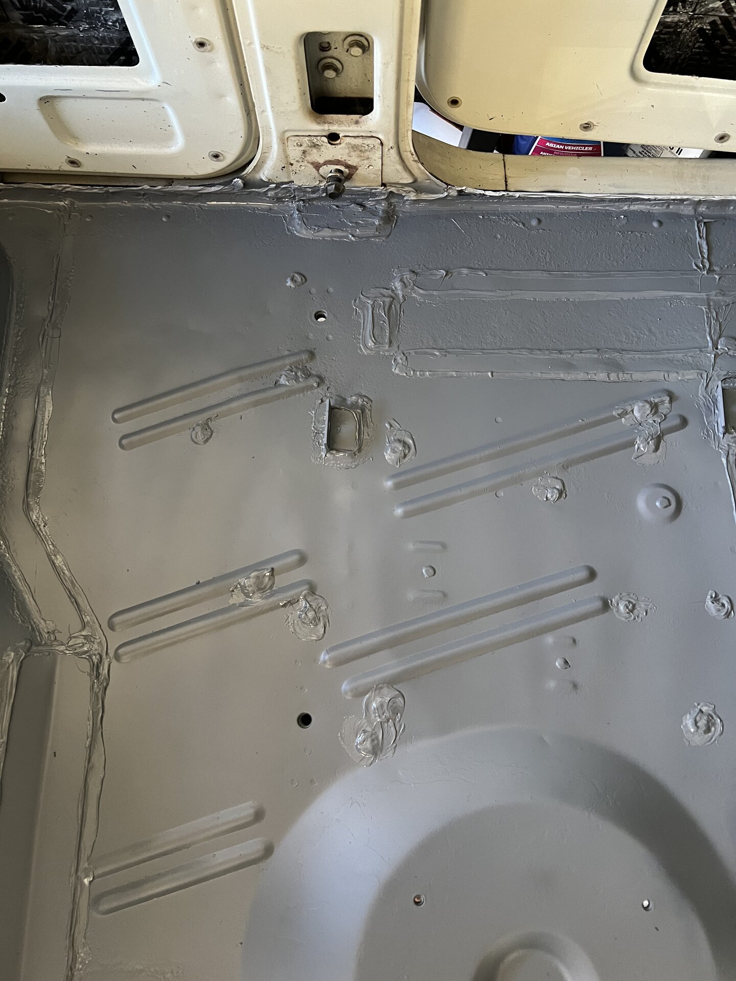

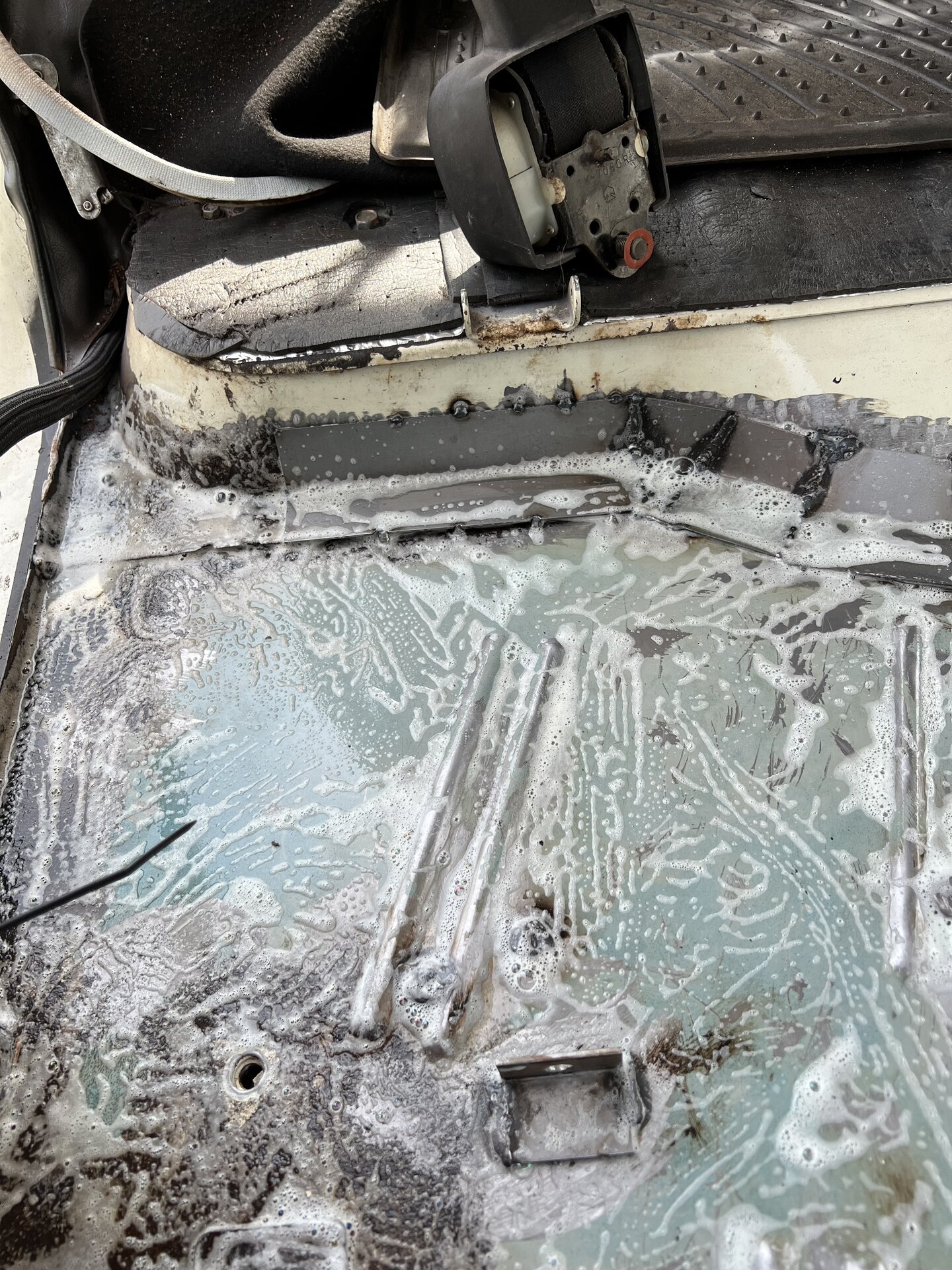

Steps I used:
Wire wheel
Sand
Prep with acid where needed
De-grease with purple power
Then water, brake cleaner
Seam sealer
Rust reformer on raw metal
Primed grey
Sand where needed (bugs, dirt, etc)
Then Rustoleum professional grey enamel.
Took almost 2 cans.
I don’t plan to top with anything because it will all be covered.

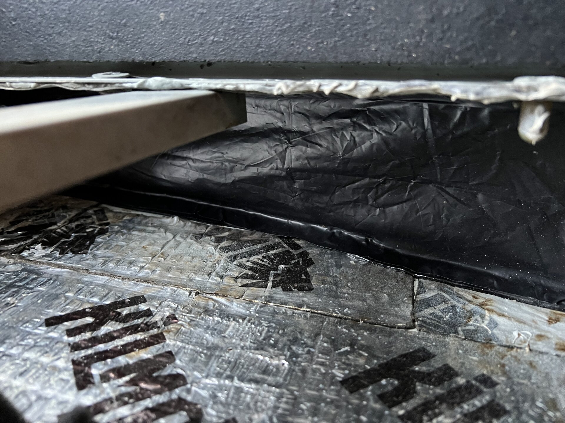

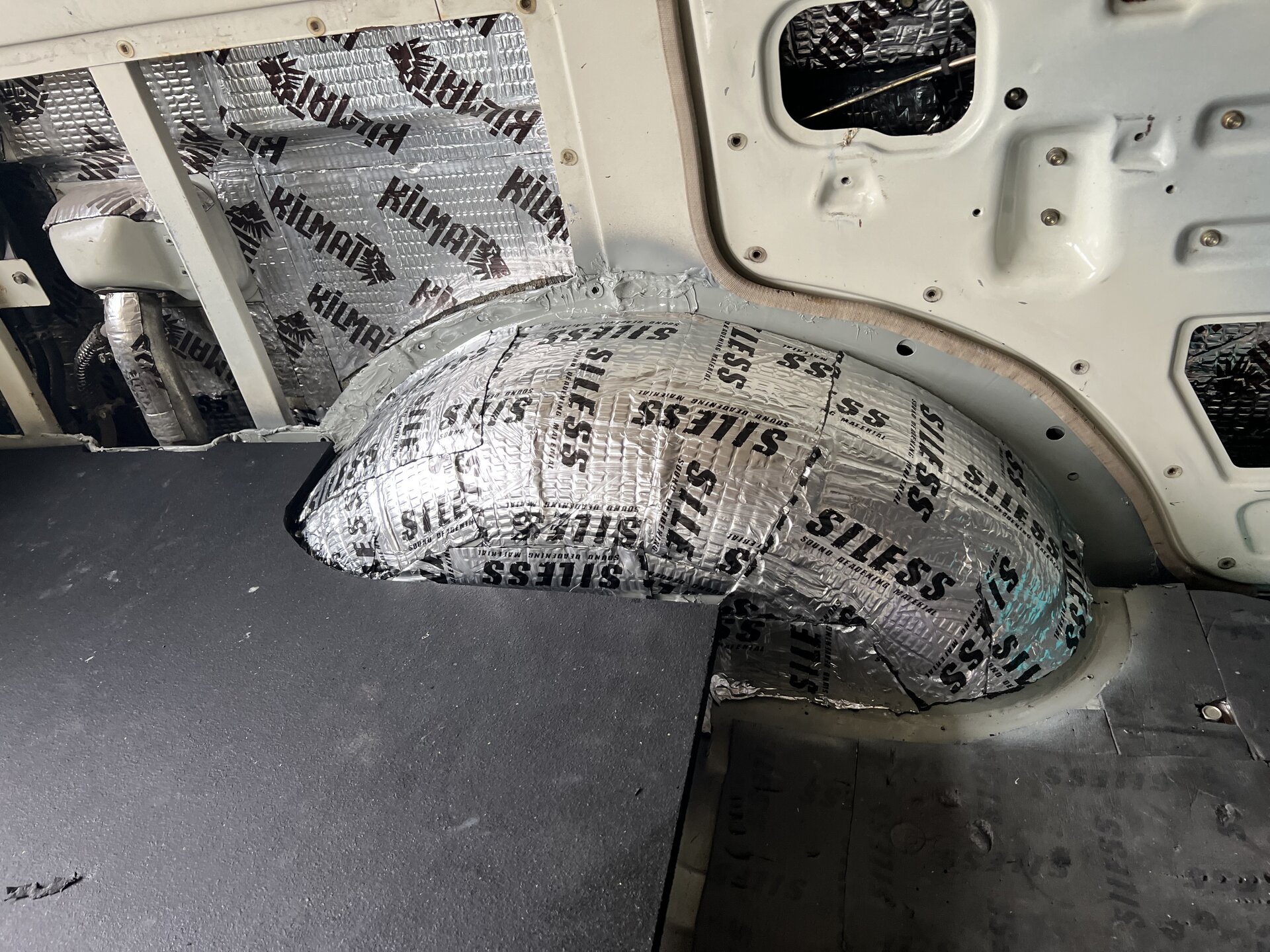

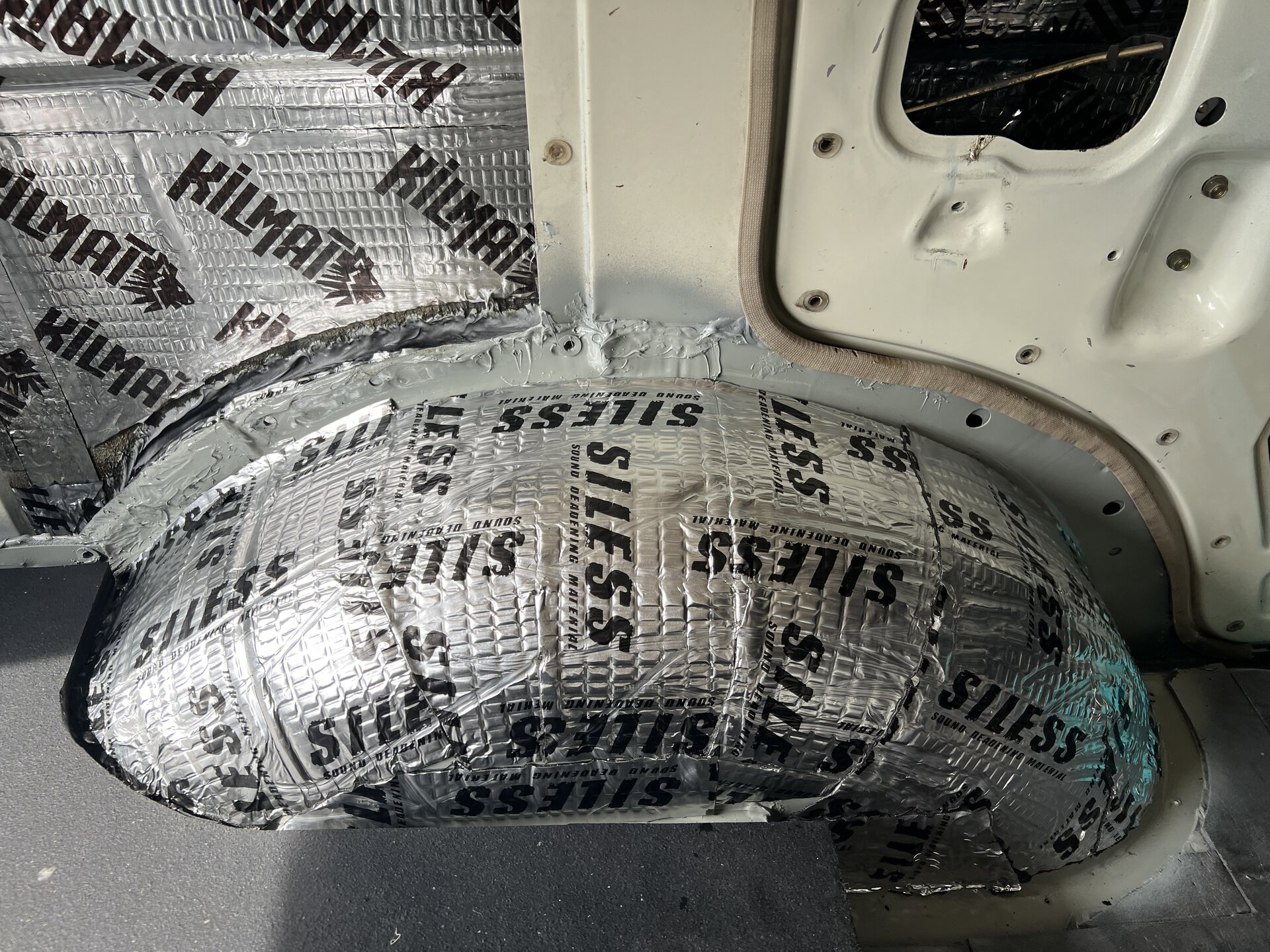

For sound deadening used Kilmat and Siless foam.
For the Kilmat, I only de-greased before applying.
The foam goes on top the Kilmat.
In my opinion makes a heck of a difference.

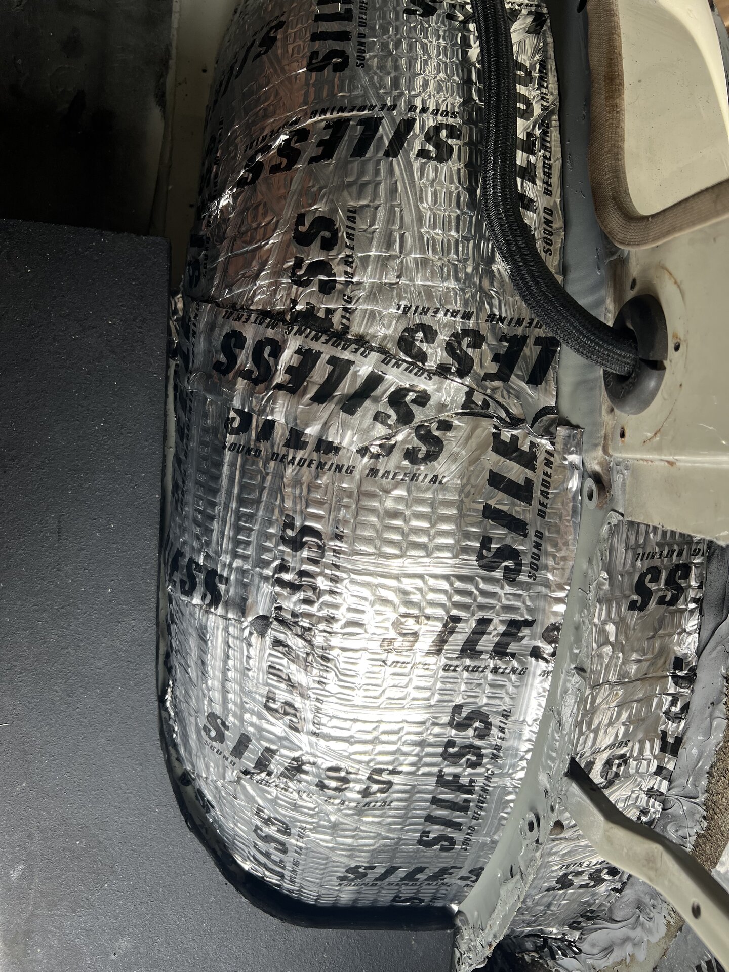

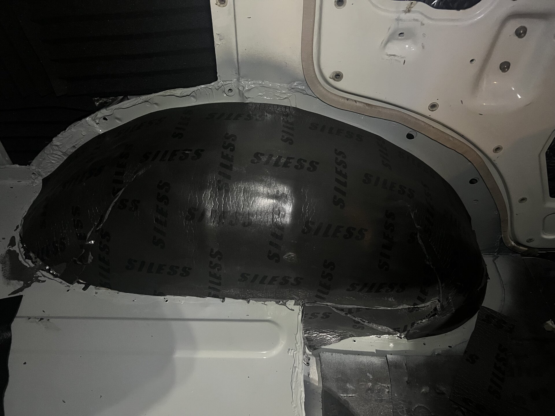

Added sound deadener to the wheel wells. Next steps cover with siless foam then the original vinyl covers.
Significant difference in deadening sound. Almost excited to hit a gravel road to see the difference.

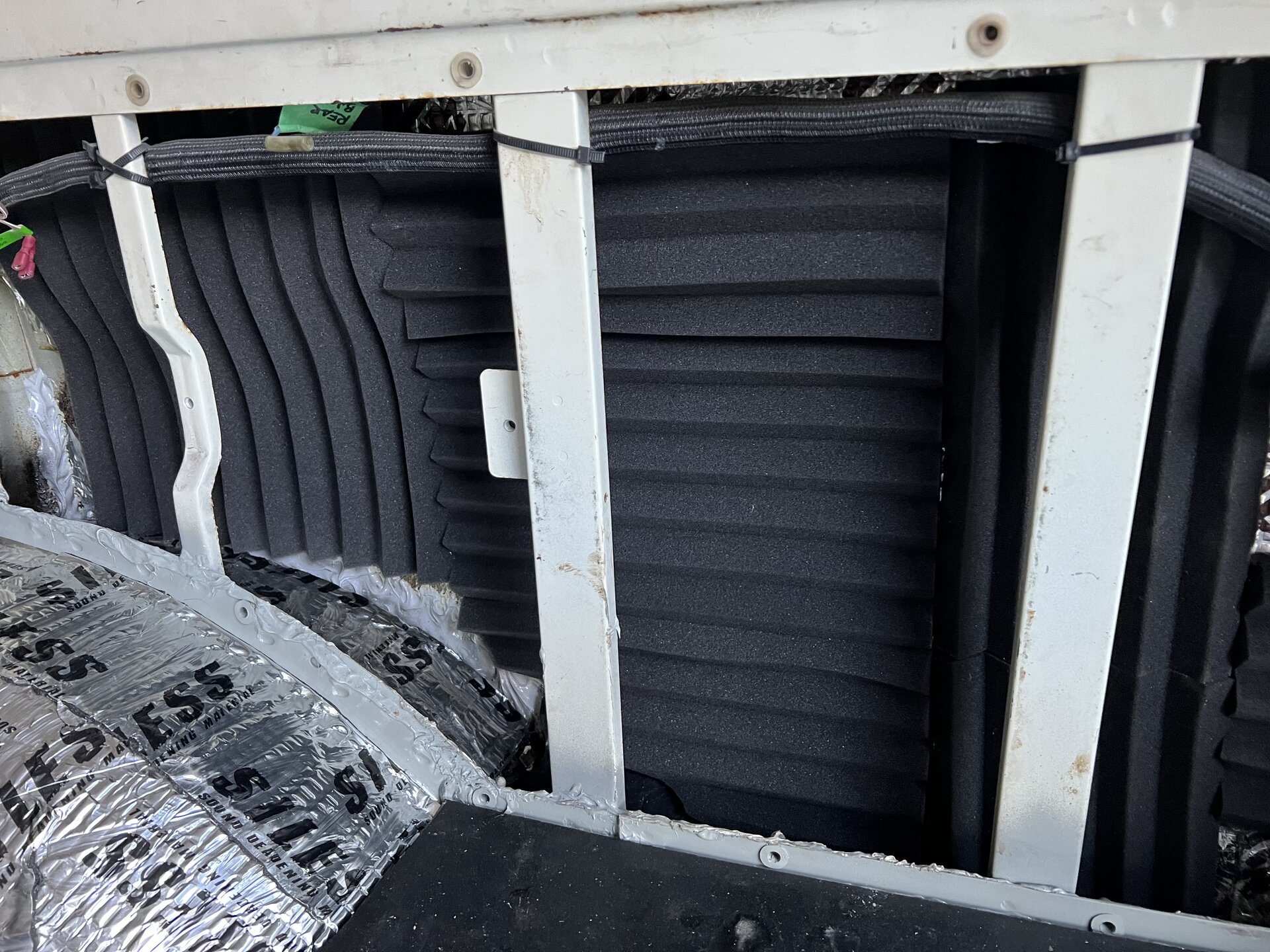

Had some other foam available so I added on top of the kilmat. Seems to be working good.
Also added a plastic barrier behind the well, sitting low, under the wire grommet and up to the wheel well. Trying to stop any water entering.
Will also add a battier behind the cards for double protection.

Added siless foam to the kilmat on top of the wheel well.

Added the original wheel well covers.
Painted the trim pieces and put them to work on a piece of vinyl.
Took a quick drive…smiling the whole time.
Rear cargo = quiet (as can be)

I used Klean Strip metal and concrete etch.
Rust Reformer is the rattle can from Rustoleum.
For interior sealer I’ve used Titebond aluminum gutter and seam sealer.
For the exterior sealing I’ll be using 3M Dynatron.
The floor will be covered with the same sound deadening of kilmat, then siless foam, then covered with the original floor rubber covering.
