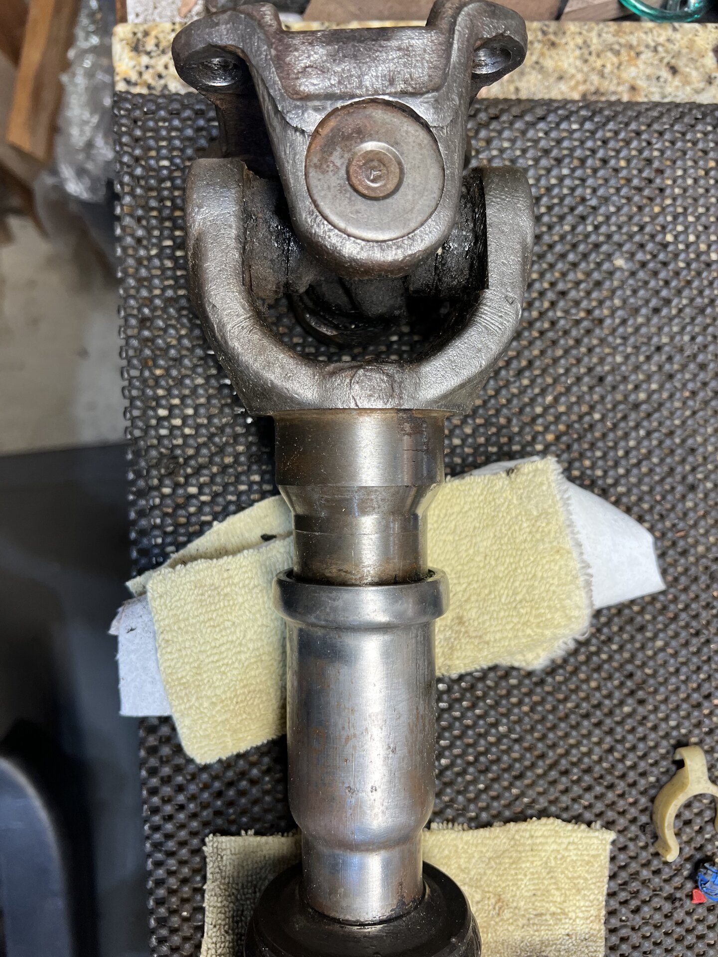

It will. Most of an entire day anyways, depending on if you have access to a steam cleaner and a solvent tank. Most of the time spent is cleaning.Heck as long as this took, the birfields will be a whole weekend.

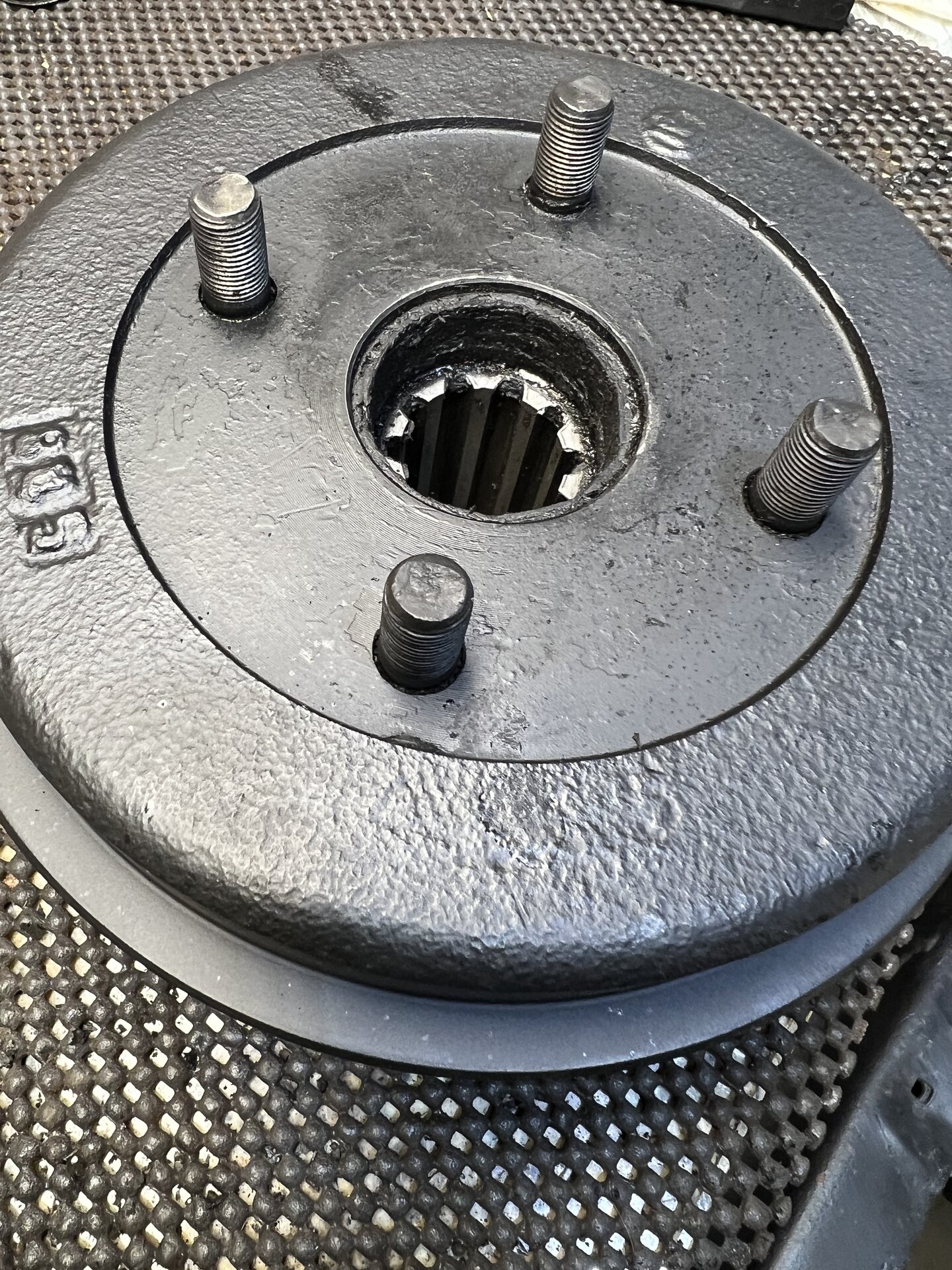

What's anybody's thoughts on putting some silicone sealer on the output splines to keep oil from leaking? I've always done it, but really not sure if it's the right way or nut.

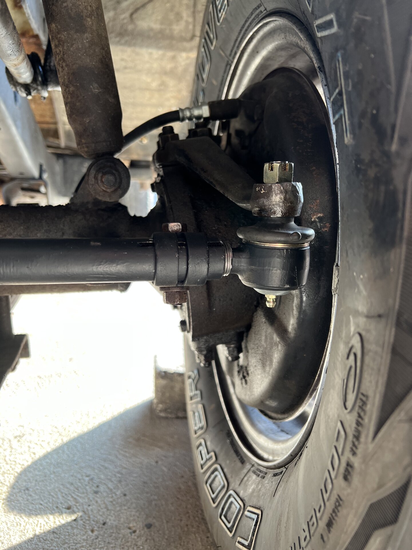

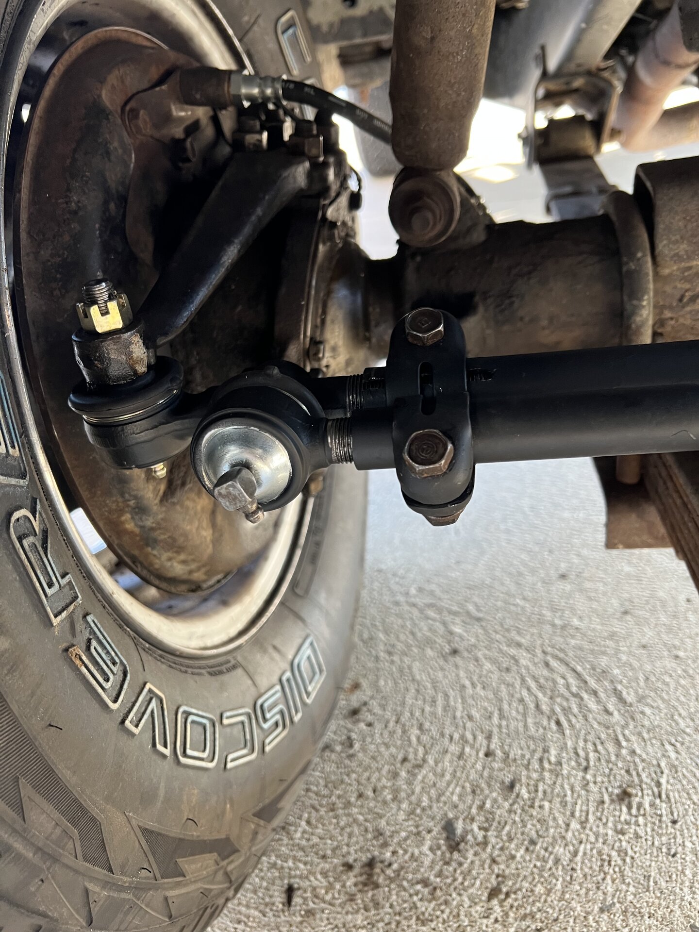

The first time you do the birfs, the first side takes longer. If you can dig in on the other side shortly after you will remember everything you learned. The second side does not take as long!And final shots

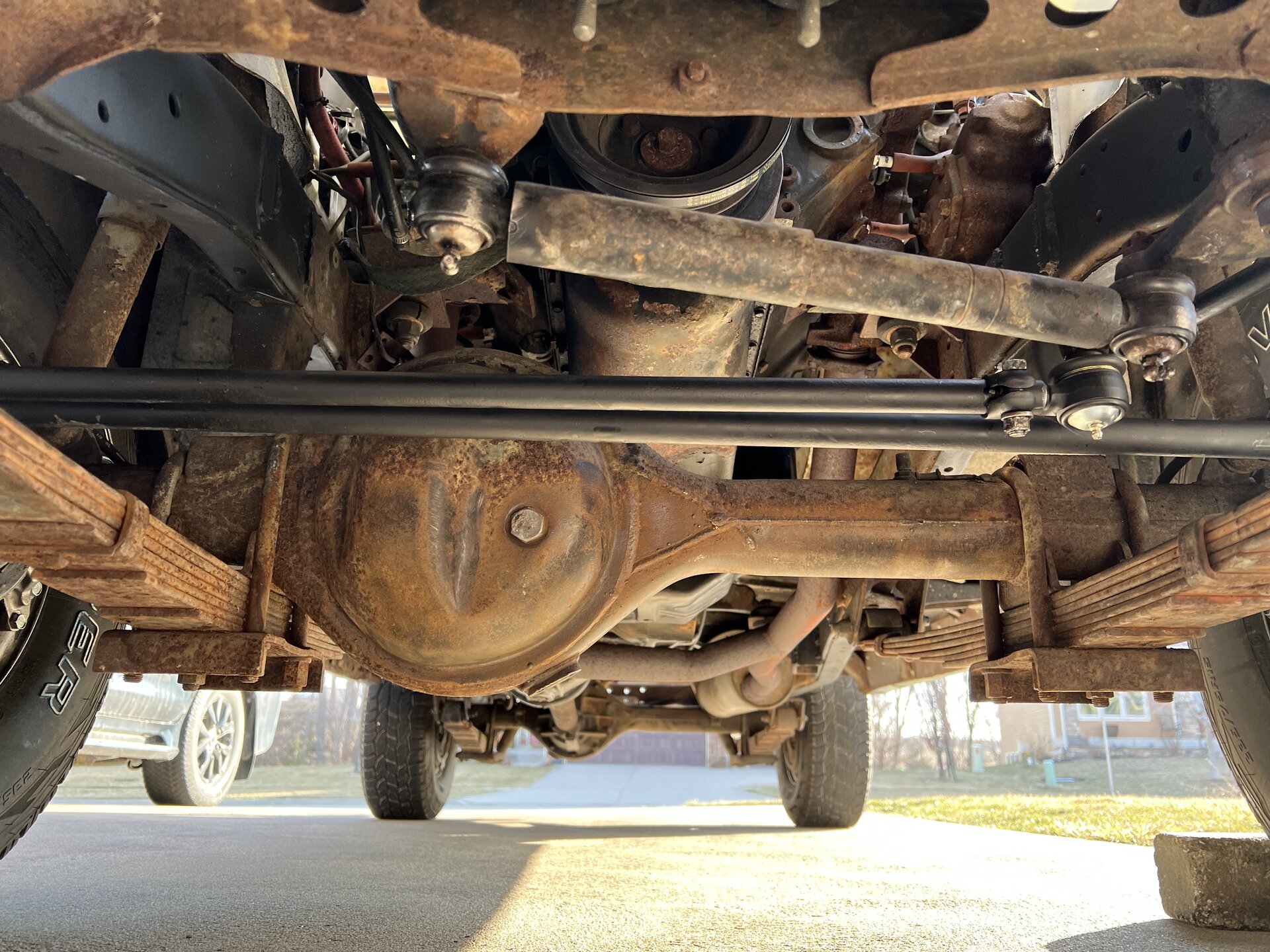

Now to start getting the other things under there cleaned up.
Get several rolls of paper towel!It will. Most of an entire day anyways, depending on if you have access to a steam cleaner and a solvent tank. Most of the time spent is cleaning.

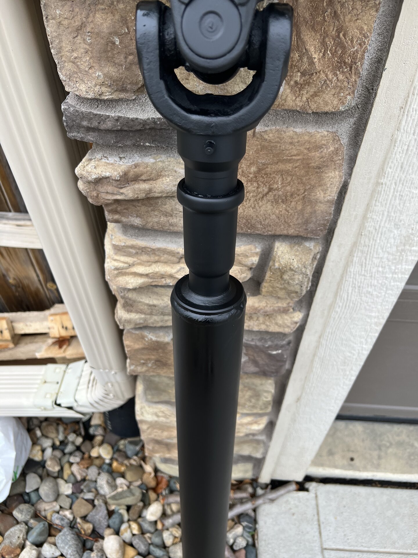

Not sure I can recall the last time I saw the word "riboflavin" here in the Pig forum...Having a good balanced driveshaft is important, like having Total cereal fortified with riboflavin for a good balanced breakfast.
If nobody but you gets a chuckle out of that, then it was all worth itNot sure I can recall the last time I saw the word "riboflavin" here in the Pig forum...
Big laugh! LOLIf nobody but you gets a chuckle out of that, then it was all worth it
