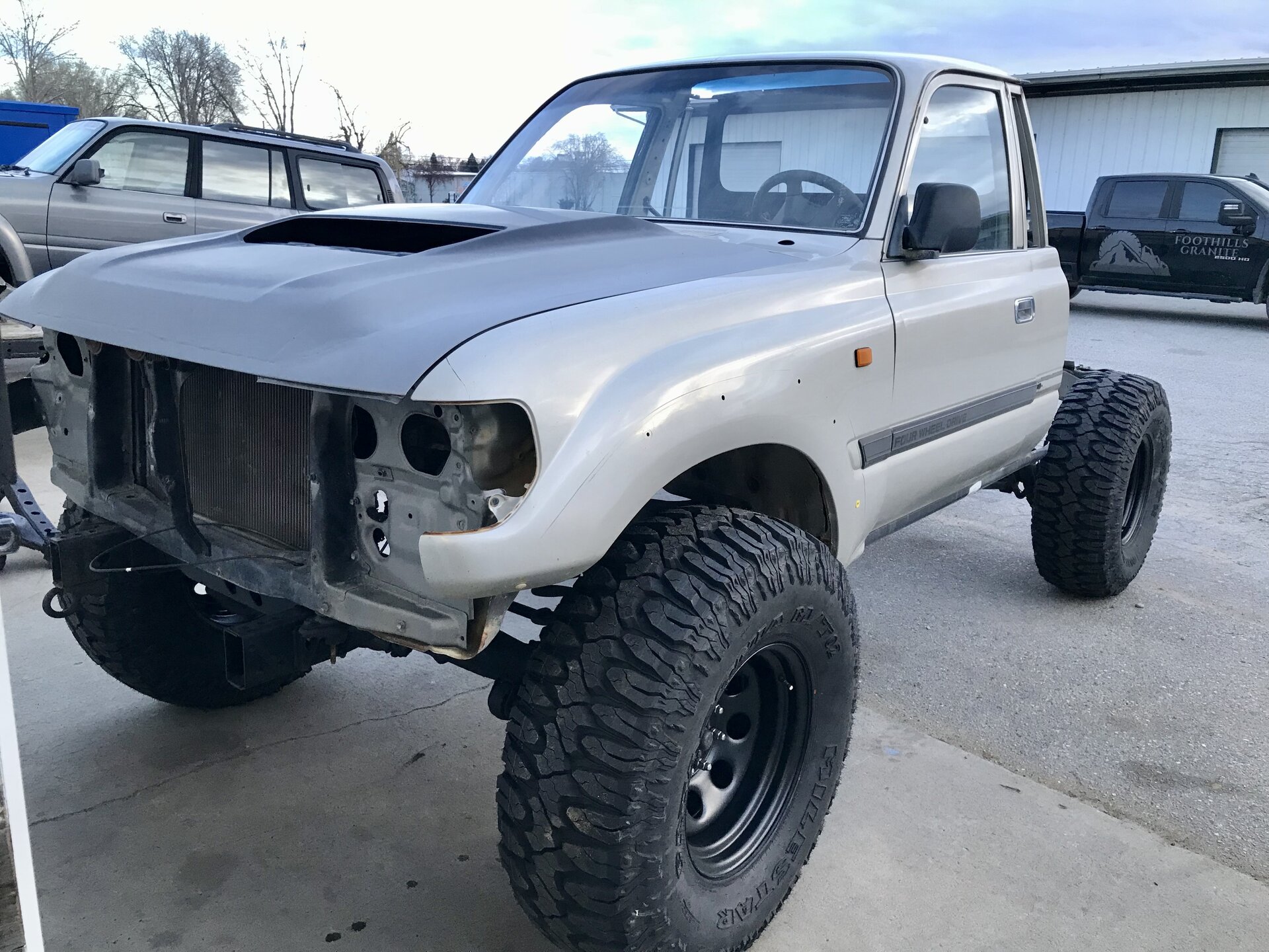

Tell us about that hood…
2016+ DPF 79-series hood grafted to the 80-series hood. I am running a 1HDFT turbo diesel with a functional top mount hood scoop.
Build thread here.
