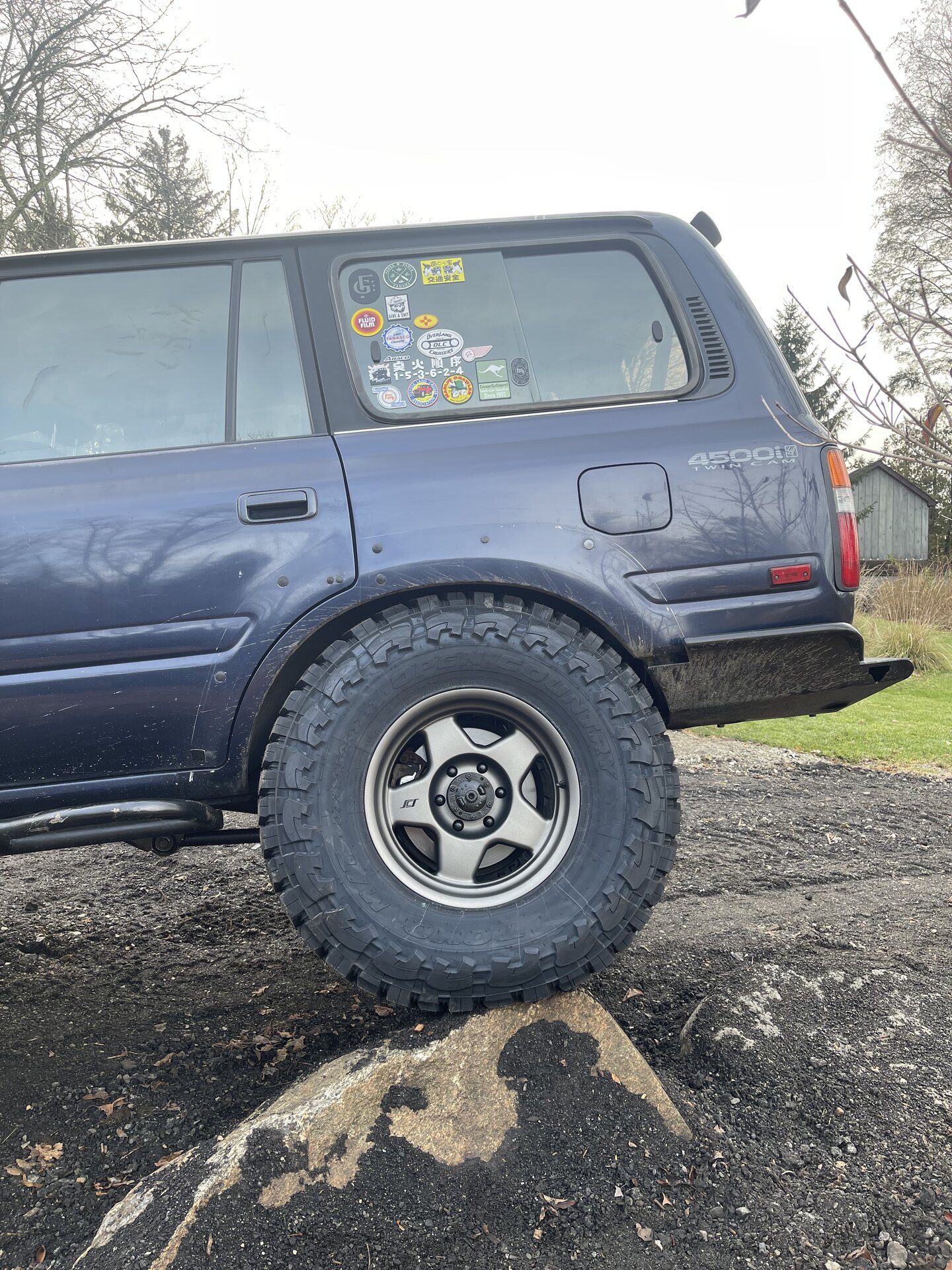

I have the toyo 37 on -10mm offset and they tuck in the rear nice with no flare, I have the extended length land tank lowers and 2” bumpstop extensions and it rubs a little more on the rear portion of the fender then the front. For the front, the delta 3L arms push the axle forward and inch. I haven’t done anything to fix the front rubbing yet but it rubs on the everything minus the firewall. In the picture the rear still has 2” before the bumpstop. The front still had 3-4” before stock bumpstop.
