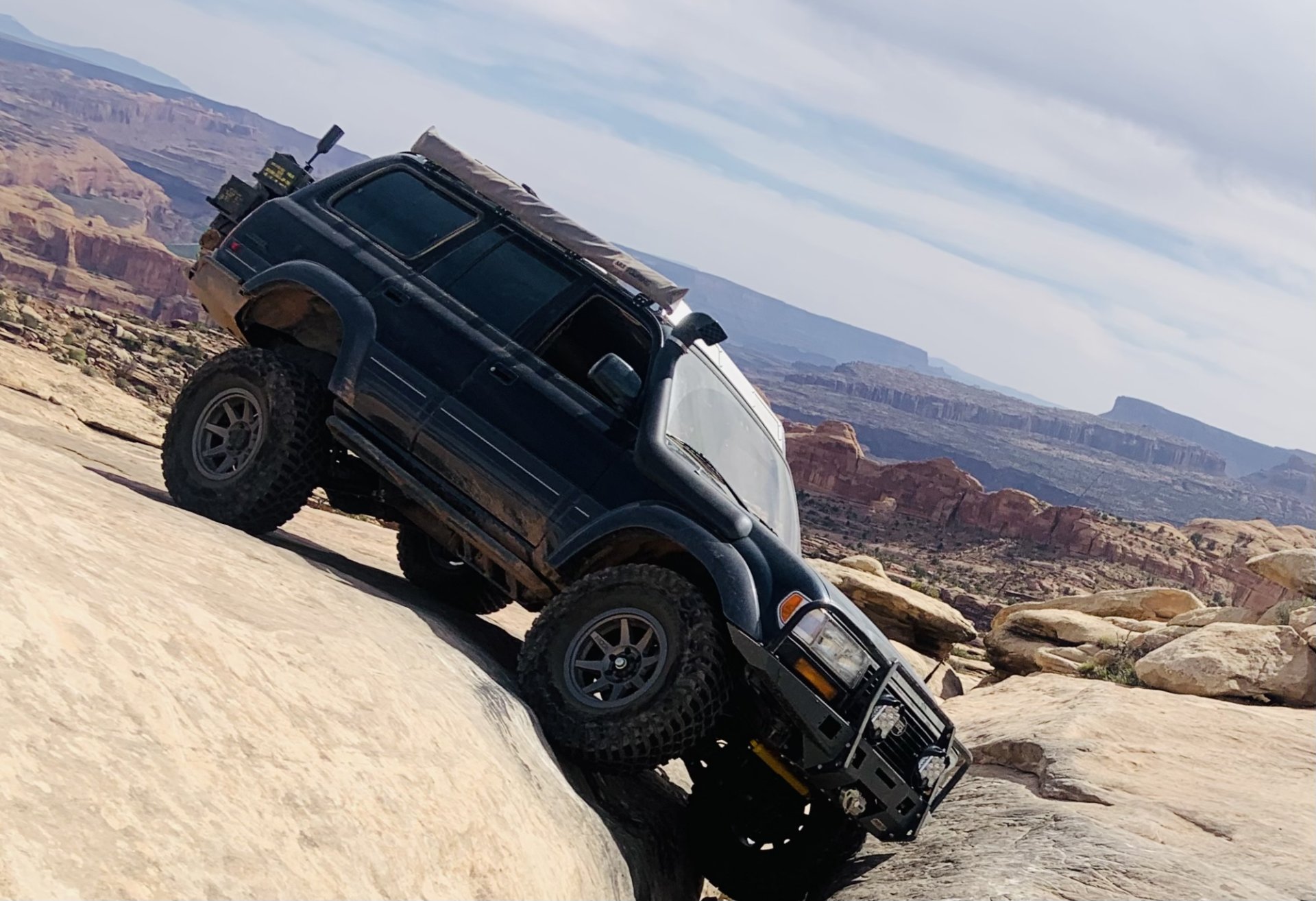

My set up:
4" Ironman lift with 1.5" spacers in the front
Ironman caster correction plates
Ironman radius arm drop blackets
DC front driveshaft
1.25 spacers
17x8 Hutchinson Rock Monsters double beadlock wheels
39.5 Super Swanper IROK
Extended bumpstops
4.88 gears
ARB lockers
3.11 transfer case gears
Cut out front inner fender and about 3" off quarter panels. Was only able to cut about 1.25" off quarter panel in the back.
How do you like the ironman lift?
Any driveline vibes? Caster readings?
Went with constant load srings and they turned out a bit stiff. Handles very well, though. Overall happy with the choice.

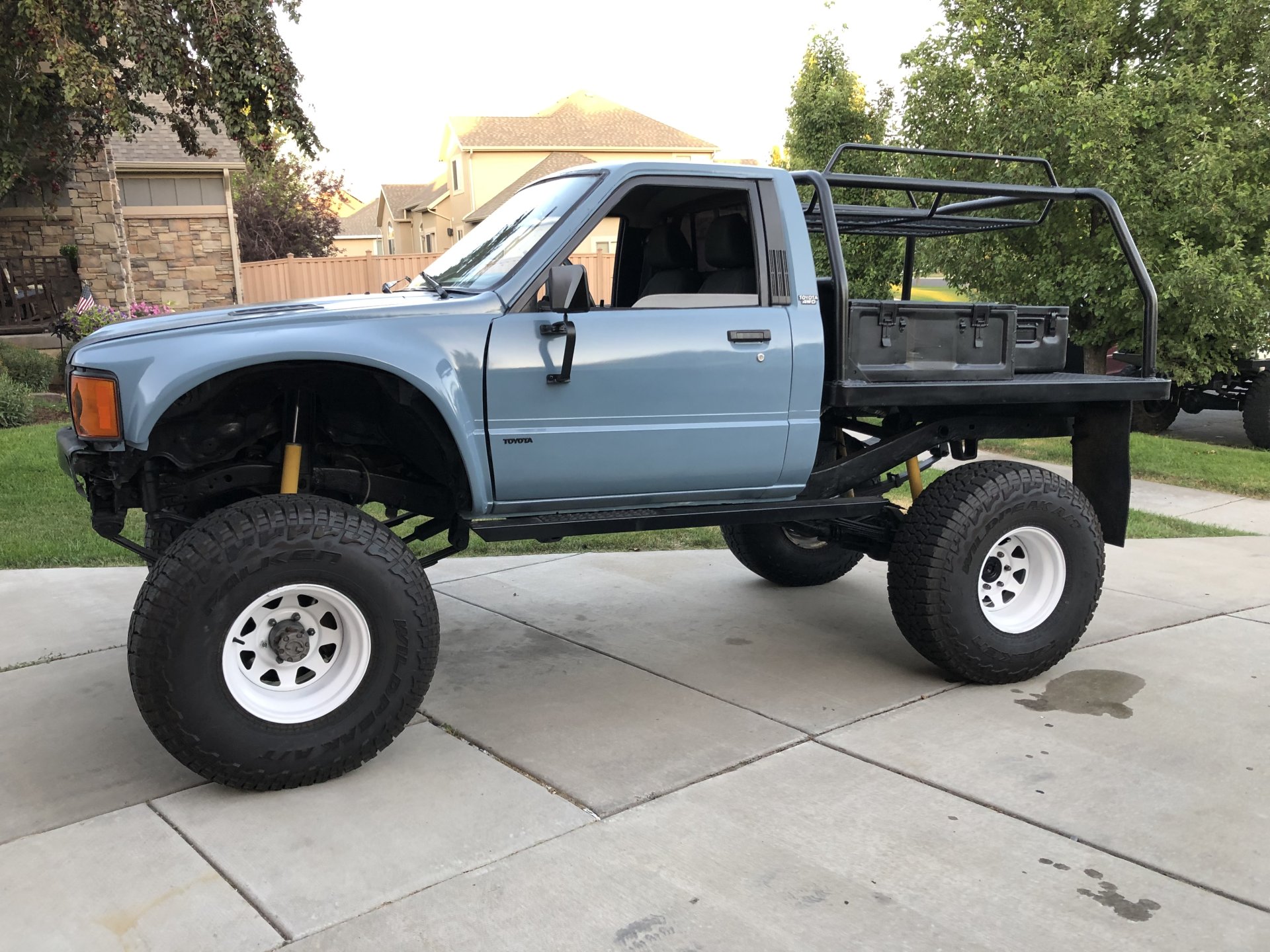

Got out for a quick night run on a semi-local trail to do a little testing with my son and his minitruck (also on 37's). Whole lotta new stuff with his truck 3RZ/W59 swap with dual cases, new suspension with 3" TG fronts and Chevy 63 rears and some Slinky stage4 shocks on custom mounts. He's also got a locked rear Tacoma axle that we just finished but haven't put under the truck yet and a 80 e-locker front diff we need to install. So these pics are still with open diffs. It's gonna be a fun little truck when we get it all dialed.

Great farther and Son project Adam, looking good!!
why'd I think this was getting a 2UZ?
