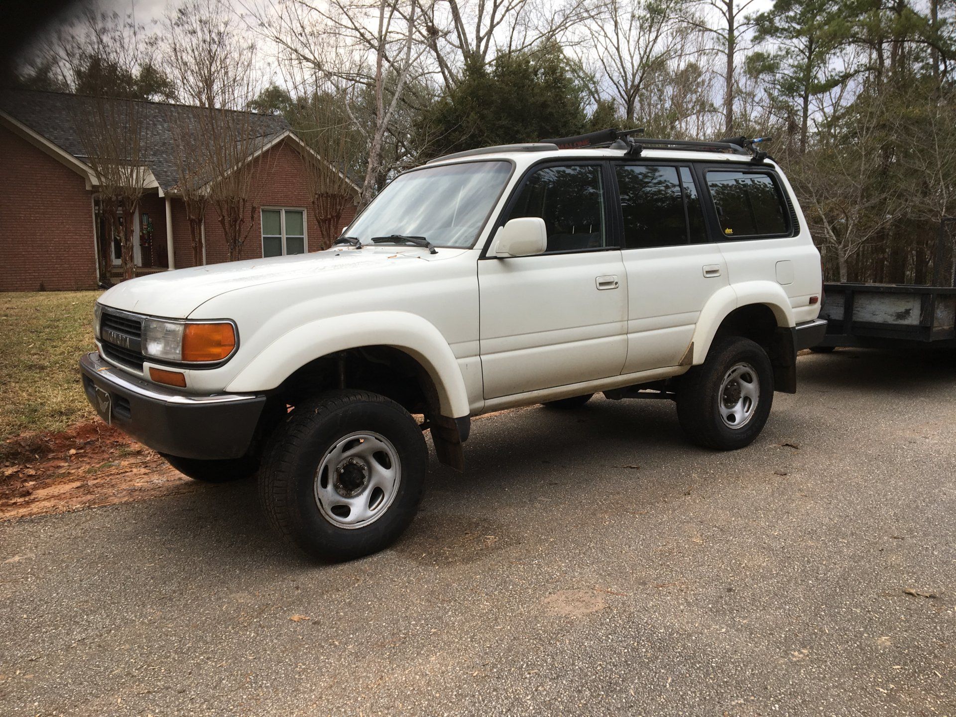

Just another/better angle

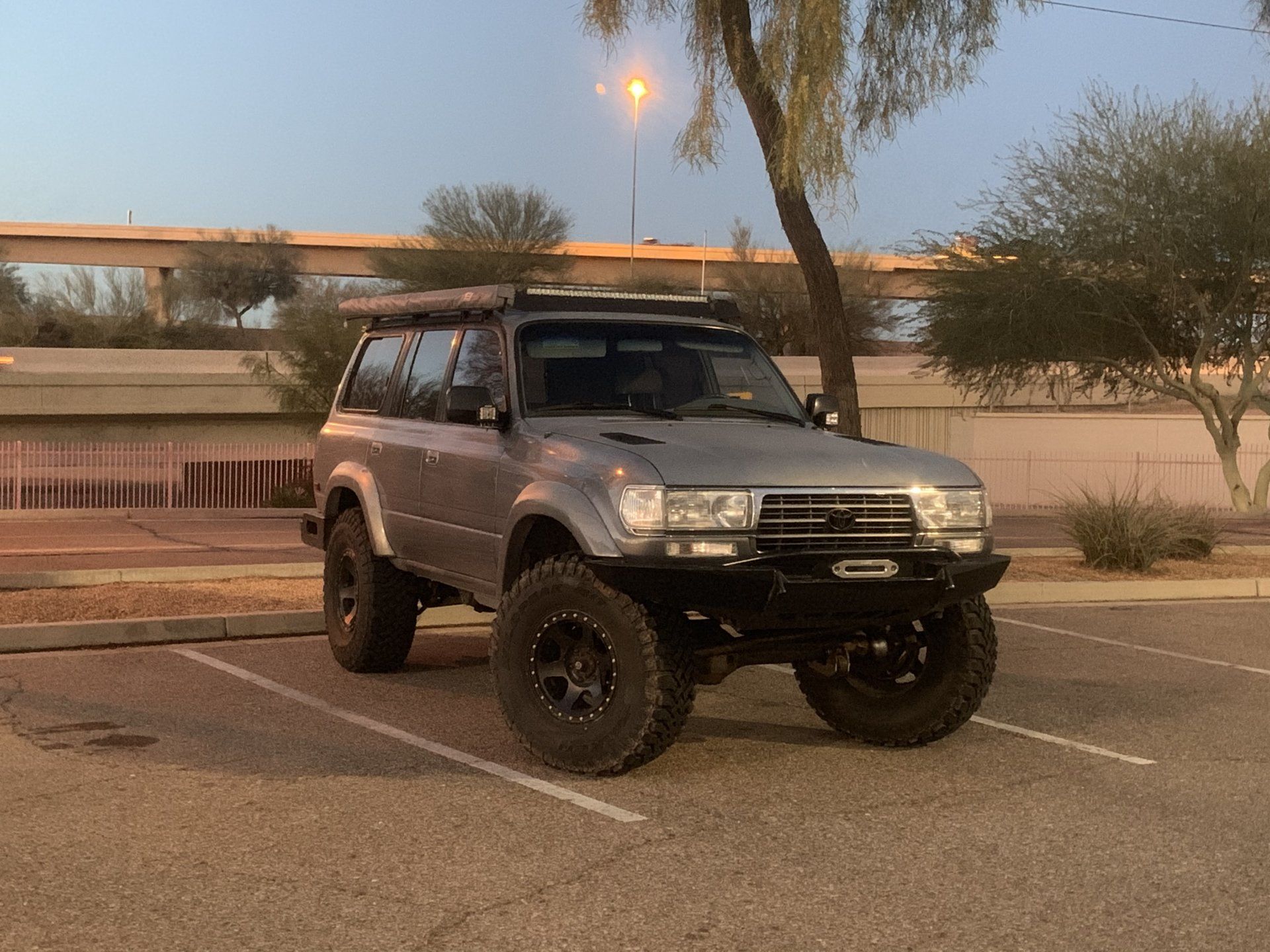

How do you like the stark tires? We can't get them in north america, or they are not common, maybe not DOT rated.
It ride very good.

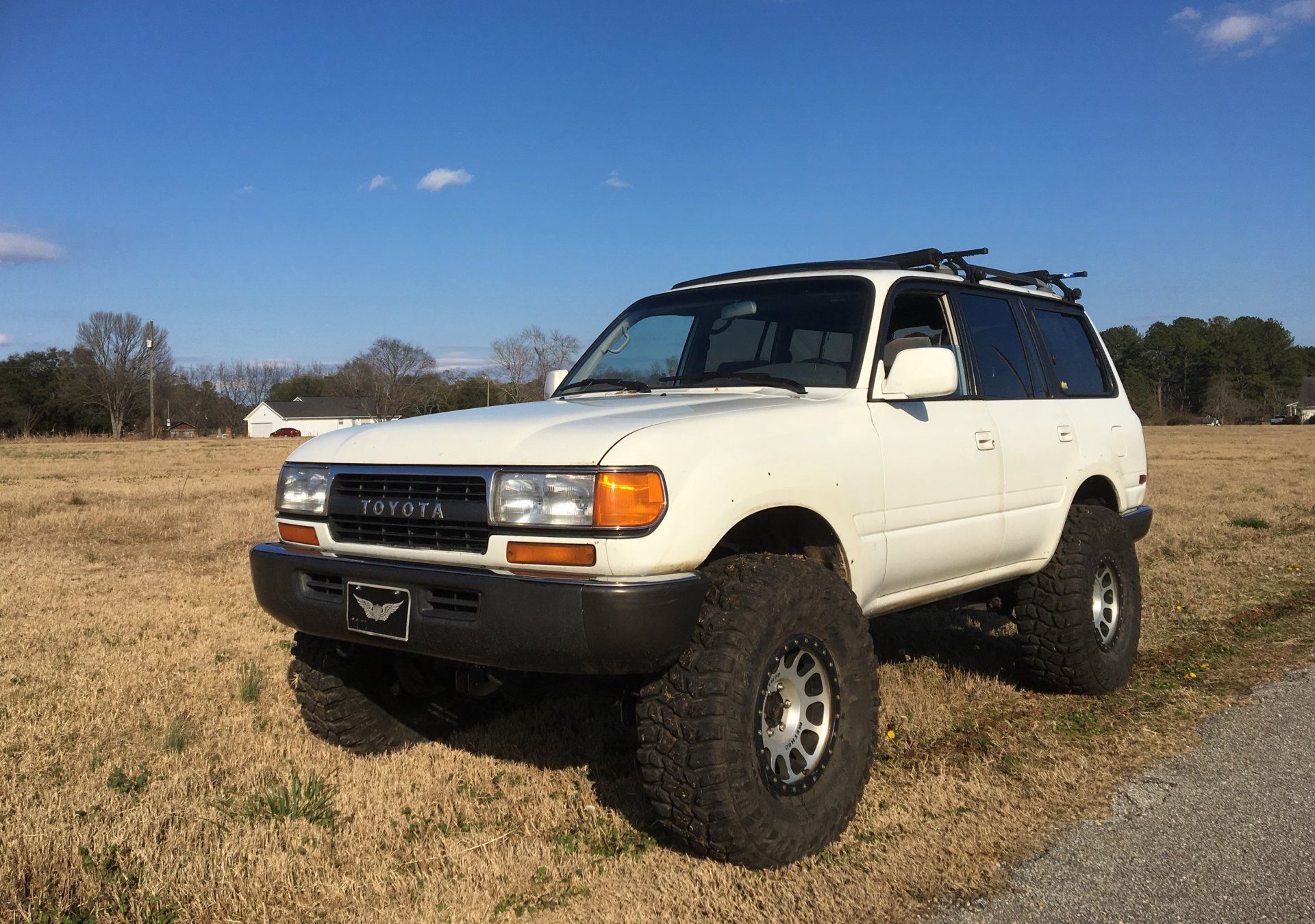

Bought stock with new motor.

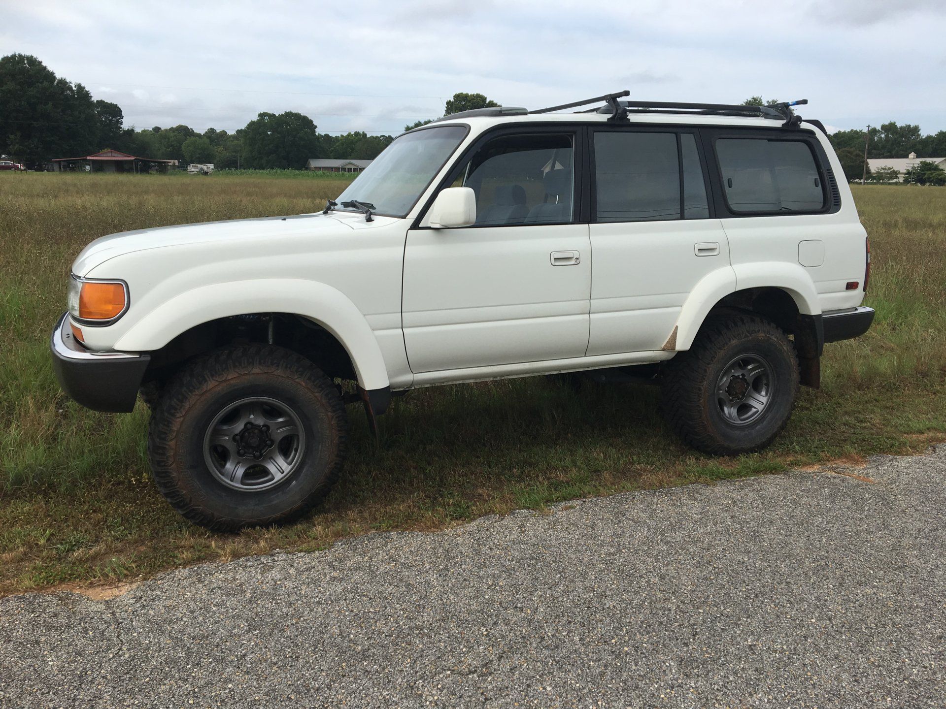

OME J springs and 315s”

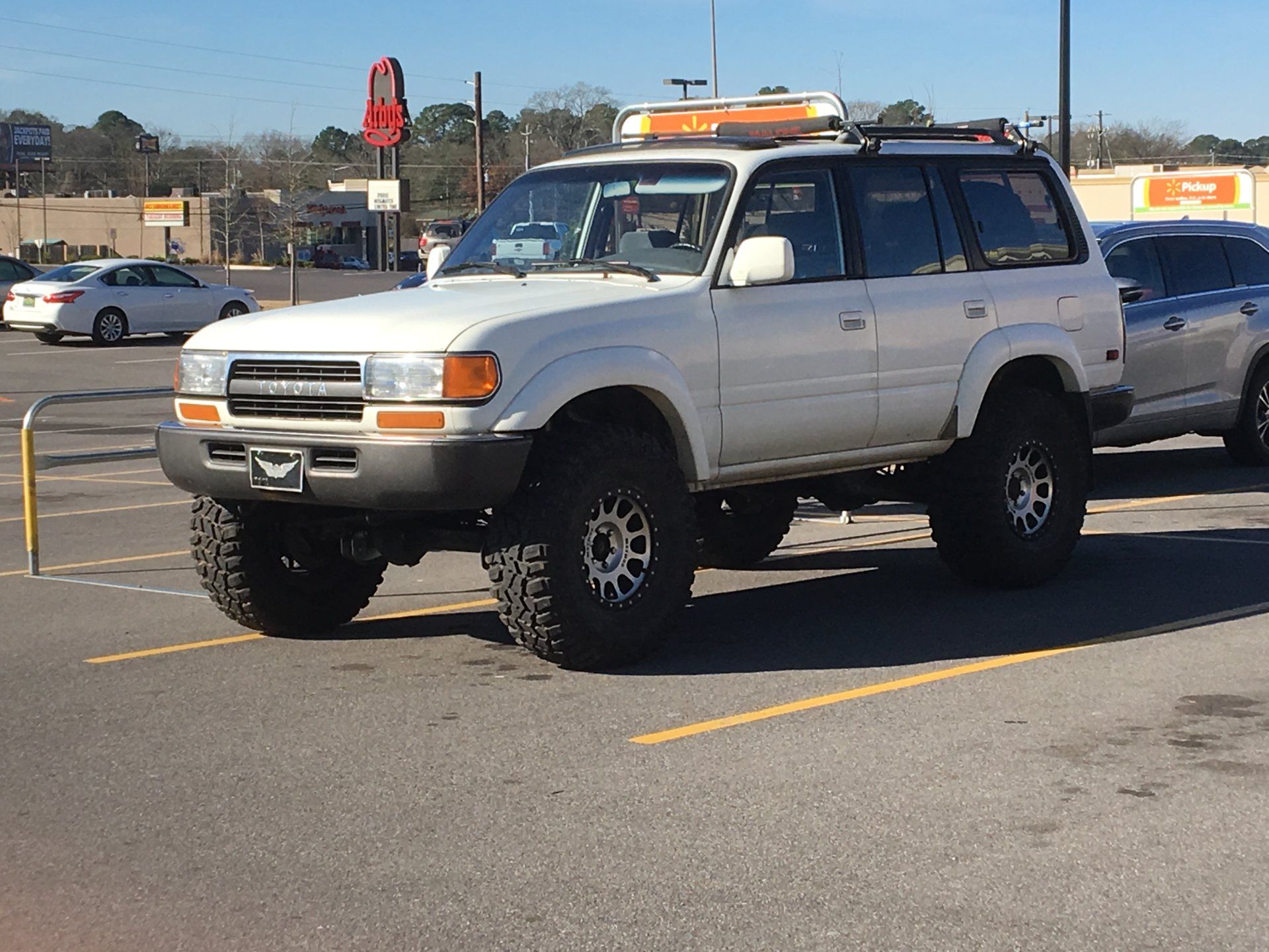

That akward 30” stage when waiting for wheels.
37x13.5x17 Cooper STT on Method NV wheels and 1” wheel spacers.
Had to deflare, still rubbing though. Mostly on firewall.
