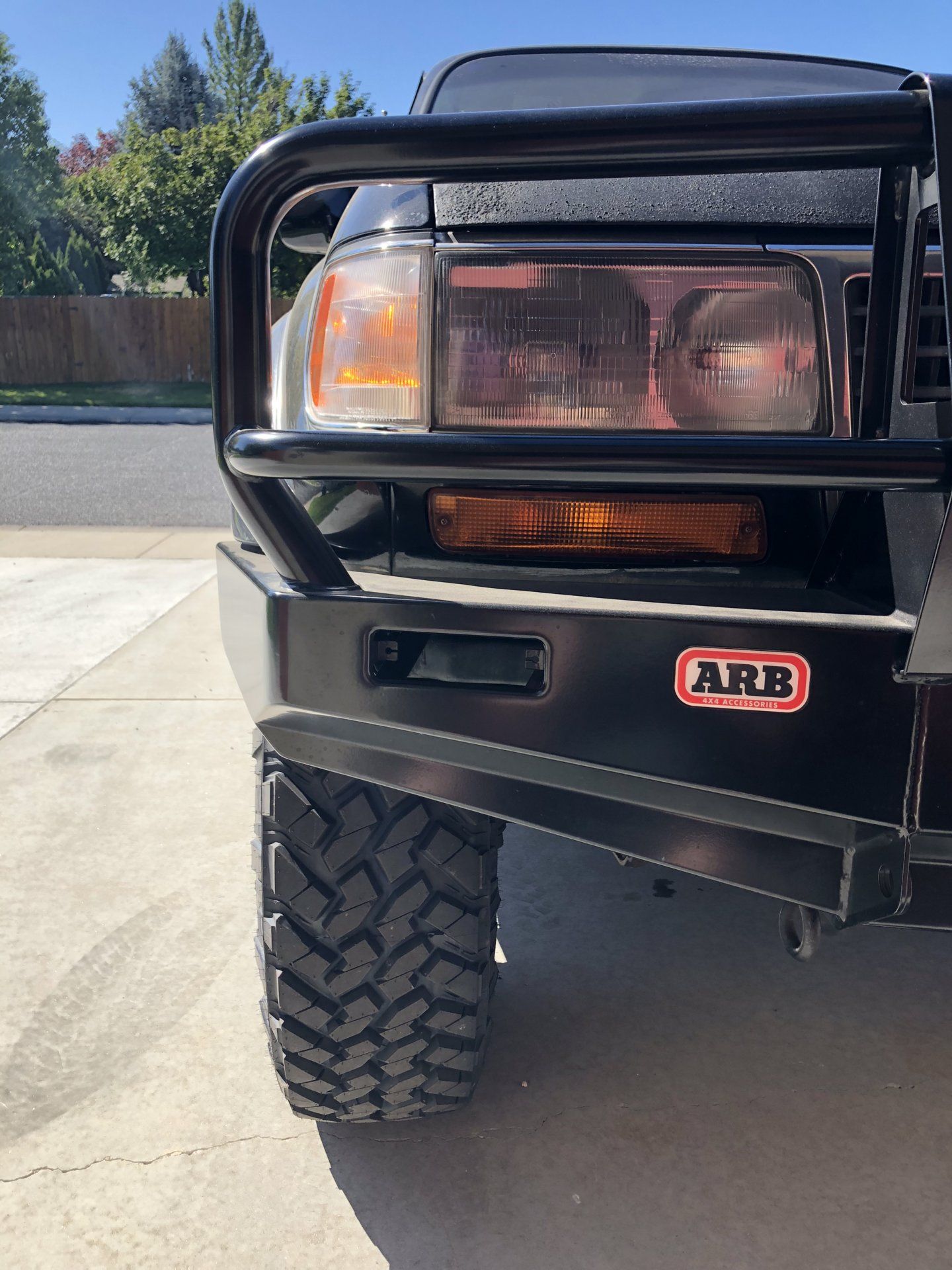

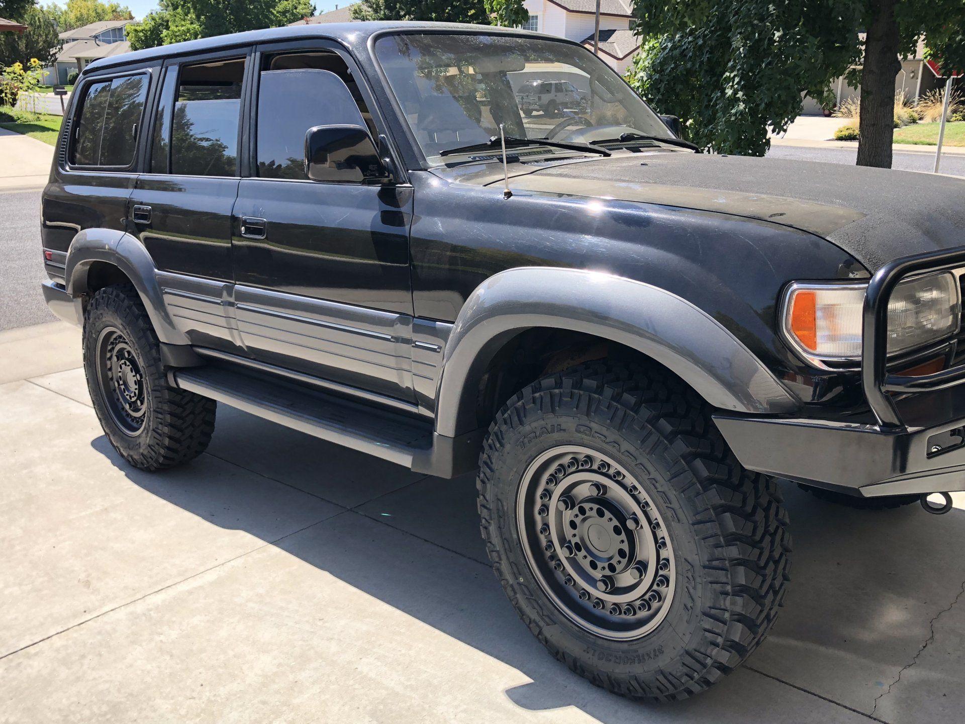

Just got 37’s and 5.29 gears installed this week.
Nitto Trail Grappler MT
37/11.50r20
OME level stance, 2.5”
30mm spacers
Rims:
Black Rhino Armory
20x9.5
+6mm Offset
Daily driving with no major rubbing. Just nicking some of the plastic for the running board trim piece on front passenger wheel well on full turn. Running boards being 86’d and slider installed. 4x4labs bumper on order.
More lift and other related mods are coming. No flexing pics for a while. The slush fund is extinguished.
View attachment 1779109 View attachment 1779110
I was asking a mate of mine about those exact rhino Wheels, his brother had them on his ranger, he had to upgrade his brake rotors and pads because the solid wheel wasn’t allowing enough air flow to cool the brakes. You may end up needing to remove the stone guards or something to allow air flow, or if you find that your getting heat soaked and fading brakes too often then changing to a set of slotted or drilled rotors. Worth it tho, good looking wheel and tyre combo. I love my trail grapplers

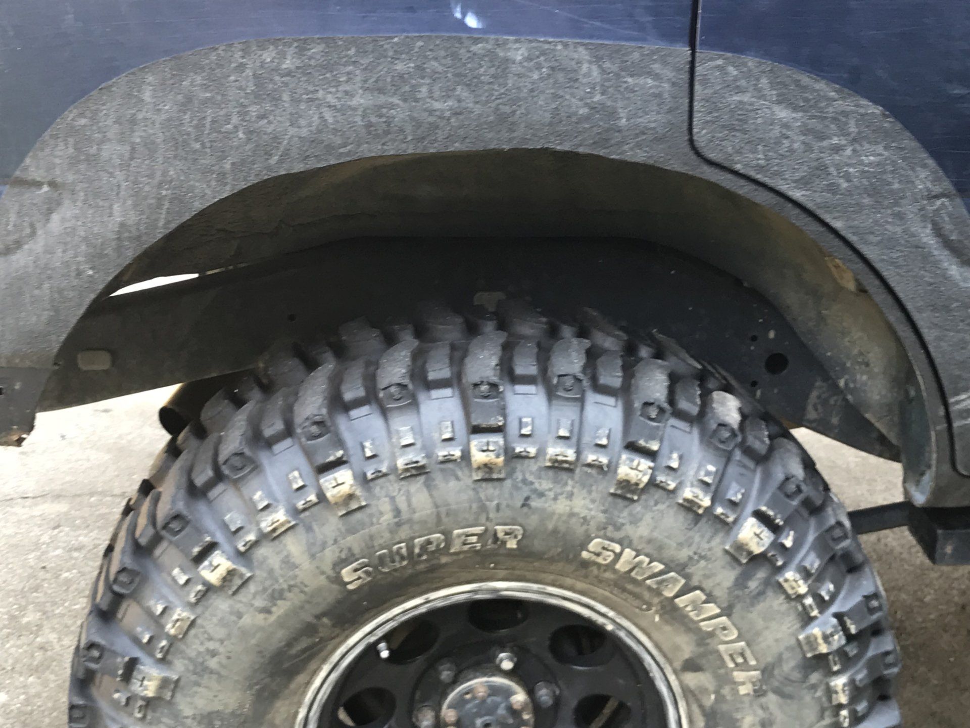

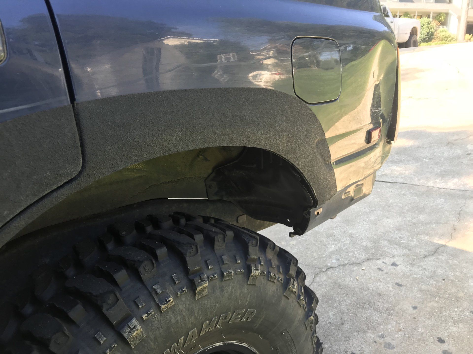

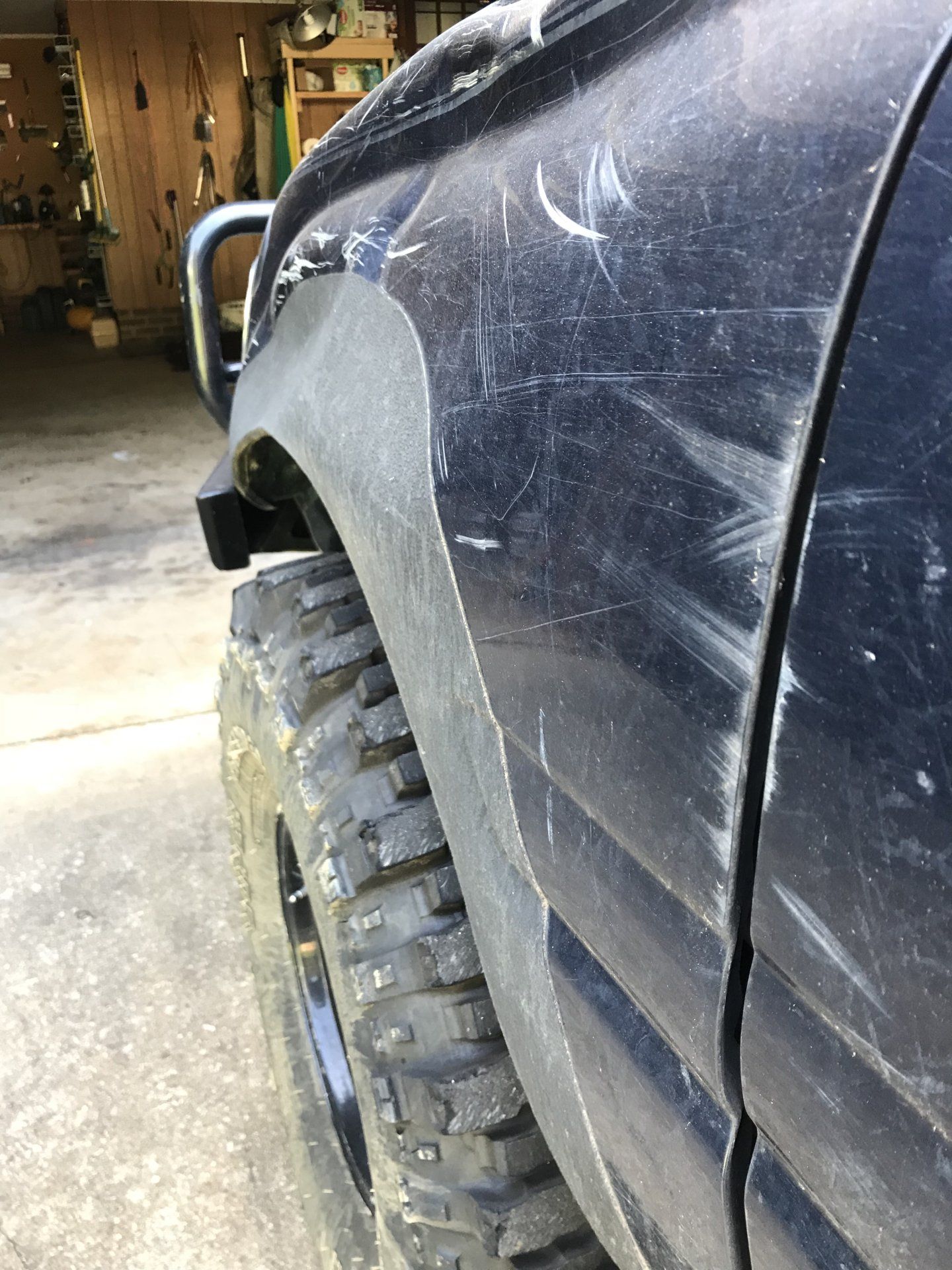

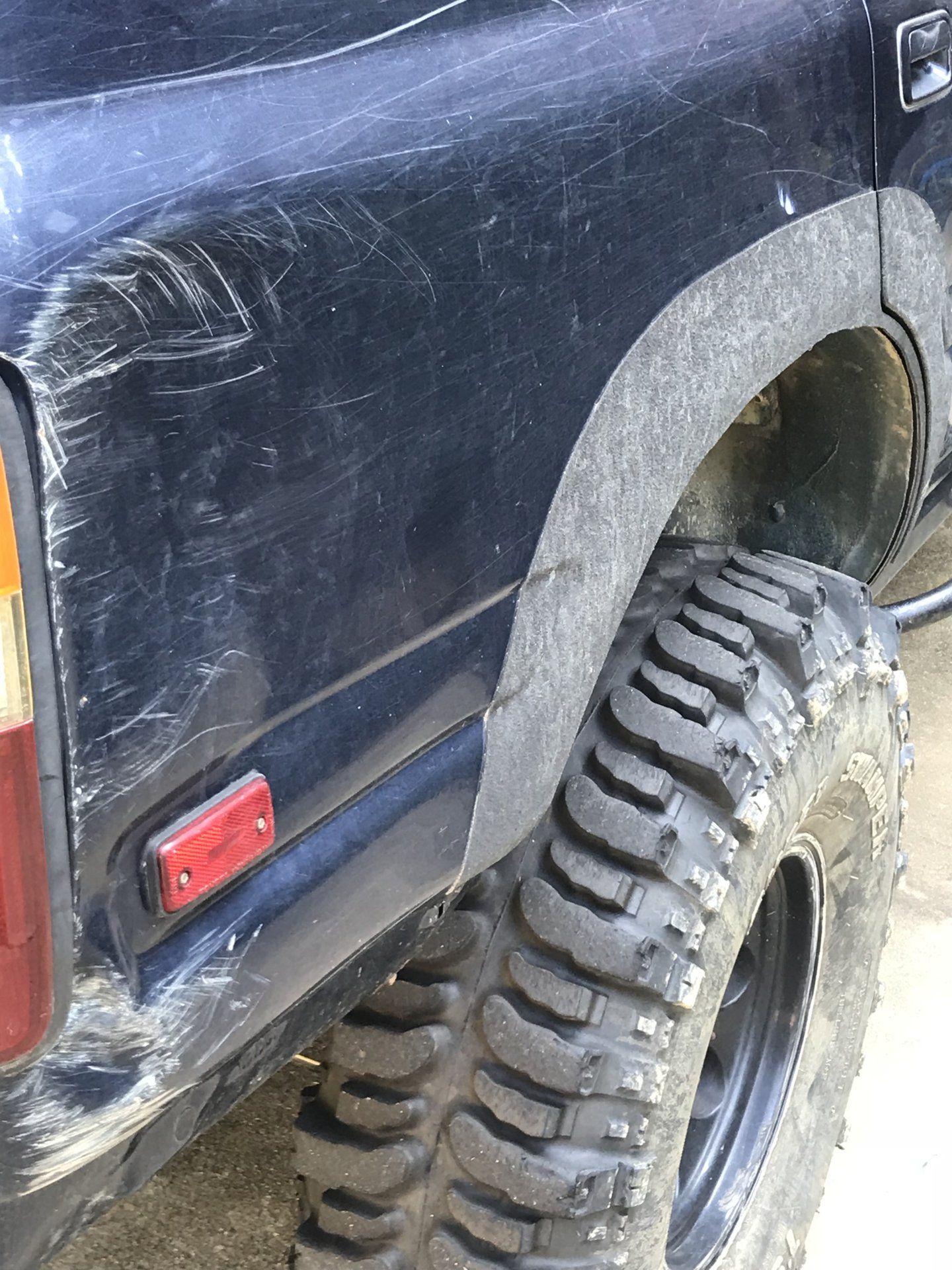

Got my new tires mounted this morning. 38.5x11r16 Boggers. Flexed the suspension to full dropped with front wheels turned in every direction. Only contact was the back of front wheel wells. I cut about a 3 inch arc and pie cut the inner fender and hammered it up. No contact at all now. Can't wait to wheel it.
View attachment 1278479 View attachment 1278486 View attachment 1278499 View attachment 1278500 View attachment 1278501
Got any tips on how you did those flares? I think this is the best way to go flareless.

The factory flares had been mostly ripped off at that point, so I just put aluminum HVAC tape over the holes and liner over that. I need to update this as I’ve had to do a lot more trimming and a few other things since then. I’ll get some new pics up today. Still happy with my tire choice.

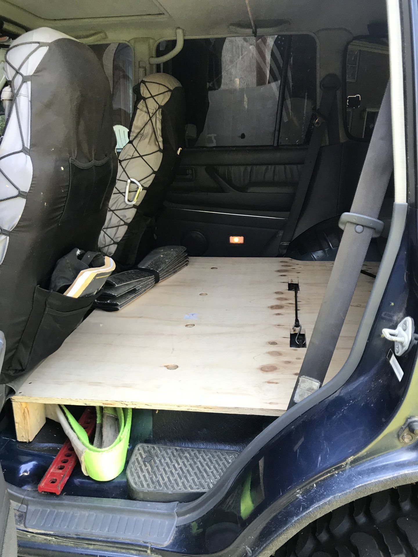

I’m really not sure what direction I want to go with my truck at this point. I kind of want to cut it up and make a buggy, but my wife wants to keep it full body for taking kids and whatnot. Also, she likes to sleep in it. I really do too.
My solution is to keep this truck as is and buy a totaled 80 to chop up, but I don’t have room right now.
Here’s some updated pics. I generally use a jigsaw with a fine tooth metal blade to cut cheer metal. Grinders/sawzall/multi tool for hard to reach spots.

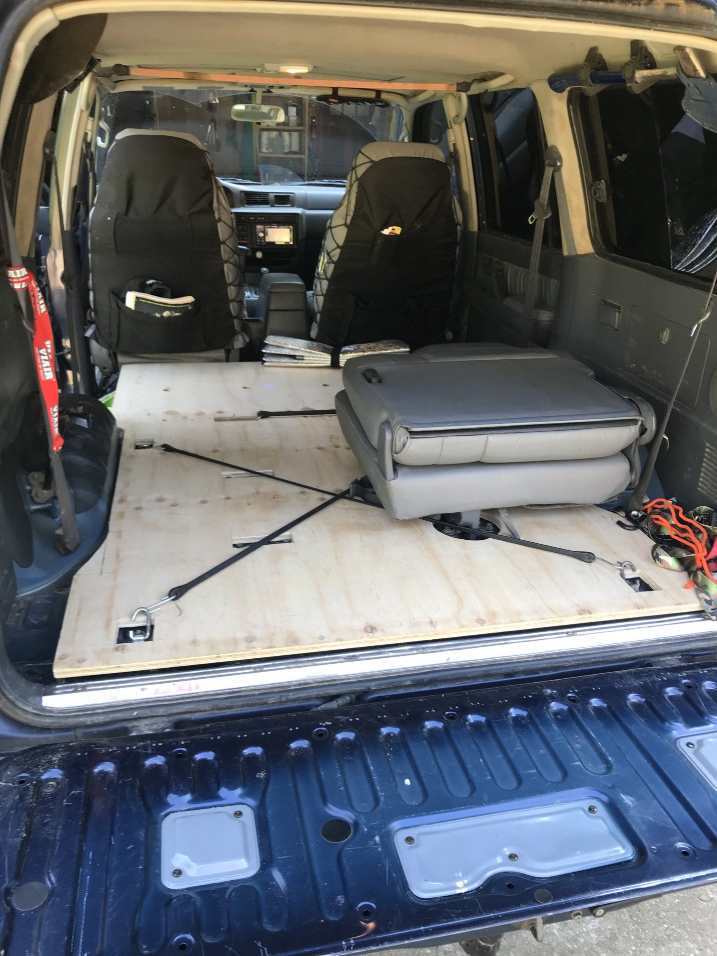

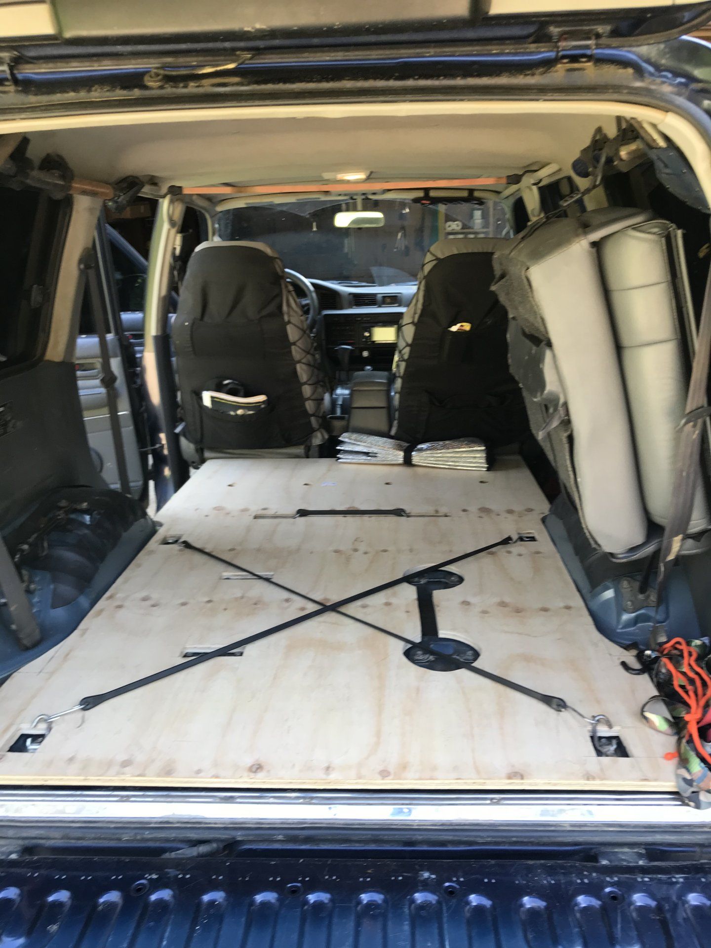

I’m also trying to keep things as light as possible, so my interior is stripped and I keep a third row seat in for my son to sit in, but I can fold it up and have a flat space for us to sleep on.
Hard to tell, but plenty of clearance in the front all directions. No sway bars front or rear.

Whoa! What weels are those? Sorry if i missed that part.
I like 37’s but not a big fan of wider than 12.50 and 11.50 would be even better! But I already have 17’s and 5 of them, so not likely to buy something new.
Your wheels look like military 3 piece, Bad ass looking. Makes me think it needs a 6bt under the hood, 12v flavor!
Wheels are Black Rhino brand. Style is “Armory”
Armory Truck Rims by Black Rhino
