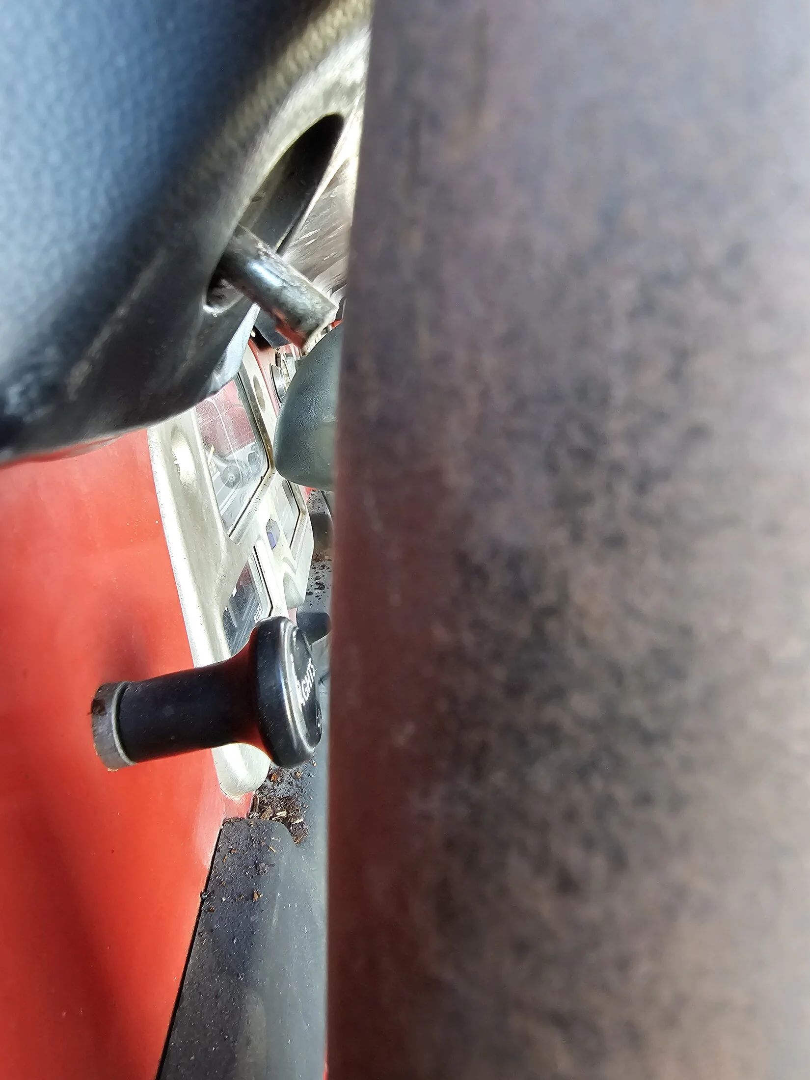

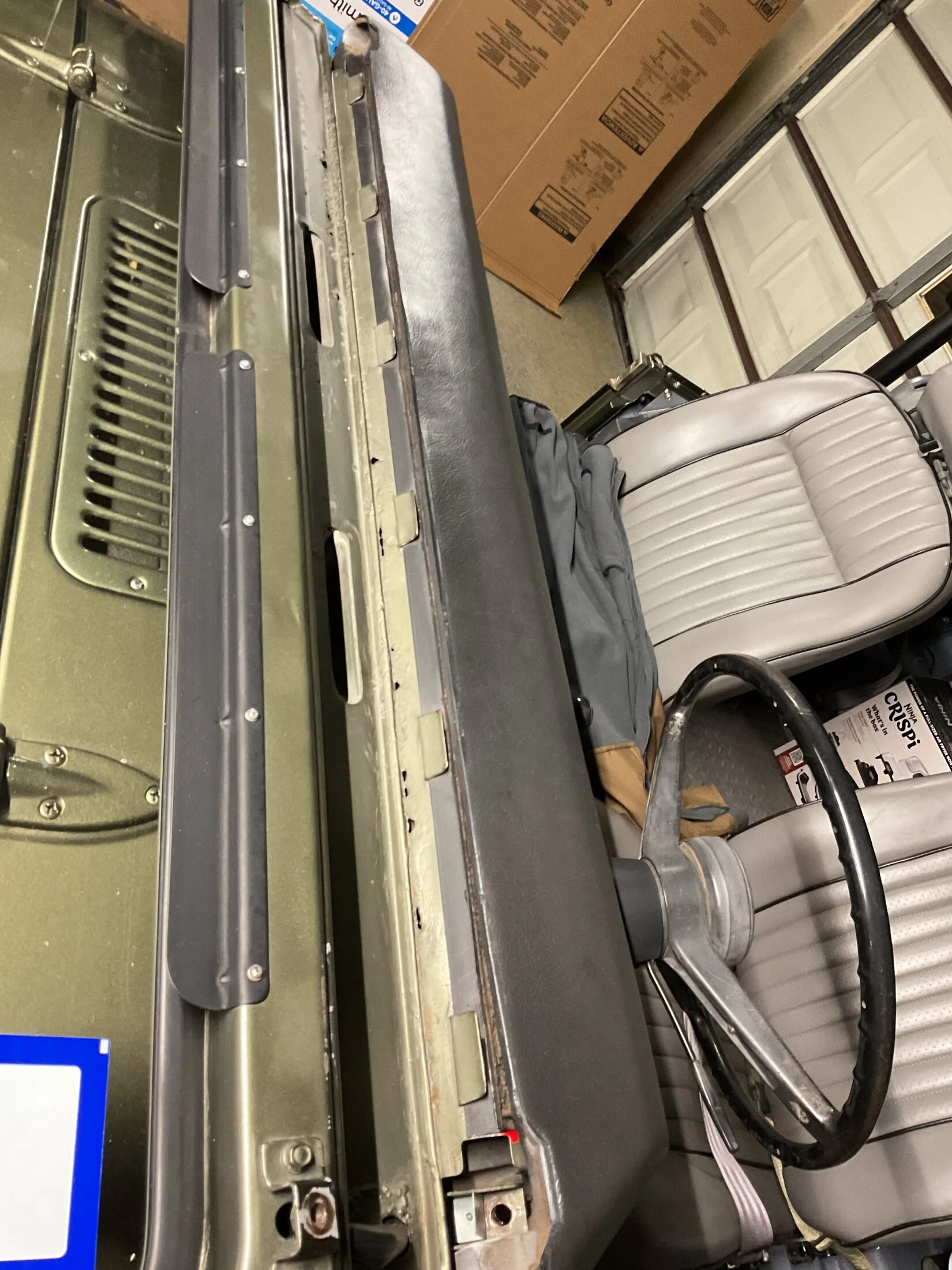

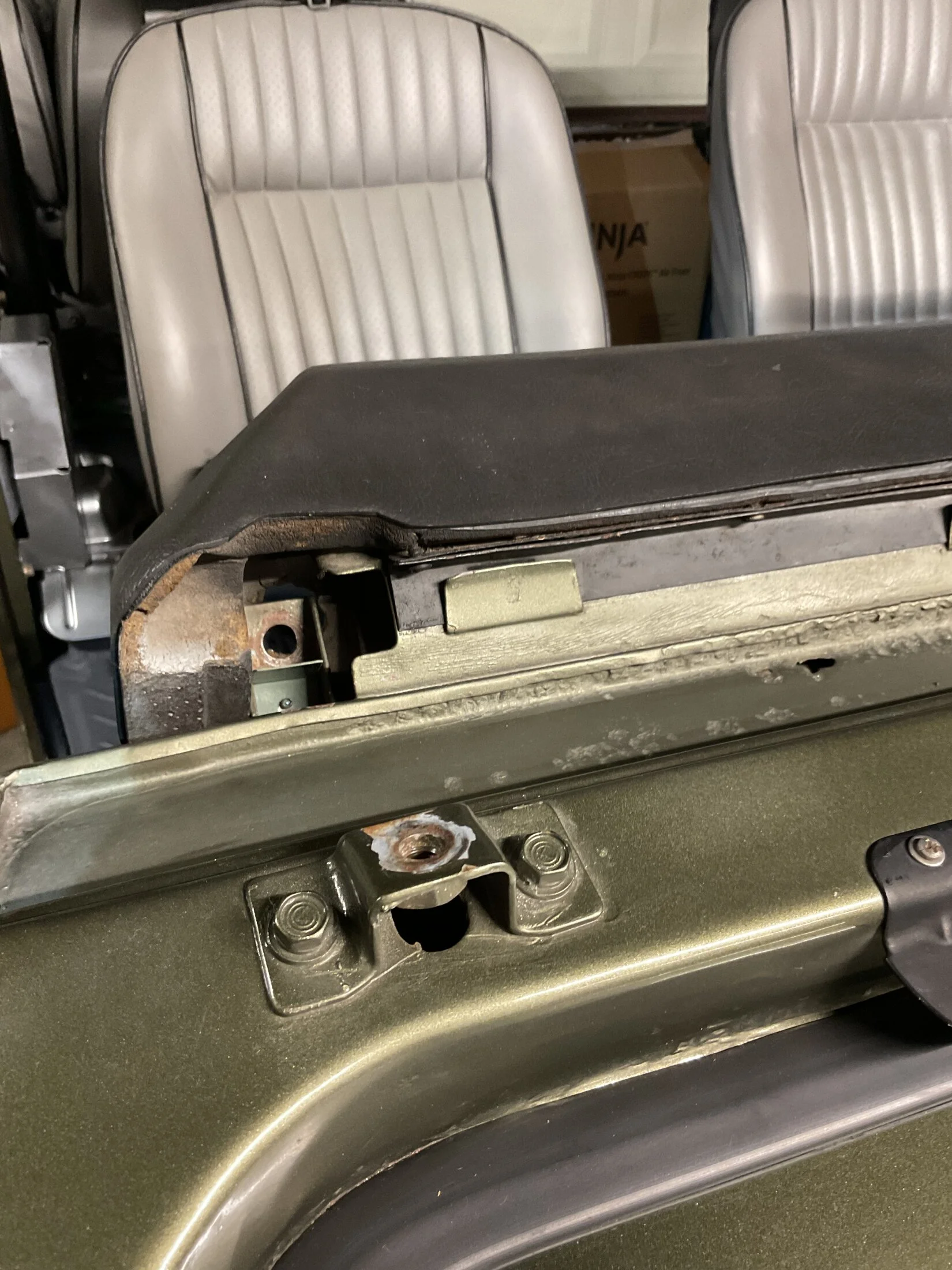

You have to drop the windshield to remove the screws that help hold the pad in place. There are brackets that the knob screws, screw into that are bolted to the frame. I keep my hard top assembled.
Does anyone have a tutorial on how to remove the dashpad without destroying it?

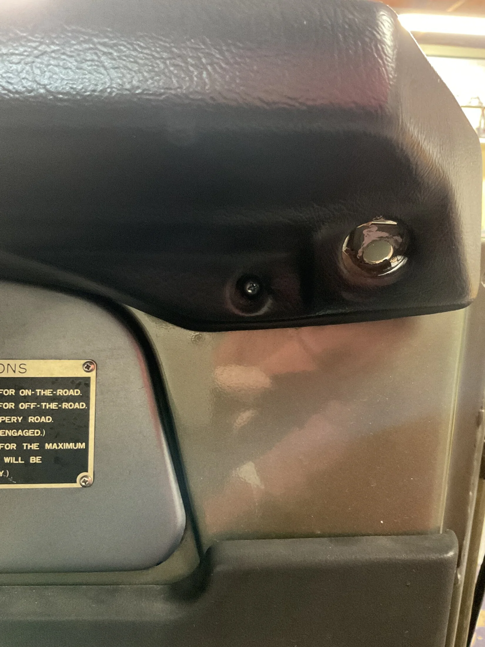

Also, the knobs for the windshield are seized. I've been soaking them with some penetrating oil but they don't budge. 1 is missing the plastic knob.
I tried a pair of vise grips on the right one to try to work it back and forth but it's not moving.

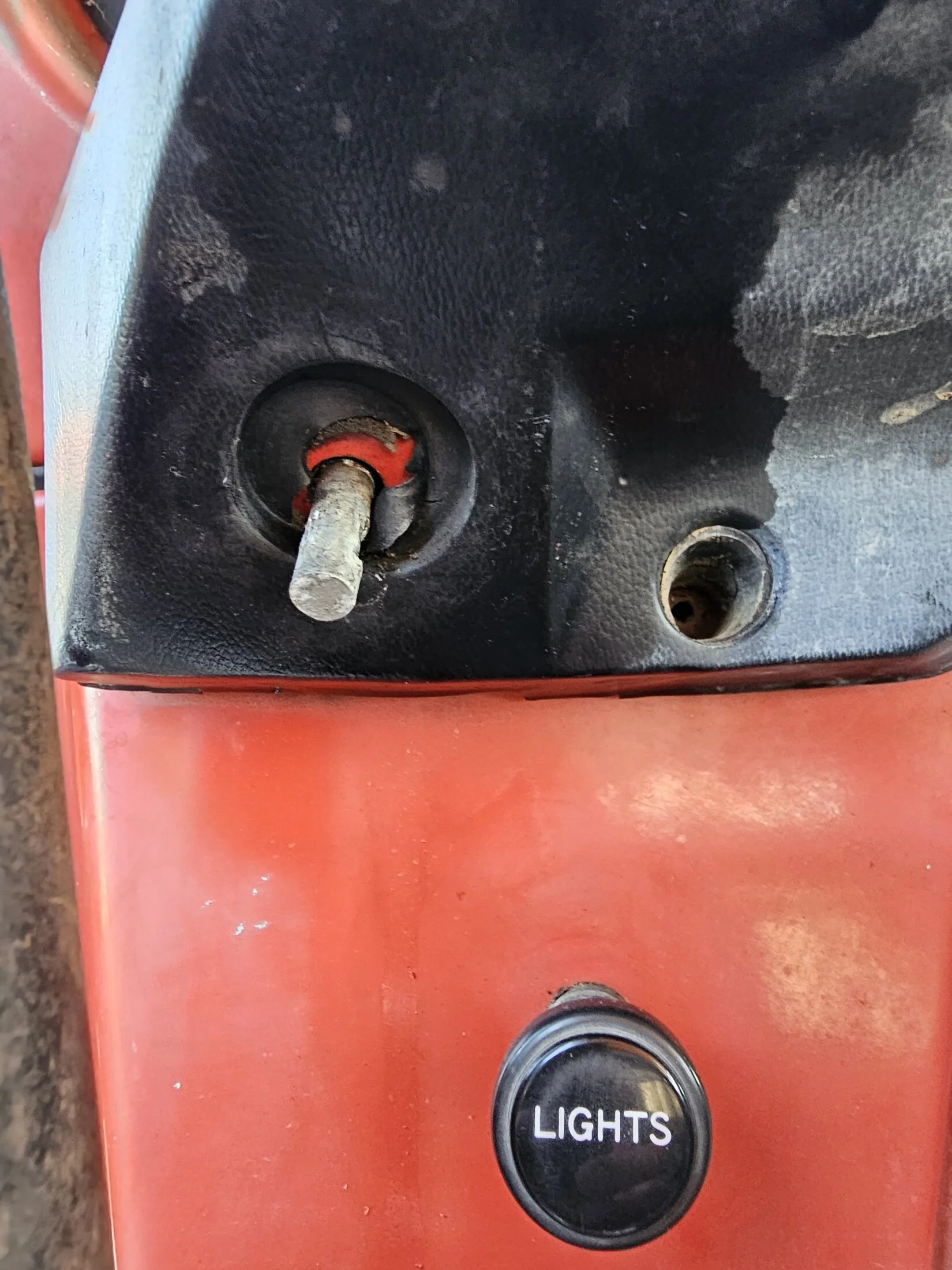

Here’s a few detail photos of what you have. This is a 1974. The windshield knob bolts are long, and tilted up, so there’s a good chance that your penetrating fluid isn’t reaching the threads. The dash pad is secured with 5mm machine screws across the bottom, and the top is clamped in as indicated along the length. You might have to remove the hinges or hinge pins to get the glass folded down. :-(
A lot of people swear by products like WD-40 and PB Blaster. For the most part on everyday tasks they work but some jobs are beyond their capabilities. That is where Kroil comes to the rescue! Don't get me wrong, I have my WD-40 but when it fails I break out the Kroil.

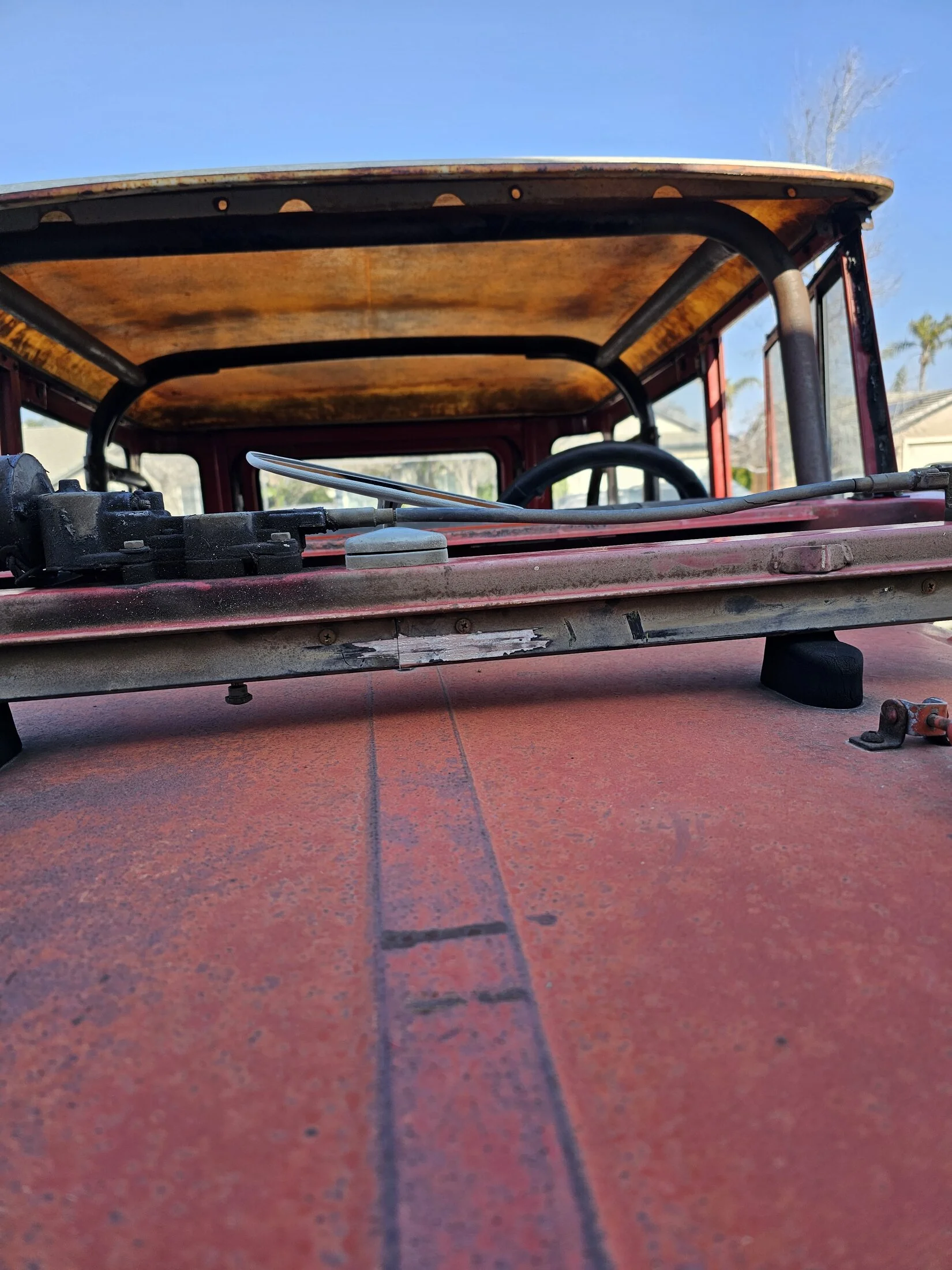

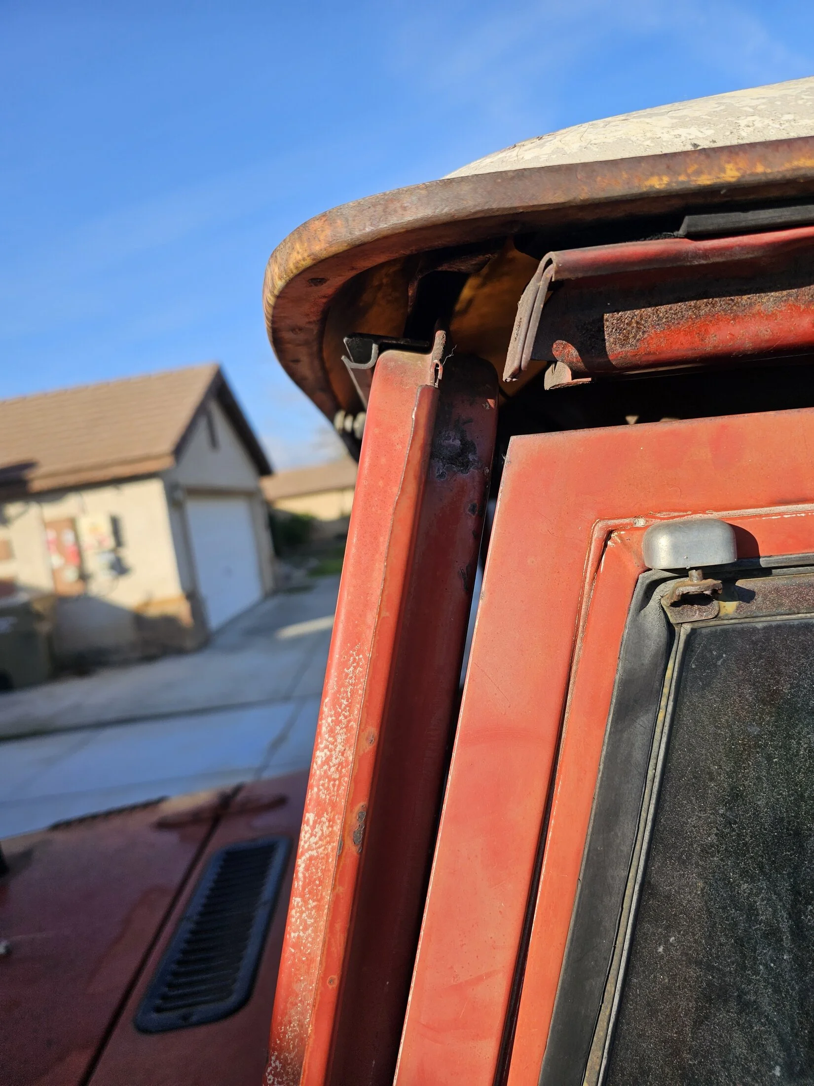

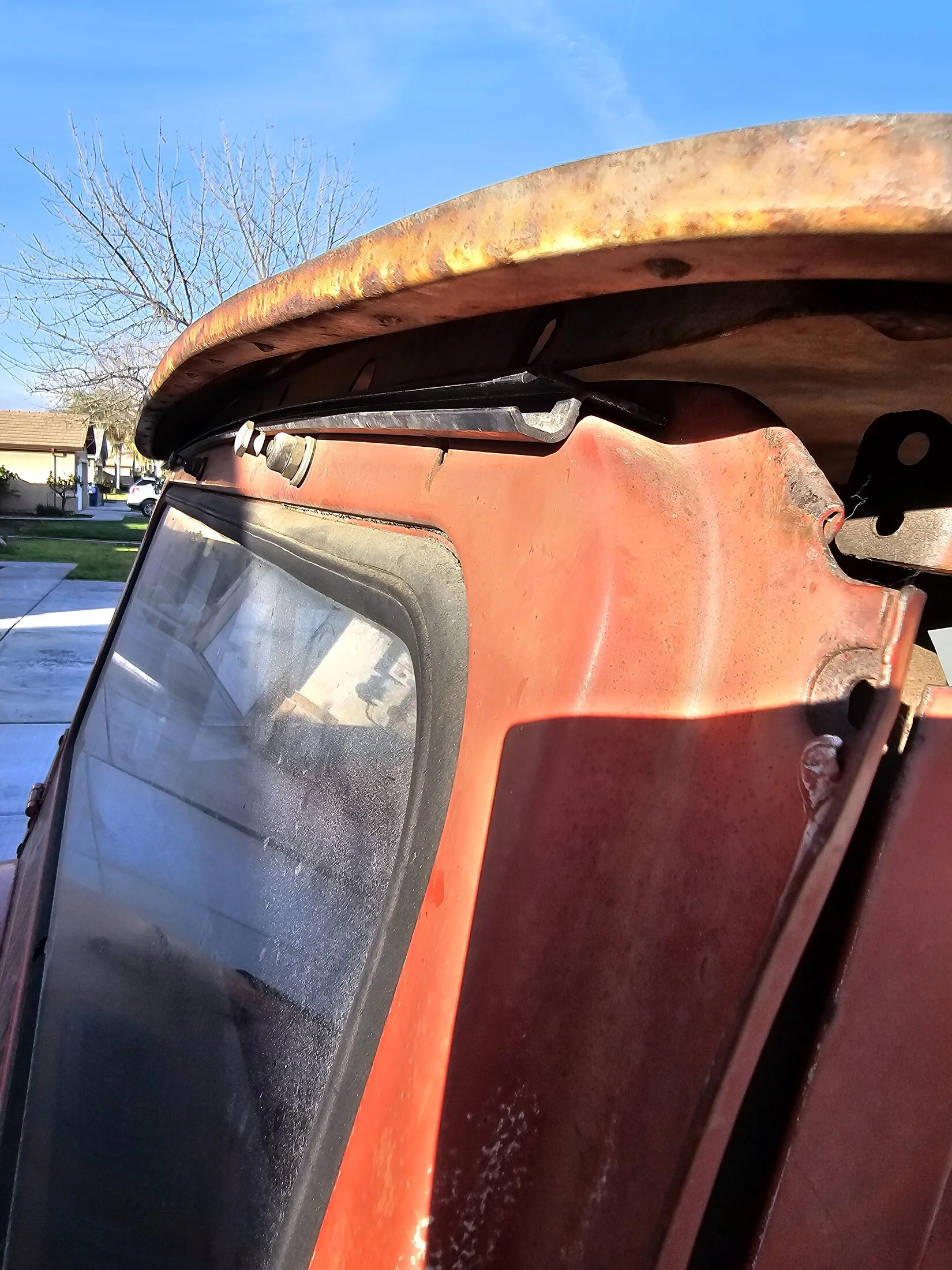

I need to lay the windshield down to remove the insert for the soft top that was left on when the PO set the hard top back on but now it wont sit flush and rattles a lot. I guess I could remove the top, sides and back hatch piece by piece. How do you all store your top, sides and doors when not in use?
The bikini top bracket is on the front windscreen under the hard top. Take that off while hardtop is on. Weather stripping goes there when top is on. City racer is your friend for 1974 weather stripping . Check Toyota. I think back hatch is still OEM and a few other piece too.
