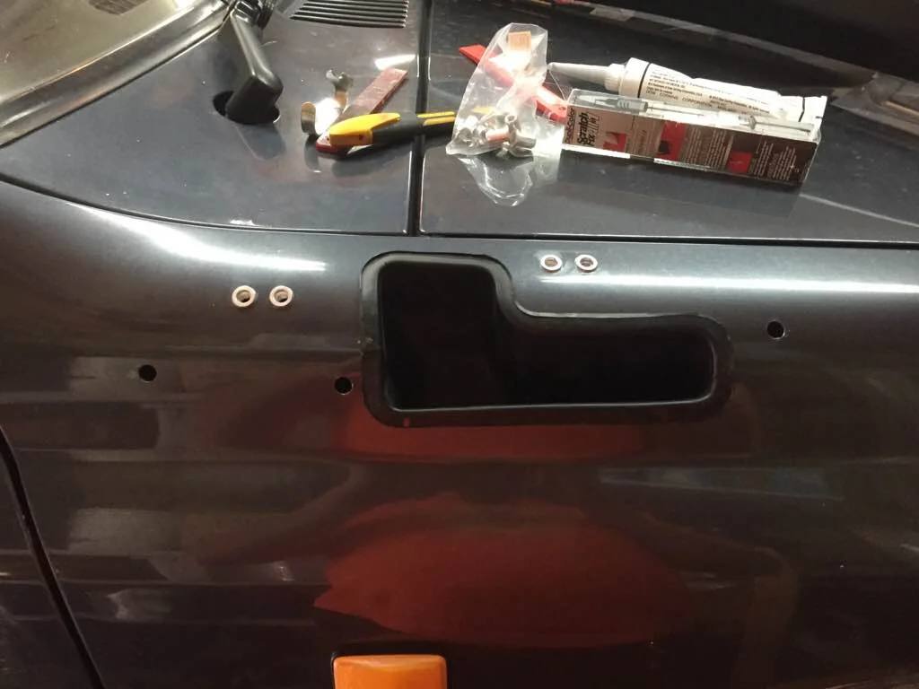

I will on my computer....feel free to msg me with any questions...template works great! Yes two of the 9mm are out a bit and I didn't use any Pop rivets, all rivnuts

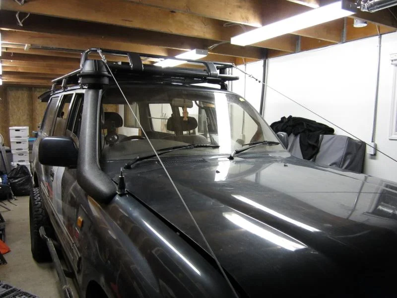

Nice thread. Wondering what you guys did to relocate the power antenna, or did you go another route?
It's sitting in a box of parts in my closet. =)
We exclusively listen to music from our iPhones in the car.
I did an antenna that stuck to the windshield and I grounded it to the A pillar grab handle screw. It was just OK. I had a Jensen rubber antenna that I was going to mount next to the snorkel but never got to it before getting rid of my 80. Why not drill another hole when you have already cut a funny hole in the fender.

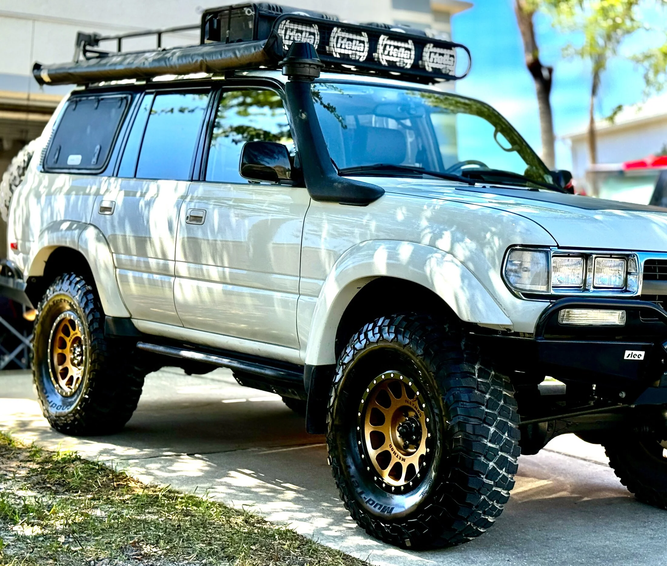

I'm looking at an 80 series that has this snorkel on it, holy s*** this is the ugliest snorkel I've ever seen. Yes, raising a thread from the dead, but holy s*** do you guys drive your 80s with this snorkel around when you're not headed to the trail? Seems the installation creates swiss-cheese in the fender too. Gross.
I think I'll end up passing on this 80, it's perfect except for this asshat snorkel installed on an otherwise stock, unmolested rig.
Okay cool.
You can un ugly it by swapping out the radome topper for a 70 series cyclone hat…that’s what I did
