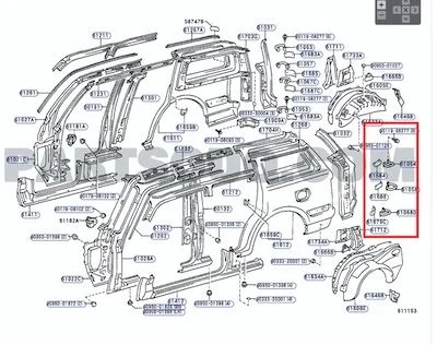

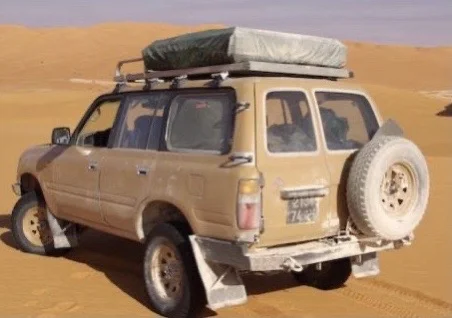

Been searching for roof rack side steps, like these. Looked through HZJ, HDJ, and international FZJ 80 variation parts schematics, and nothing is popping up. Are these just dealer or aftermarket add on? If so, can someone point me the right direction?
They are OEM but only certain places have then internal reinforcements for the steps. The US did not get it.

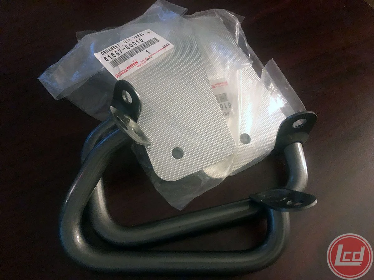

Ok, found them, thanks! 3 different sizes
Buttom:
STEP SUB-ASSY, QUARTER PANEL, NO.3 LH 6106860010
ORNAMENT, QUARTER PANEL STEP, NO.3 LH 6167960011
