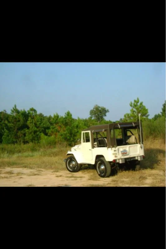

important here is to consider how itll be secured when sides and rear are rolled up....ive found the twist fastener/grommets on the side skirts undone before not intentionally (although little fingers may have contributed)....i wouldnt like it as a possibility on the corners with sides and rear rolled up....the corners will take a bit of wind as well so personally i like the straps....i do believe there are other ways however....some of this depends on how youll use your vehicle....my sides and rear stay rolled up so straps on the corner make me happy and its a no brainer to look and know its secure....
a picture of mine with sides and rear rolled up...
edit: on another note ive often wished for a quicker way to open the rear curtain short of undoing six buckles....twist fasteners would be quicker but youd loose the ability to cinch down the top to snug it....with twist fasteners youd have to pull the top (and at that point youre pulling the length of the top) with your hands to get the grommets lined to the fasteners and it will only be so snug to allow that....buckles give you pulling power/leverage past that...
