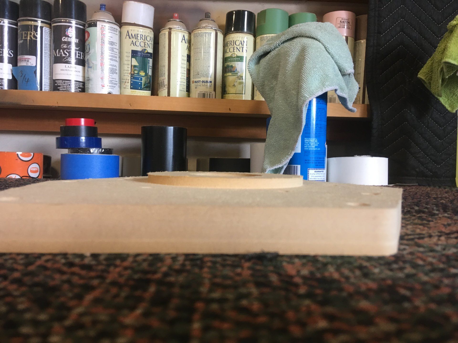

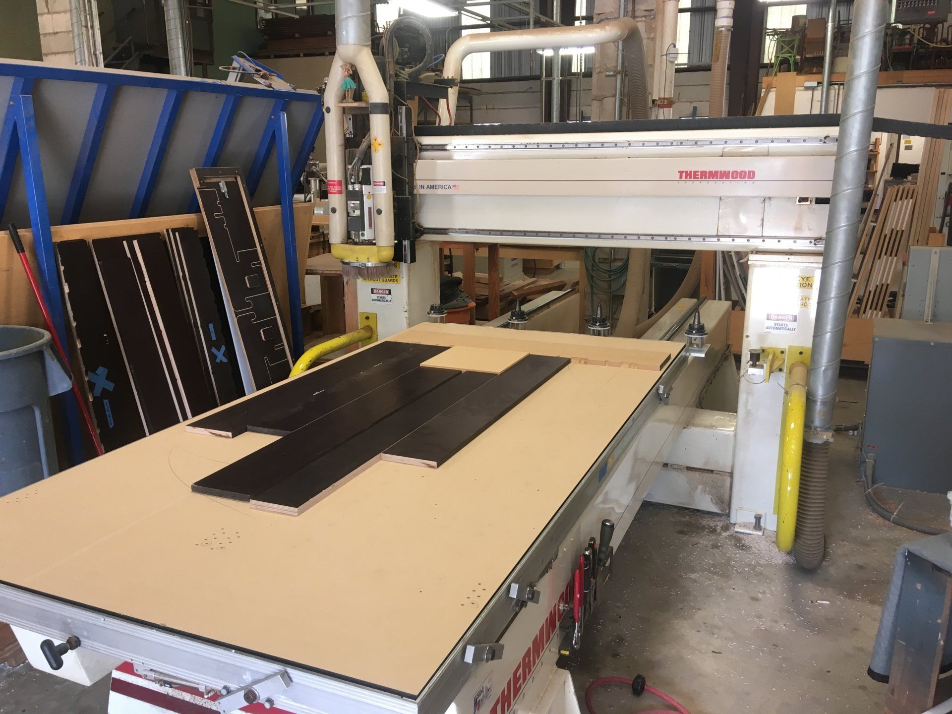

Cut out a very basic adapter today out of MDF on the CNC. Test fit tonight before cutting the high dollar aluminum.
Pimp Cim. :clap:
Sometimes it pays off to work somewhere that has cool stuff. Too bad wood and plastic is all we can machine. We have done 1/4" aluminum before but that is about all our machine can handle.
View attachment 1820369 View attachment 1820370 View attachment 1820371
Awesome!
I would pay careful attention to the areas circled below. I believe @lostih said that some material needed to be removed where the adapter plate contacted the t-case.

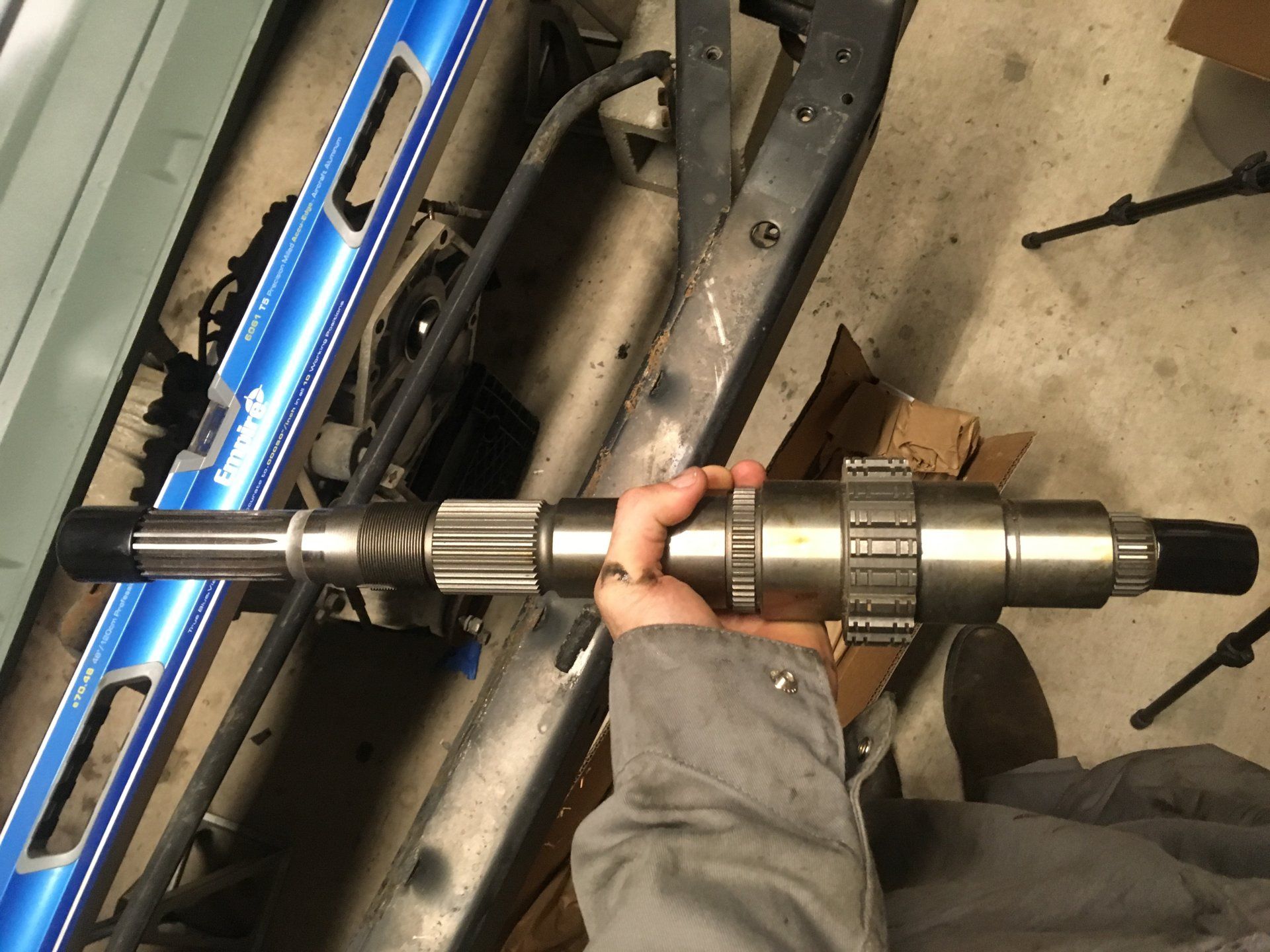

Split case 19 spline gear fits trans output. @Will Van if you want I can send in the gear with my main shaft if you have Dutchman confirmed. Maybe if we have several of the same work they will be more inclined to do it.
I also have NV4500 4wd tail housing and the HF2AV separated if anyone need measurements. Time to contact my friend to see if he still wants to make the adapter.

Just to clarify, are you saying that the 19 spline shaft that would go into a split case (like from an H55F) is the same spline as the shaft from an A440F into an HF2A?
I've been back and forth on ordering the adapter plate and modified output shaft, with creating a one off adapter to work off the adapter I have from AA to the split case. With that I could just chop the spud shaft down and do a one off plate to mate them, as long as the ouput from the trans matches the input to the HF2A

Yes it seems that way. If you figure out how to adapter the AA adapter kit that would be awesome because the 80 is next in line to ditch splitcase.

I believe he is mentioning the input gear to the HF2A in relation to the shaft from the ouput of an earlier trans that would go to a split case.
I don't have the parts to look at without dissasembling equipment, but I believe his perspective is that the splines have a different angle to the faces. To really see you'd almost need to cut a slab off both output shafts from a 4 speed manual case and an A440F out of an 80 series.

Not really. Will sent in his input gear with his and they did ours at the same time. Ended up being $212 or something like that with shipping. I will probably get another one done at some point to have for for the 80.
