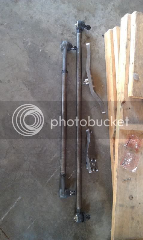

hi steer came in. MAN is it beefy. now i need to send out my spider link to get bored out to accommodate the larger tie rods.

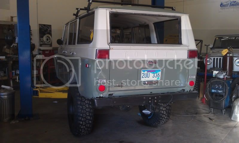

Well starting today should finally have some progress on this. Dropped the 55 off at ZFab offroad here in Rapid City, SD. Hes doing the cut and turn on the axles and the spring over for me (i dont trust my welding...) I'll be dropping by every night on the way home and take pictures as it goes along.
Well, after a decent amount of waiting for the project to finally get started off right, Zfab and i did some work last night. Good progress!

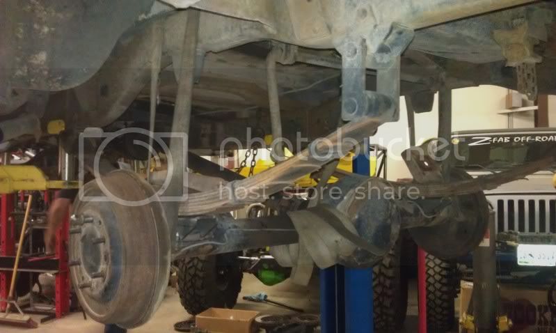

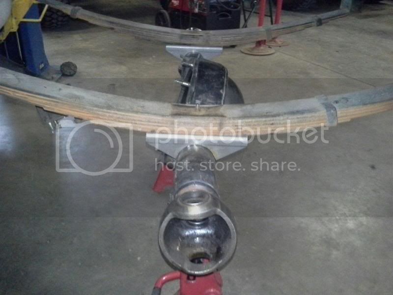

Cant really tell in this picture, but the fronts are still fully assembled in this picture, and he was mocking up the spring perches
cutting the bottom perch off
My buddy and i got to work and tore the front assembly apart, and as anyone that has done this knows its messy. So no pictures of "in the process". But here it is stripped.
Perches mocked, waiting for the front to be done so it can go back on the ground for the final rotate and welding.

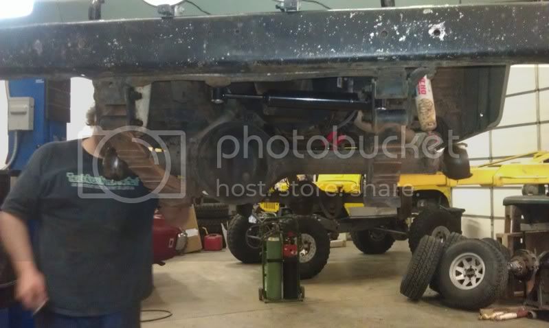

hopefully some more progress pictures thursday.

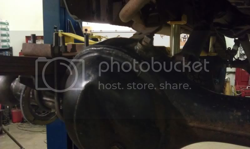

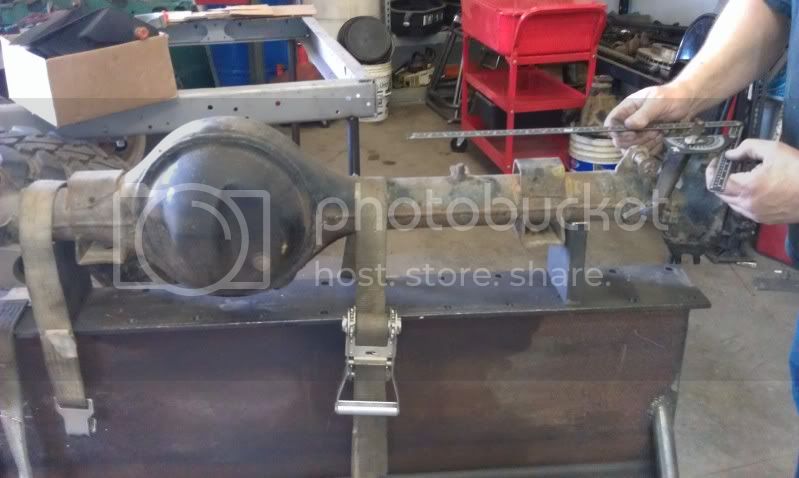

Measuring for bump stops and and angle

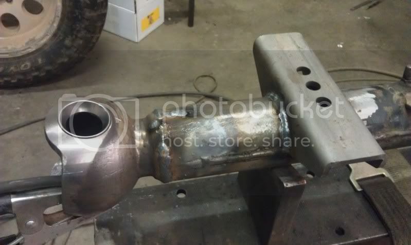

Zfab finally have gotten back to.working on my rig, started the knuckle turn and should have it finished tonight. Then its my turn to reassemble the front axle so we can button thi up !
Looks like a real clean cut. Going to be nice to get it back.

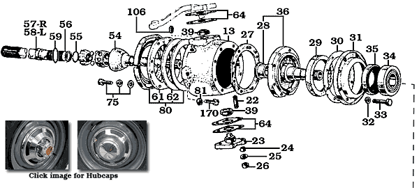

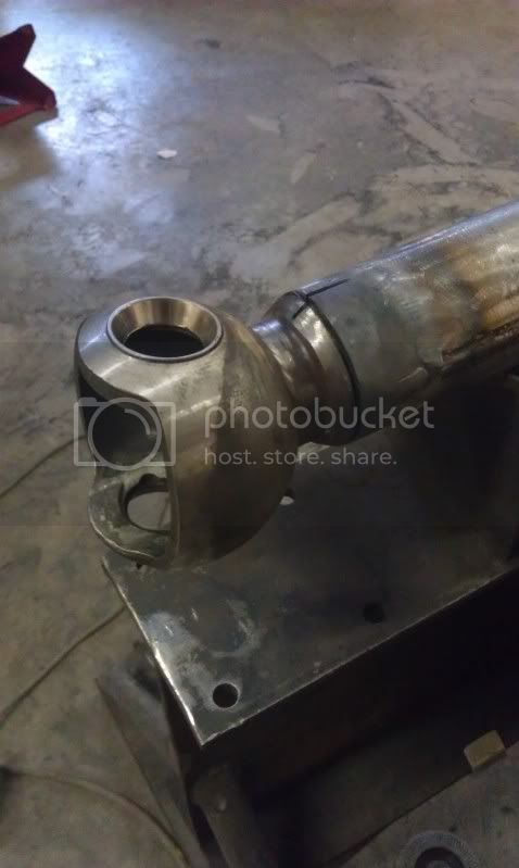

Well got "some"work done tonight, ran into a snag when we started to assemble the knuckles. go to find out the anvils (number 24 in the illustration) and studs are different sizes between the 79+ kuckles and the small pattern. So I need to get some new larger anvils before I can proceed with the knuckle.
However obviously the knuckle is turned and welded up now.
