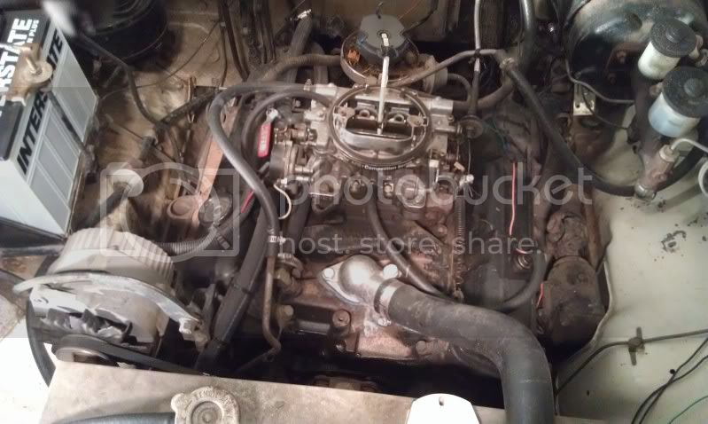

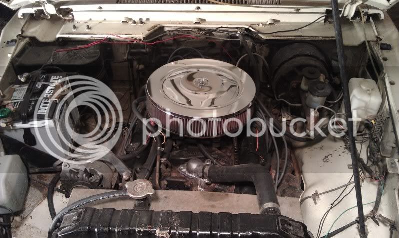

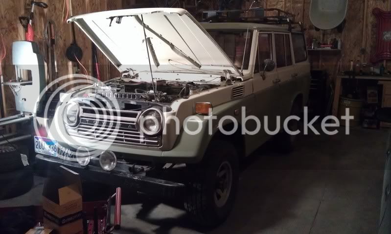

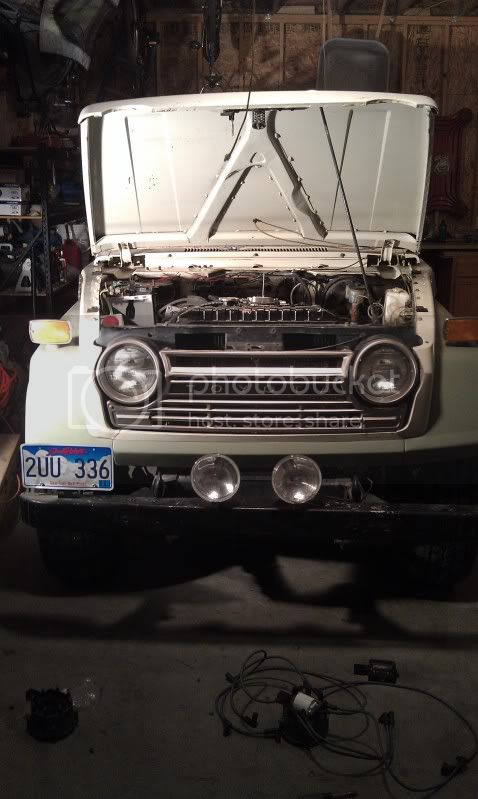

Finally got around to doing some maintenance on this. Since im a new owner to the pig i had no idea really how its been taken care of and whats been done (maintenance wise) So i figured I would at least give the engine a quick tune up. Plugs, wires, cap and rotor. Also have an exhaust leak from the manifolds that i bought some stuff to fix it. Another day when its warmer though. Some quick pics i took while working on it.
and back together all done.
btw, can wait till this summer, i'll probably pull the drive train out so i can do some engine bay cleaning and painting. Plus clean up some of the horrible wiring from past owners....ugh.

On another note, this thing idled ridiculously low. After the tune up it came up some. Now after adjusting the timing, she purrs like a kitten. Took her for a drive to pick up some beer for the impending storm (expecting 5-11 inches here in SD) And everything has been smoothed out. No more dead spot down low, and nice clean idle.
