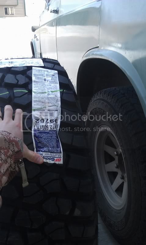

My 37" km2's are order and should be here Thursday. Nice as there backordered everywhere else!

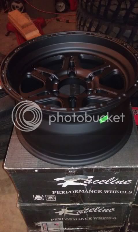

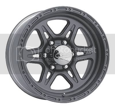

Going with something simple 17x9, 4.5 backspacing with a 4.25 center hole. They were about $500 shipped to my door.

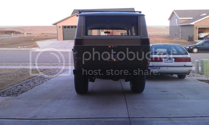

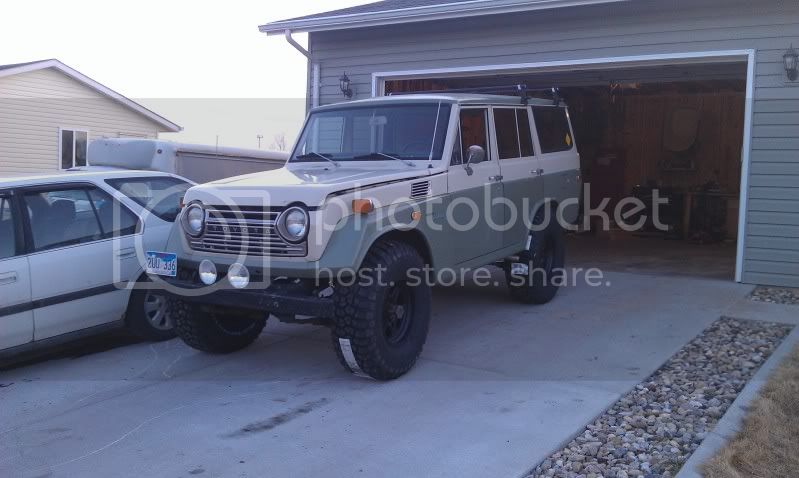

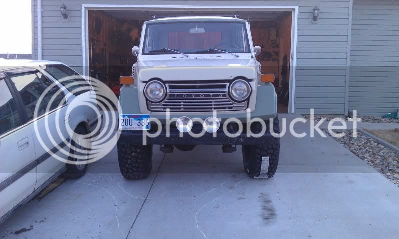

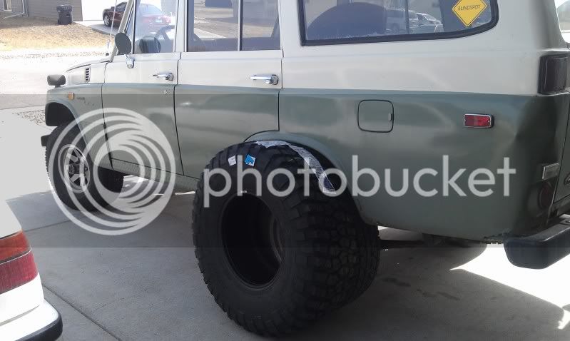

Got the 37's mounted and balanced today, put them on for giggles. Glad i went with 37's. Obviously i cant drive with it like this as i only have about 1/4 clearance in a few spots in the rear. Also didnt think about the size of the wheel spacer (inside diameter) As the spacers wont go over locking hubs. So i'll have to have them milled out. no biggie. I also measured to see how much more clearance my garage door has to go after i put the 37's on. I still have about a foot higher i can go before i run into any issues.
