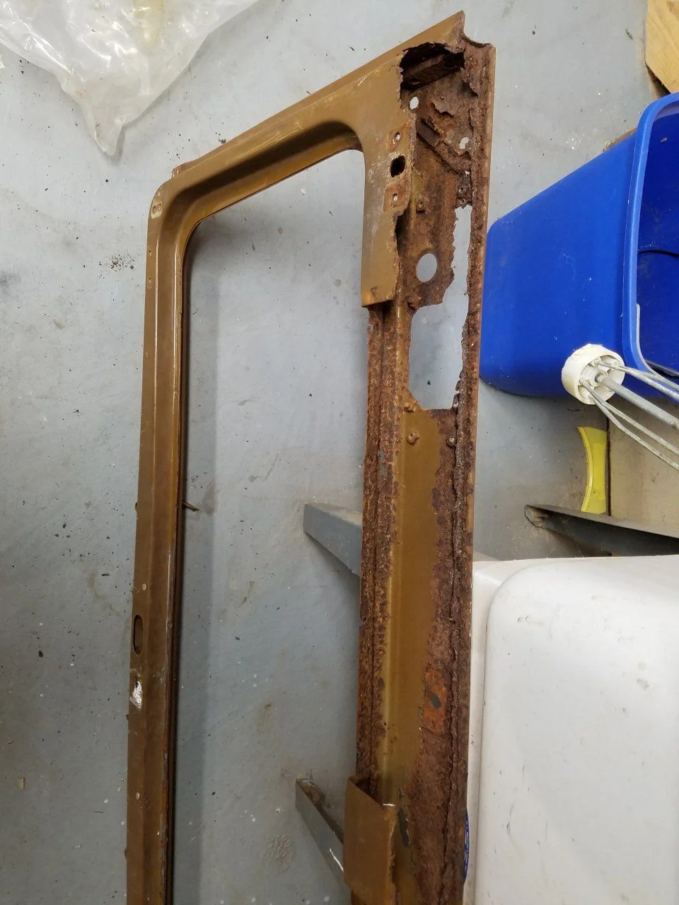

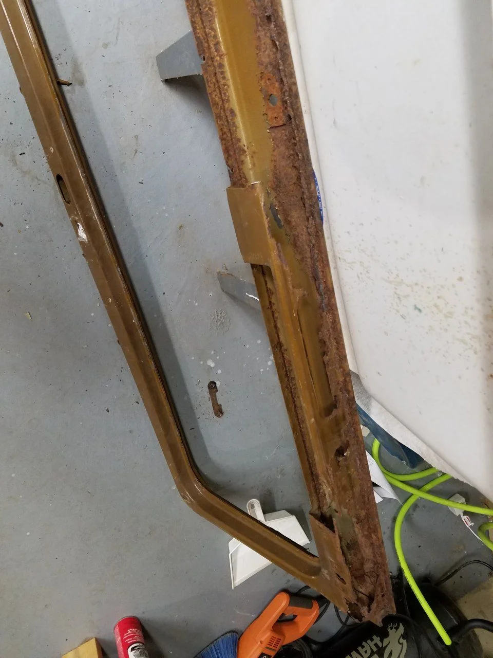

Had to post some pictures of the windshield I removed from my FJ40. There was not much left. I was able to parts blast the linkage, paint it and get it back into working condition. Also tested the wiper motor and it also works. You can see the video link here.
I got a new windshield from Land Cruiser Heaven. So far I'm very happy how everything fits.

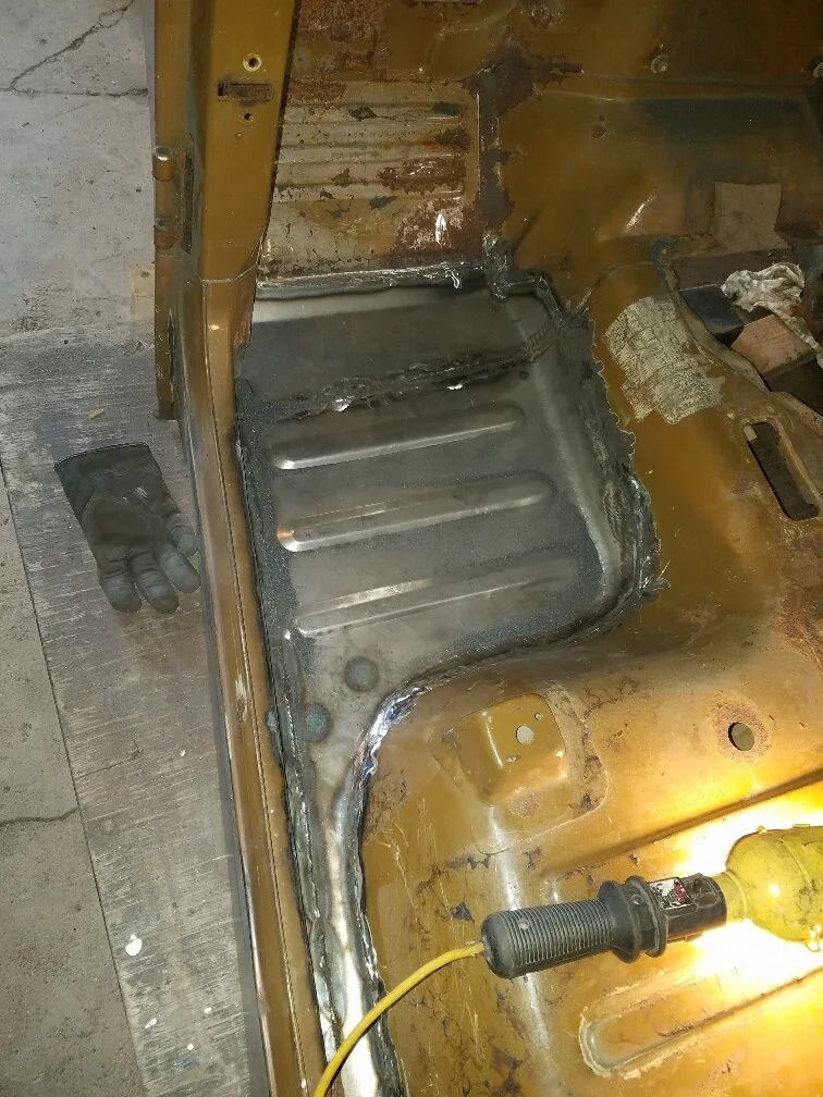

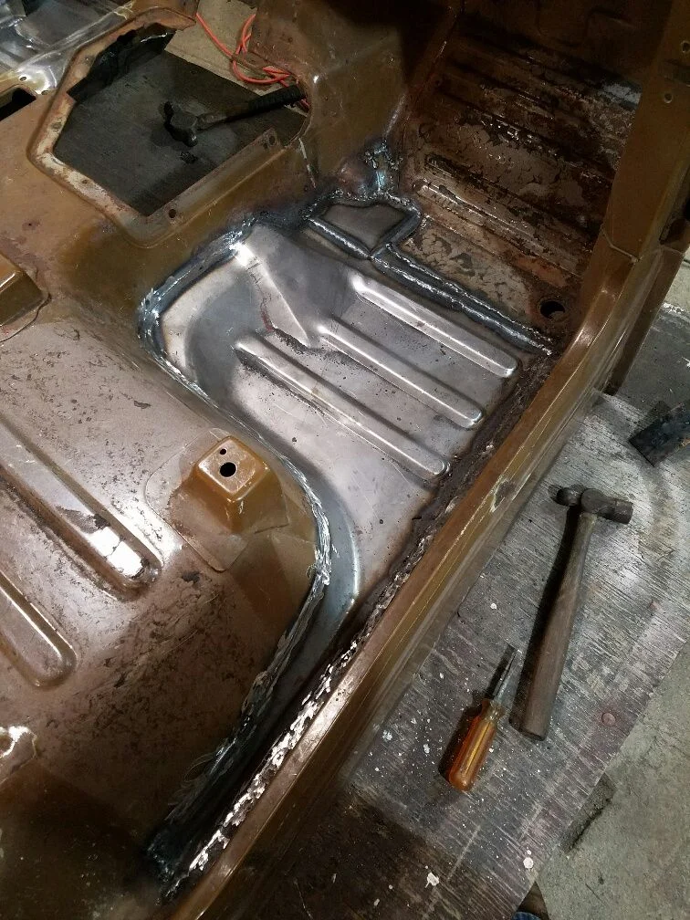

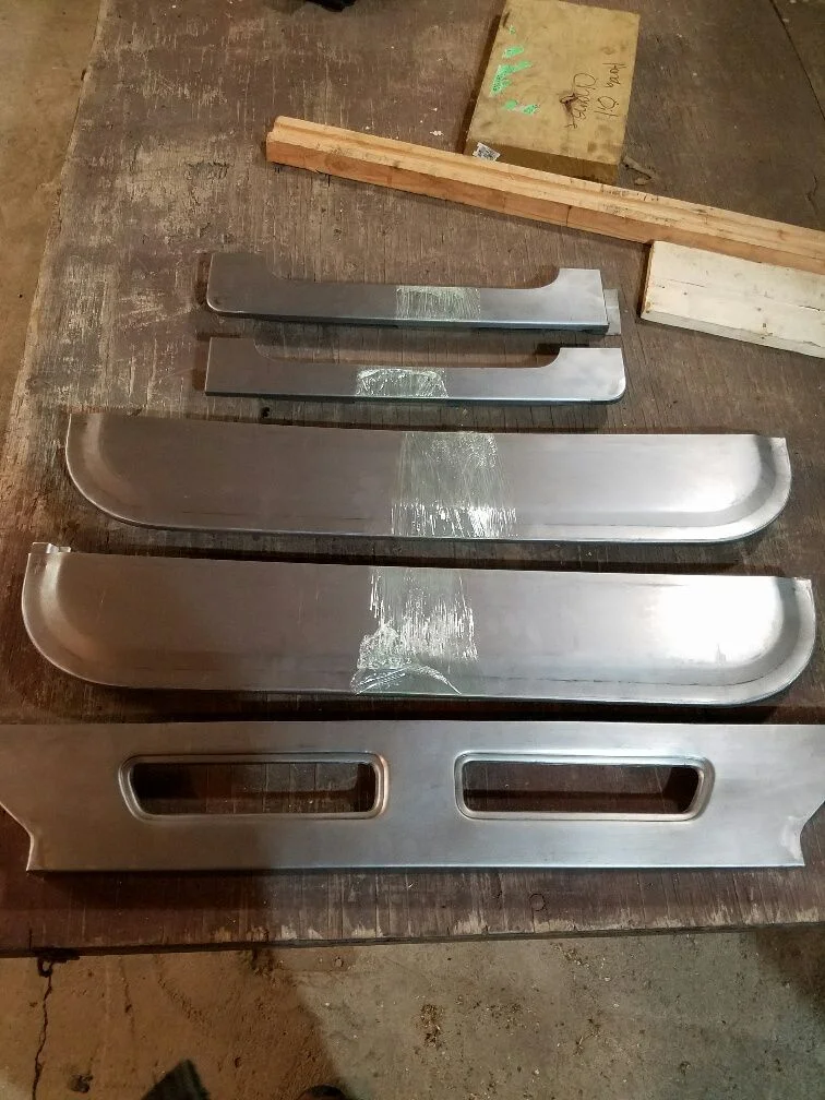

Been working for months on replacing rusted out body panels. Both floor pans were installed. Still have some grinding to do on the passenger side. I wish I had more pictures, but have rebuilt the drivers side rocker, and the drivers side area where the seat belt bolt goes. There was so much rust in this area that the seat belt bolt was not being held in by much. Looking forward to moving onto the fenders, hood, bib, hardtop sides, front and back doors!

Ordered and received all the last body parts I need to complete the body work. Will have alot more work to do now. Thankfully the front cowl and rear tub and all done now. Once I get all these patch panels in I will be sending it to the sandblaster to get back to bare metal. Slowly gaining ground on this pig!

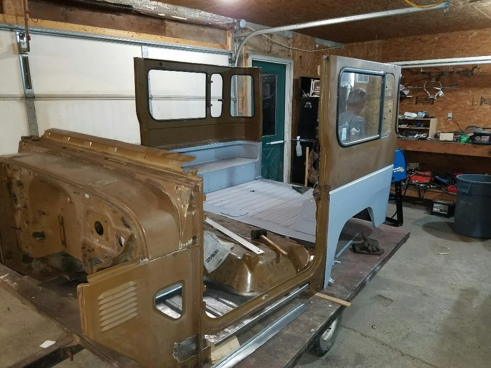

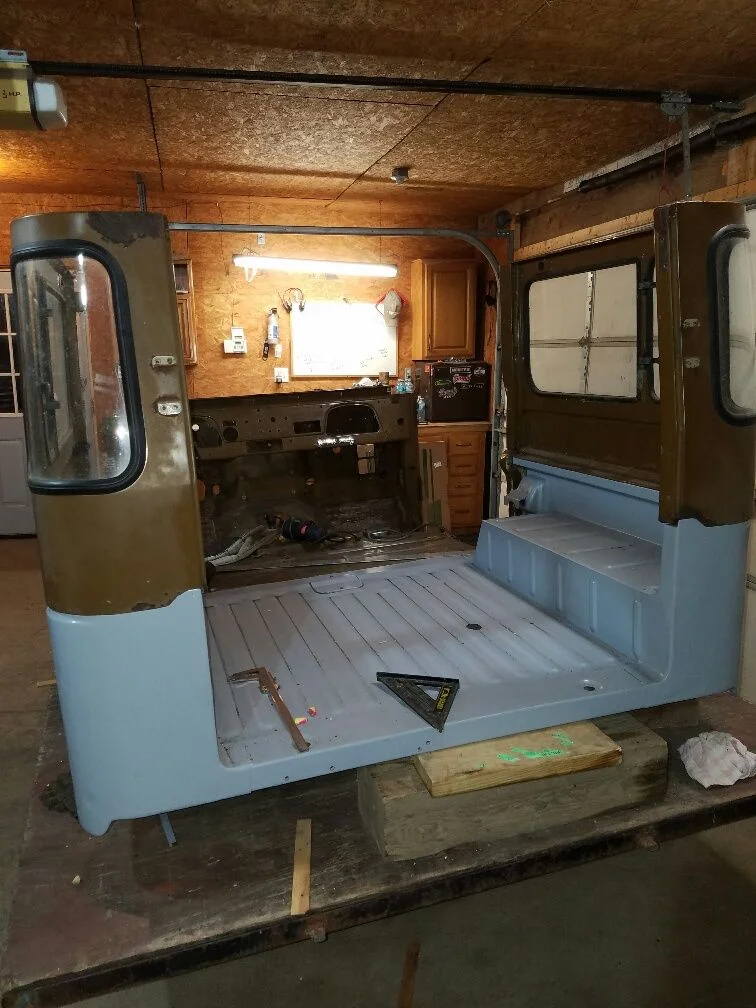

Been doing a lot of work to the body over the last month. Trying to get every rust spot cut out and repaired with new metal. We were finally able to bring in the rear tub from LC Heaven to mock everything up. The rear tub did require a few modifications, but it is going to work. Hopefully over the next month I can finish up on this portion of the job.
What mods were required for the tub? I have heard the same thing. Looking at this being an affordale option for me and my "new project" i have not shown mud yet lol
I believe the modifications that I was required to do we corrected out of the factory now. Overall I'm pretty happy with the rear tub. Saying that I have not bolted it down yet.
