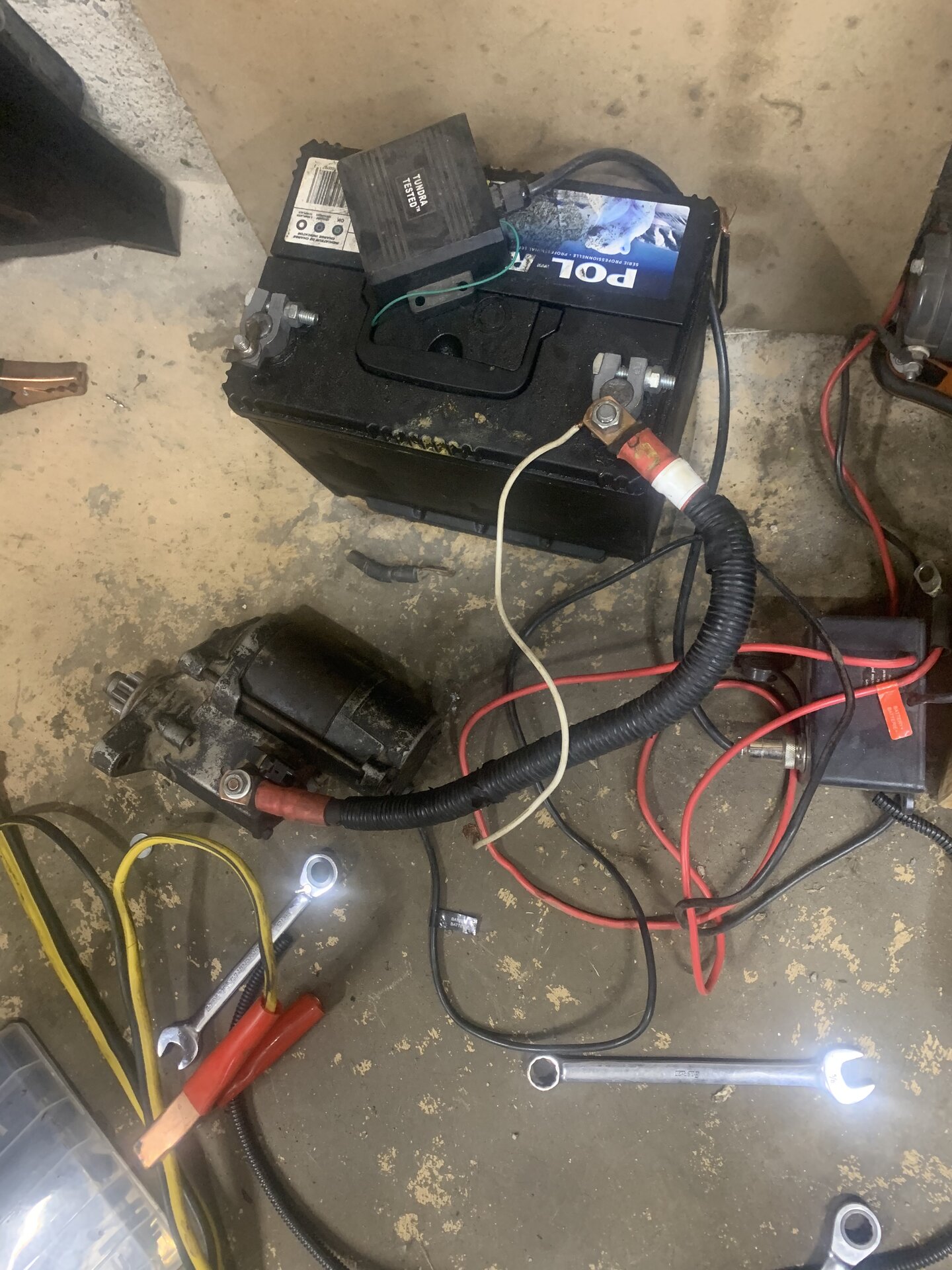

Spare battery setup with starter.

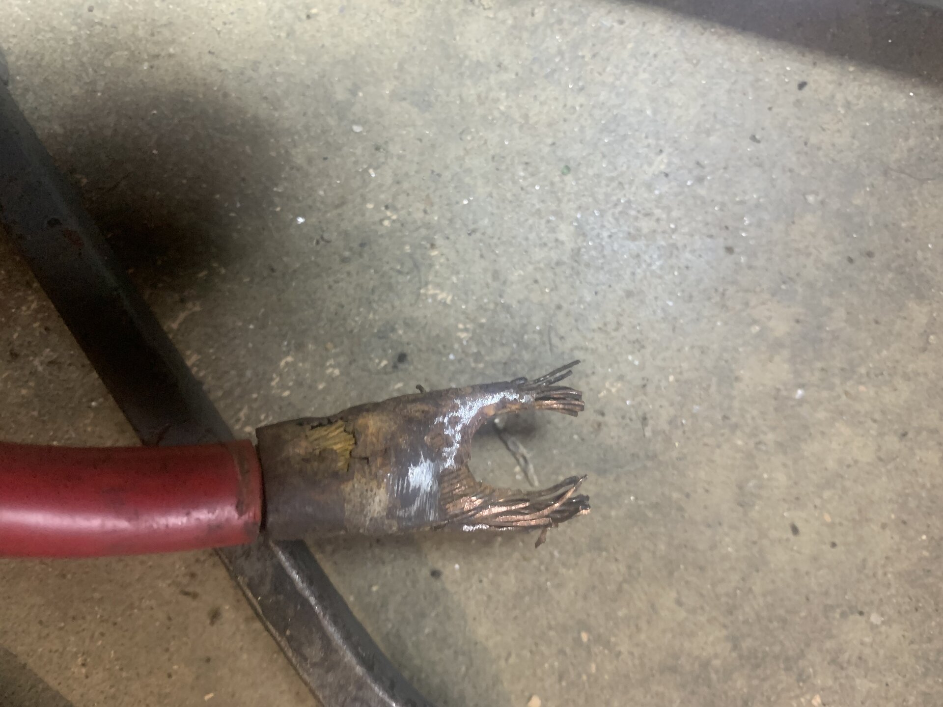

Wonder if this buggered lug (which just seems to be crushed/moulded copper wire into the shape of a lug) is the issue or the wire itself that I’m using to jerry-rig the starter to the vehicle.
Better pic of weird lug.
Load tested both the spare battery and vehicle starter battery, and both are showing good state. Got to check the power wire in the vehicle that goes to the starter.
I think you have found the area of compromise.
I would gather the parts and reinstall with a good starter, new cables, clean connections, and a proper ground wire from block to battery, available from Toyota, but you might be able to make regular auto parts store work.

However, starter still does not start! Solenoid engages, but again motor doesn’t not spin. When the ground wire was disconnected from the starter battery, it must have been touching the inner fender sufficiently to complete the circuit when it worked momentarily before I disassembled the starter. I’m starting to suspect the large gauge “jumper” wire I’m using to jerry-rig the starter. Have to leave for Montreal, so this will have to wait
PROBLEM SOLVED!!!
So, finally the starter works as it should when jerry-rigged to the vehicle. Solenoid engages and motor spins when key is turned to POS #3, and the electrics don’t all die. Only thing I did was to replace both lugs on the heavy gauge wire I was using to jerry-rig the starter to the vehicle. Cut the old lugs off and soldered in some real solid copper ones.
