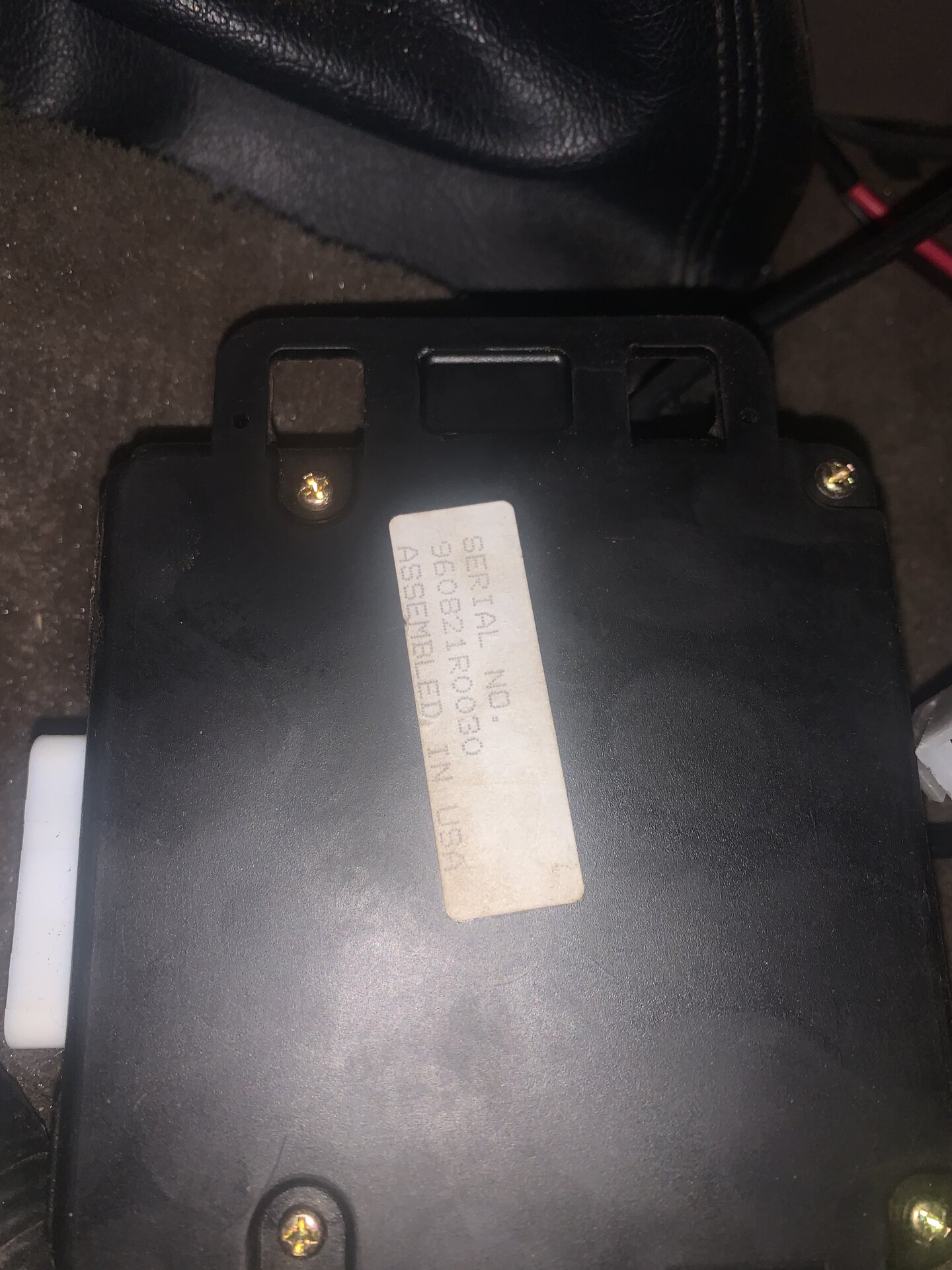

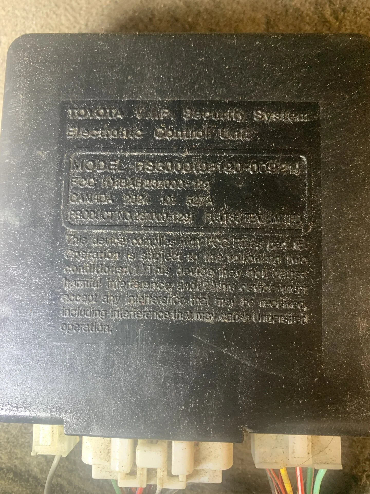

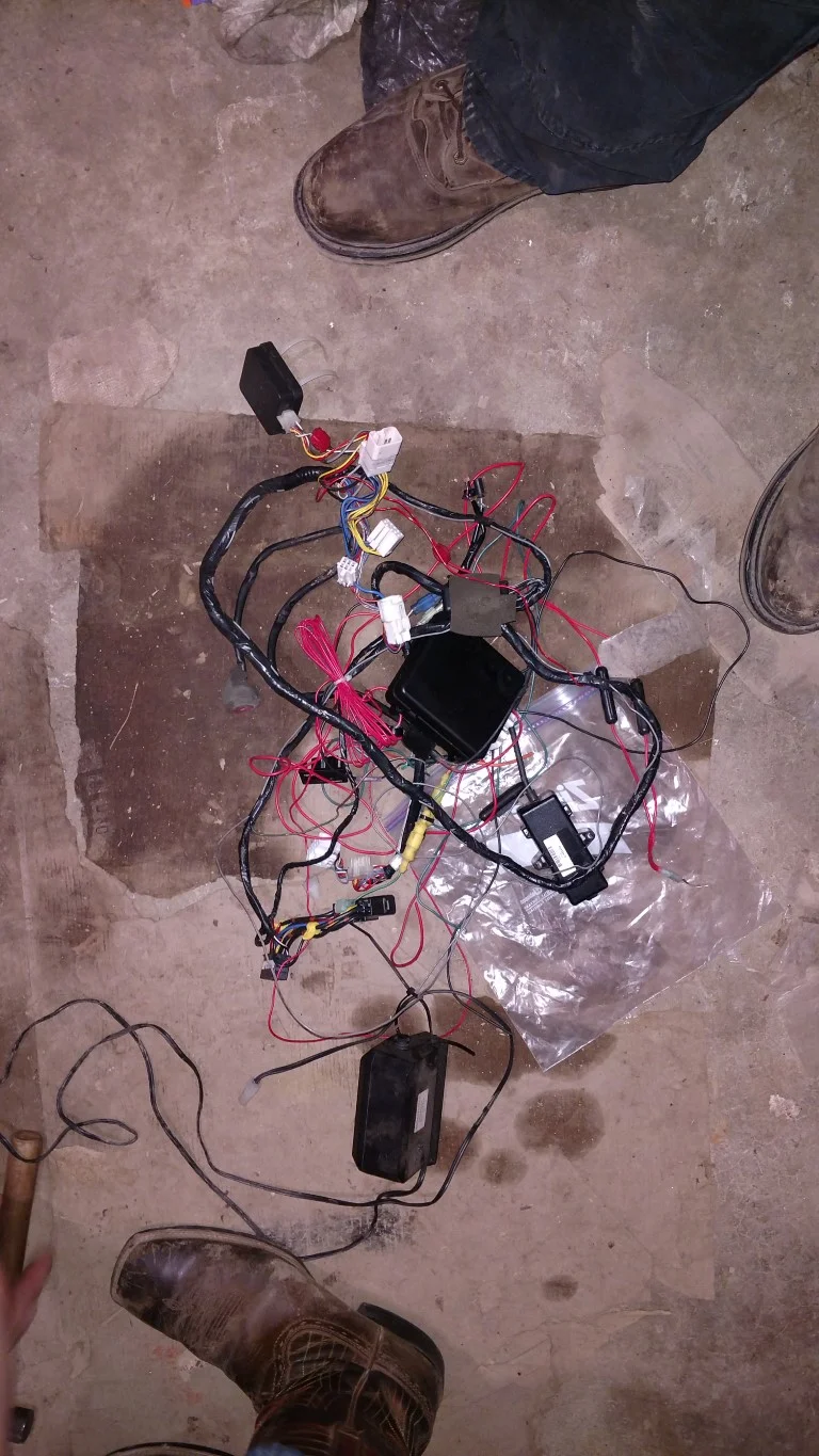

This is what mine looked like after removing it.
While I was in there, I also did the Pin 7 Mod and added a CDL switch (Repurposed hazard switch)

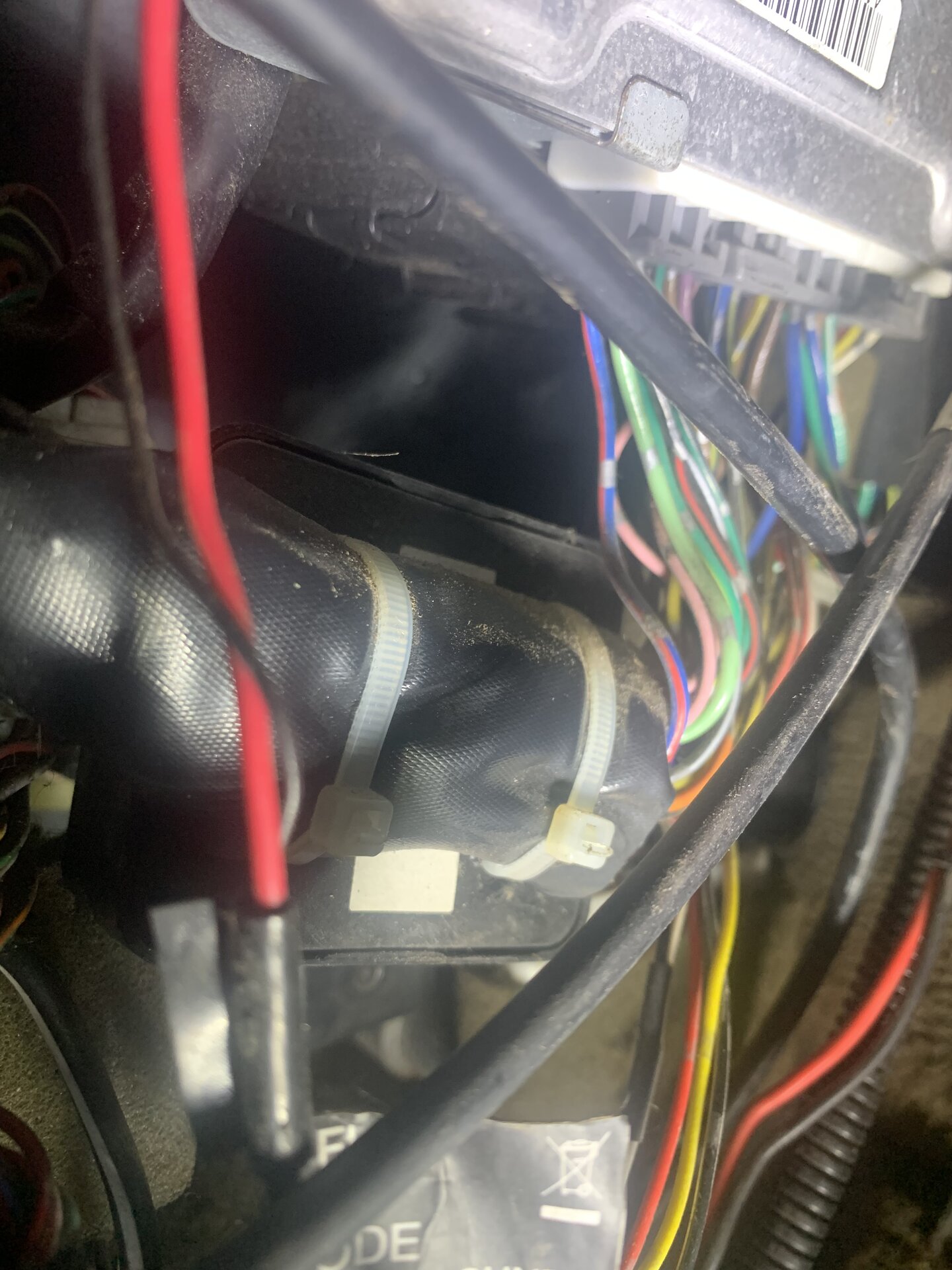

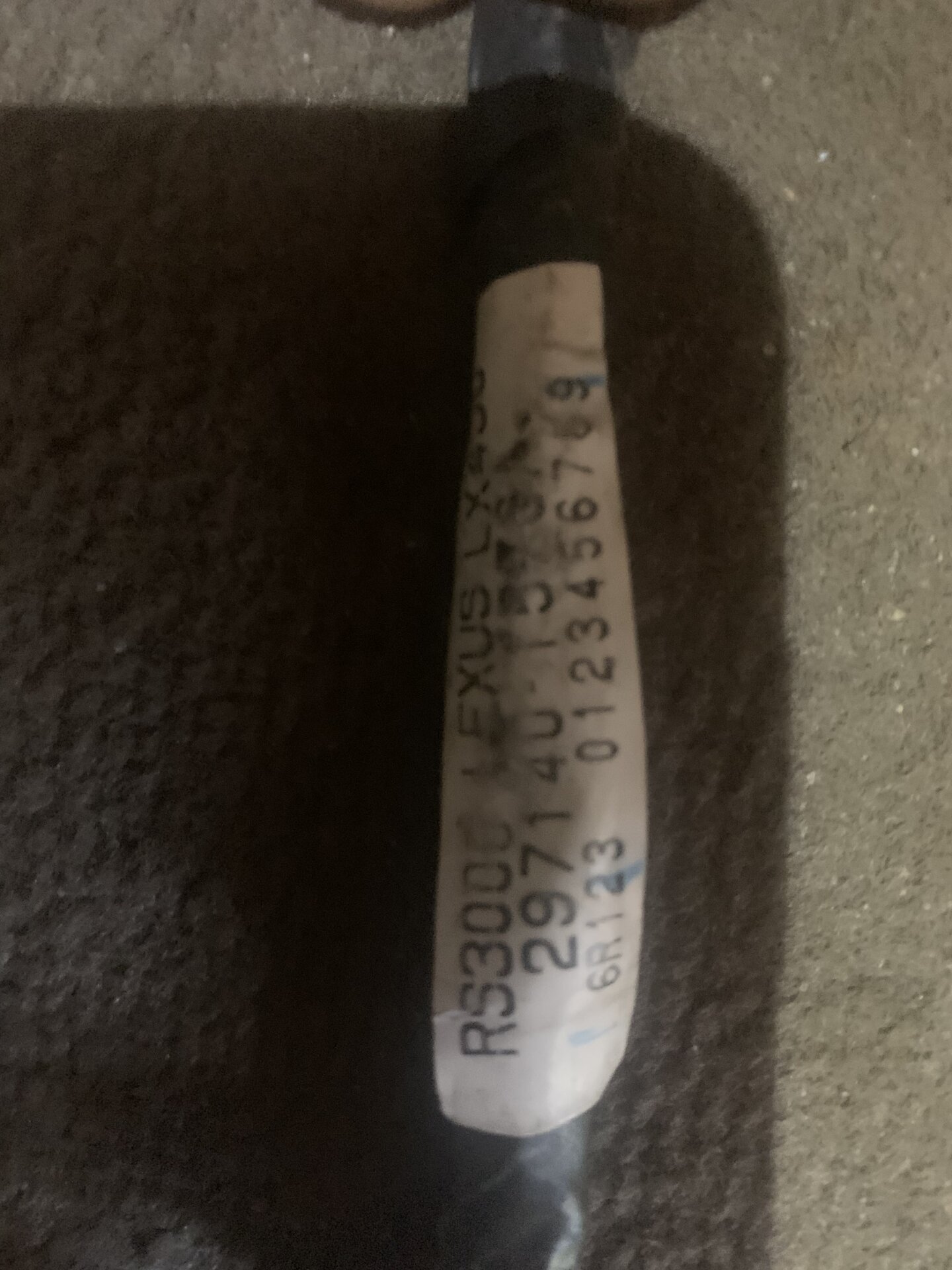

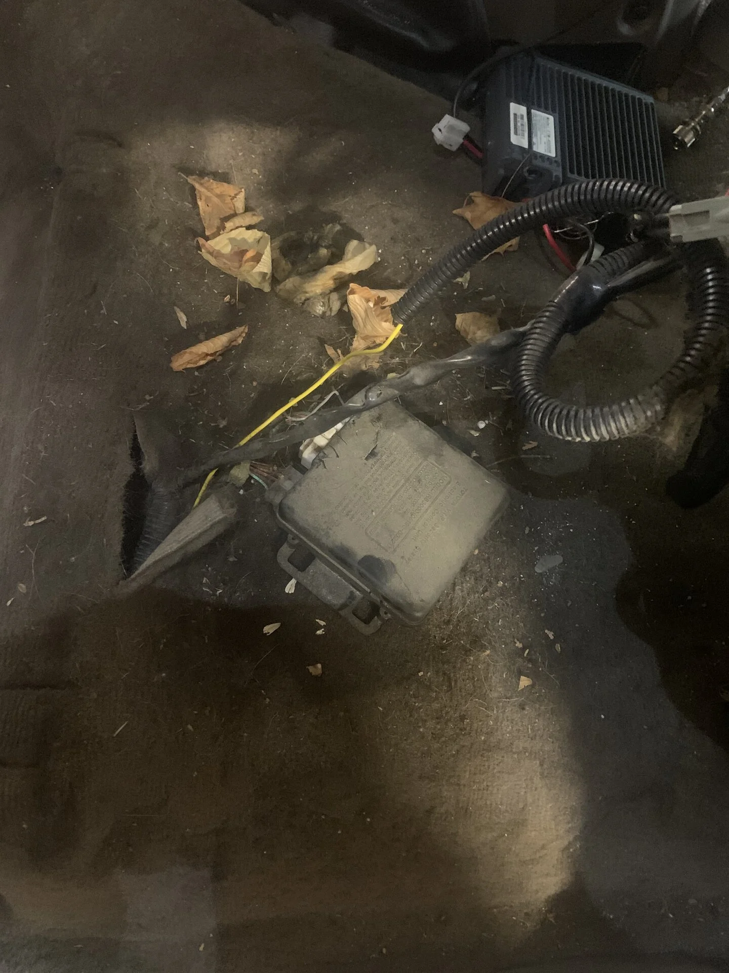

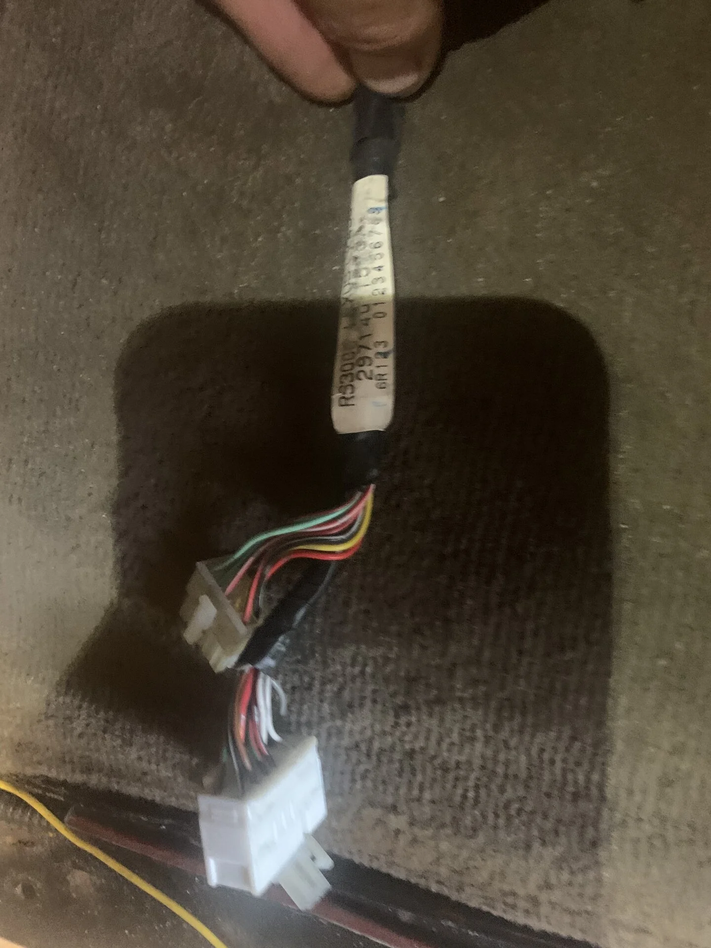

Snaking my way following the RS3000 harness. Came across this module attached to the harness. Held in place with the two white tiewraps.

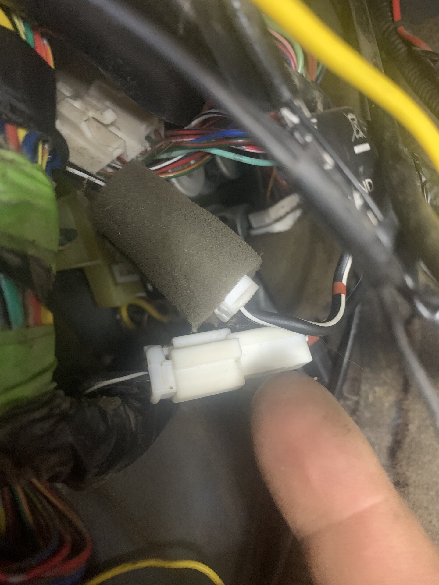

I’m guessing these are the two connectors that interrupt the signal to the starter mentioned. We’ll see. The main RS3000 seems to continue further up into the dash. Hard to see where it goes.

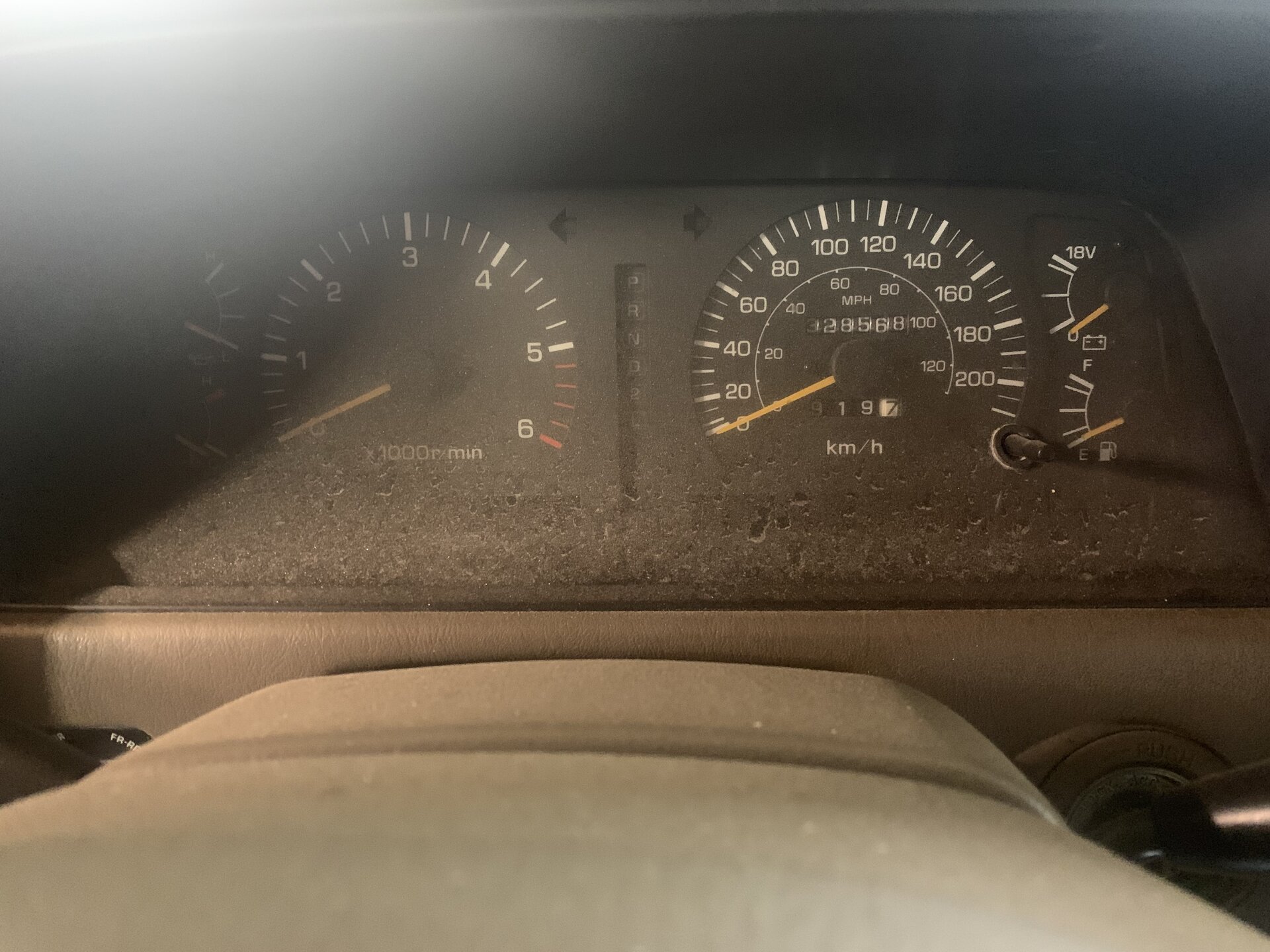

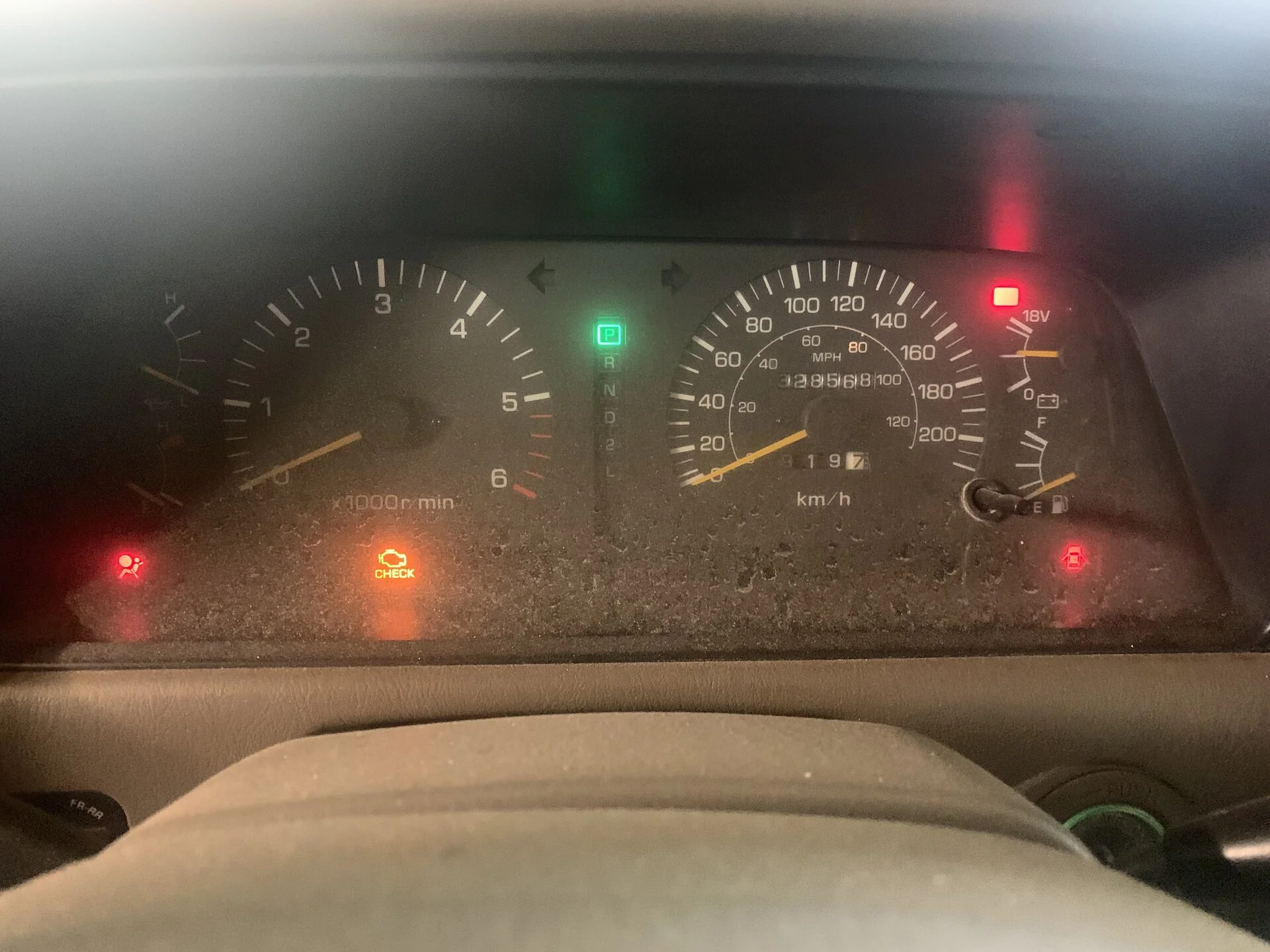

Some weirder $hit is happening. Trying to do a step by step. Still does not start. This is with the RS3000 harness connected to the RS3000 ECU, but with the RS3000 starter interupt connectors not connected to the two factory starter connectors. The two factory connectors are connected to each other. Both batteries connected.

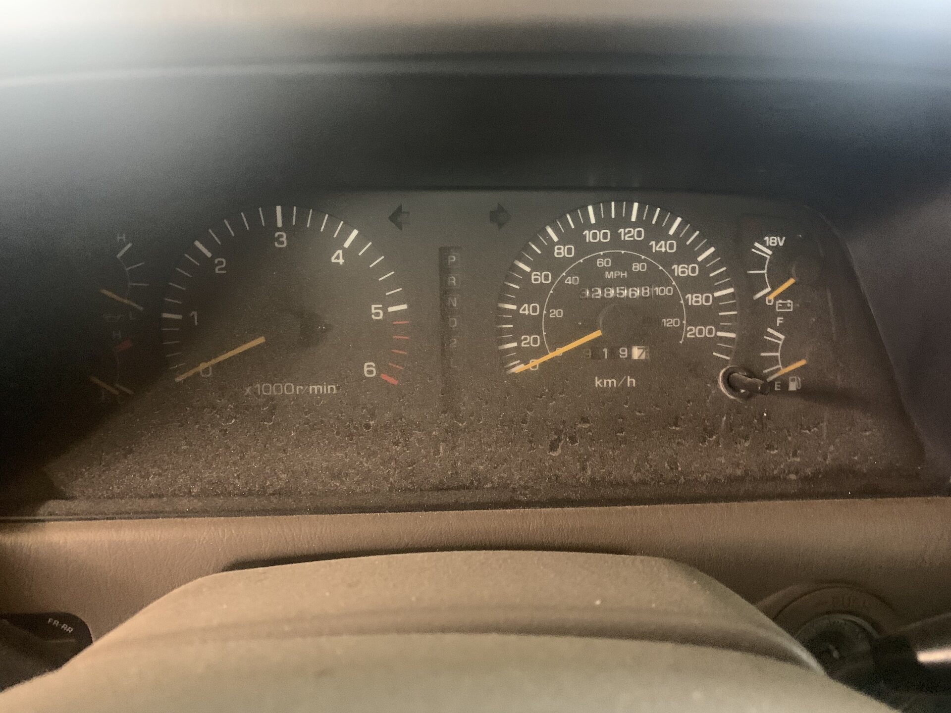

No key, driver door open.

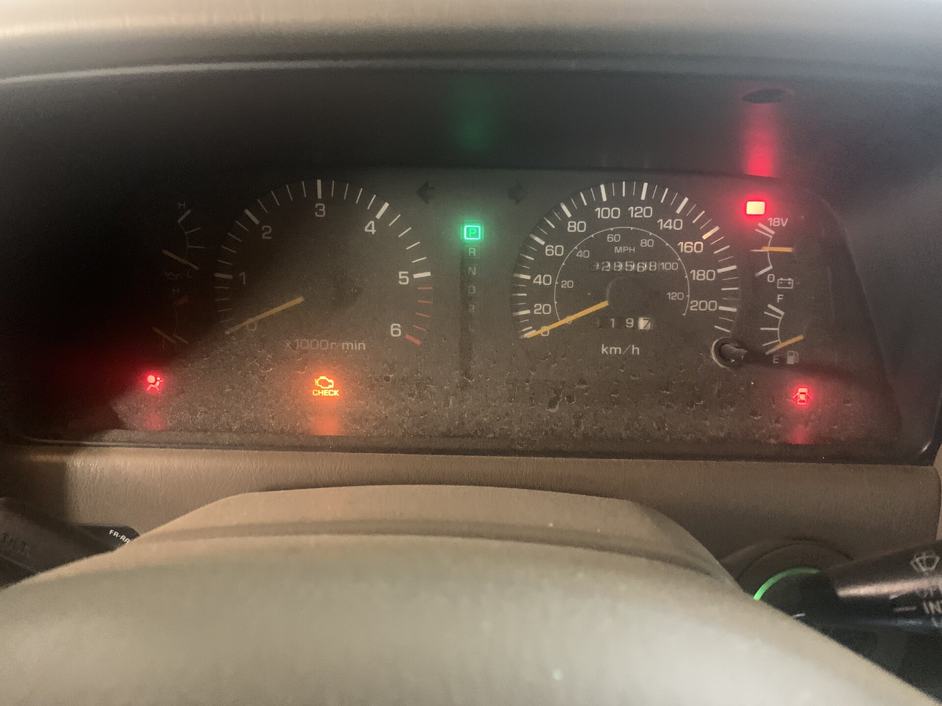

Key in ign, POS #1.

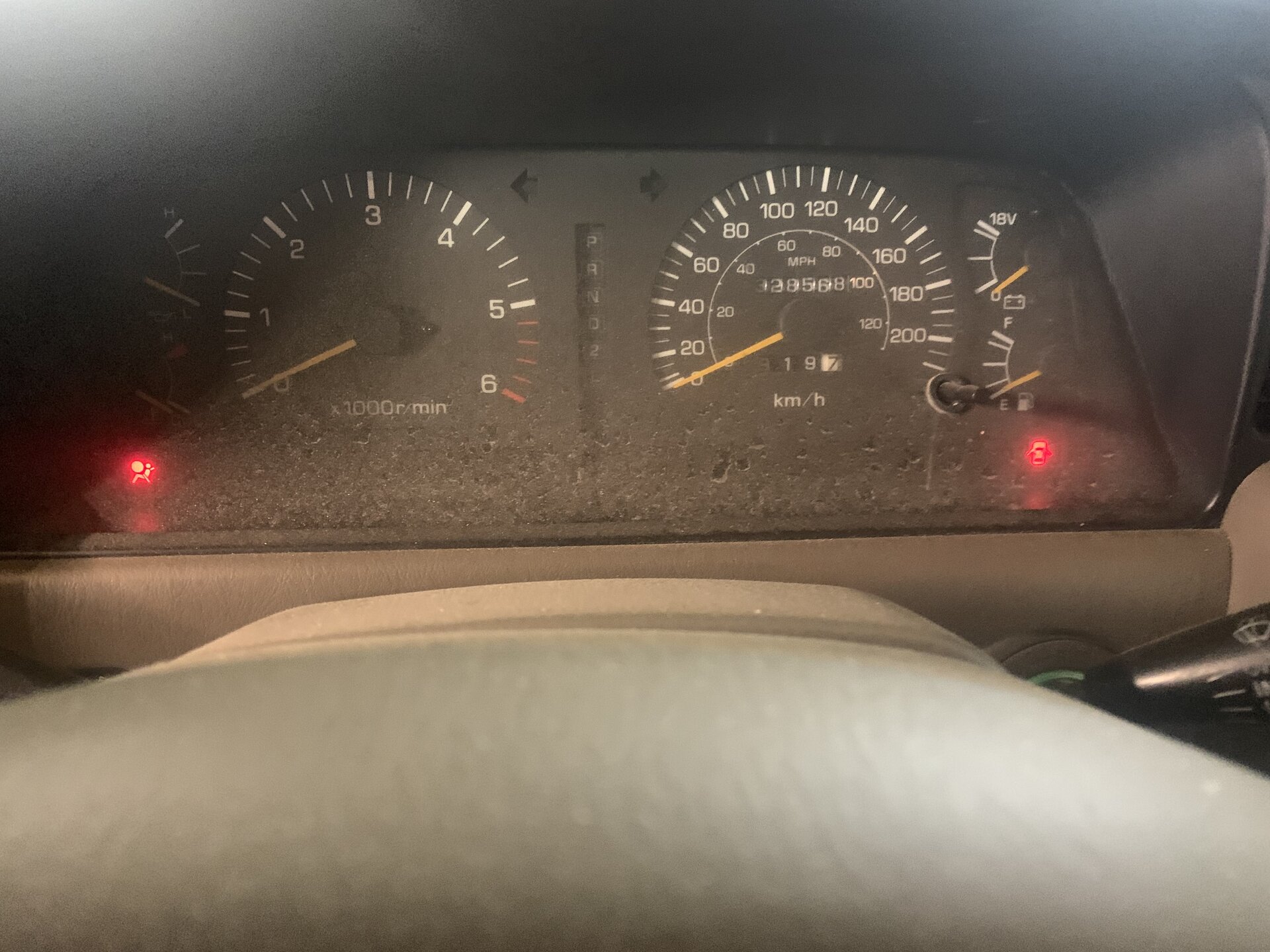

Key in ign, POS #2. I do have the CEL light.

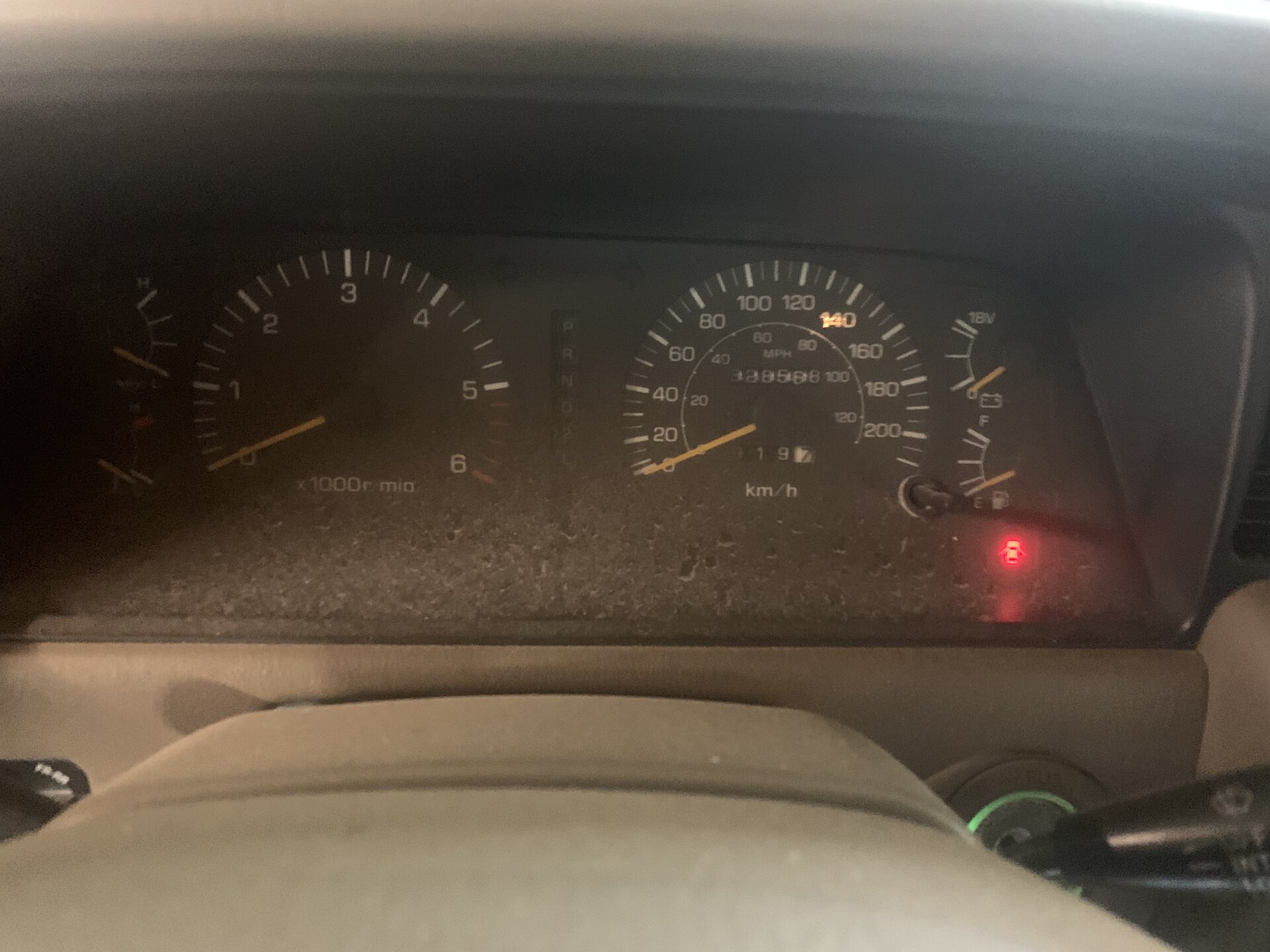

Key in ign, POS #3 (start). All dash lights go out and hear click which is likely starter. Will repeat with the RS3000 module disconnected from the RS3000 harness. Will “reset” by disconnecting both batteries for a few minutes.

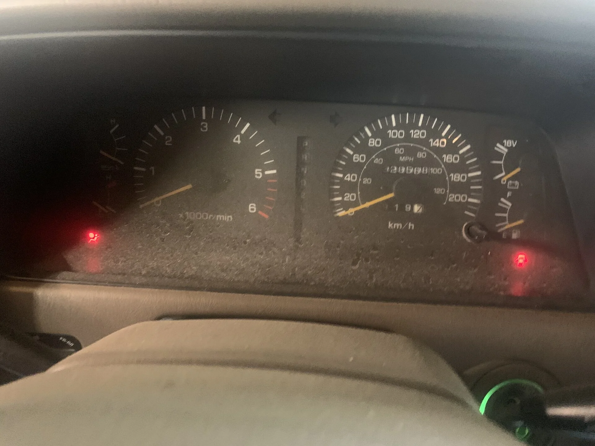

Well, no difference with the RS3000 module unplugged from the harness. 😟

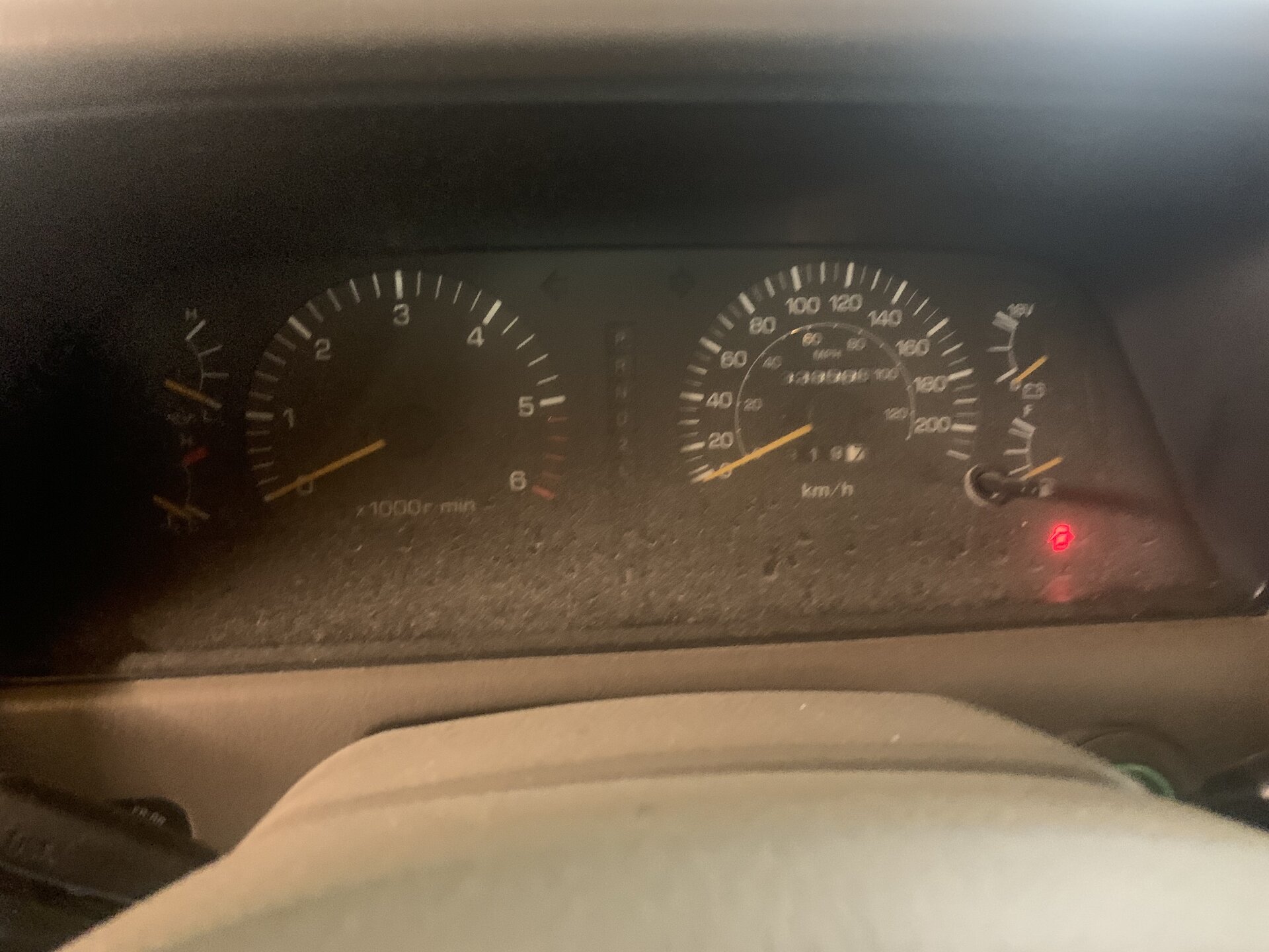

No key, driver’s door open.
Key in POS #1.
Key in POS #2.
Key in POS #3 (start).
