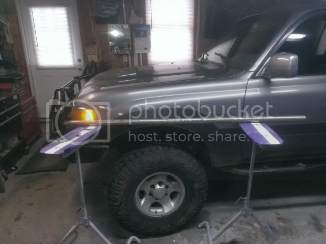

Today I started on the driver side front fender. I have to add that I have never used a bender before today. There is def. a learning curve. I used up a couple lengths of 1 3/4" X .120 wall DOM tube while getting used to the bender. I figured this would happen. Overall it went ok. The notcher is by far the easiest step in the project so far.

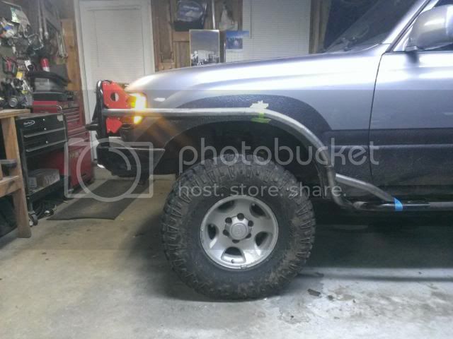

I am still playing with different idea's for the front. First pic shows with a connecter by the front door. Second is without. I was thinking a little more support wouldn't hurt. If I dont do the tube there I will use flat stock and gusset up in the intersection where the tube meet. Tell me what you think.
I will still be adding another piece from the end of the ARB wing up to the straight section of tube. I will try to bend this to match the wheel well arch. I might cut the end of the arb wing off and incoperate the tube into it.
You'd be surprised how flexible tubing is. I'd recommend staying away from your body a good inch and quarter. Lets you wash behind it too.
Looks awesome.
Thanks! Good call on spacing. I didn't want too go to far. I spaced it kinda tight at 3/4" I hope to gusset it up enough to take some of the flex out. I have been tossed up on this project as I loved the look of the OEM flares but they just aren't known to stay on too long. I don't want to end up with my truck looking like the next doomsday prepper mobile with all the tube. We will see though.

Finished up the driver's front this afternoon. Everything except the one piece I want to add going from end of bumper wing up to the straight section of new tube.
It feels very stout at this point. I am satisfied with it. Unfortunatly I only picked up a 17' piece and after a couple messed up pieces while learning the bender I need more. The supplier I use is out of .120 DOM. So tomorrow I have to call around to find more.

With a sweet tube bender, I would suggest that you run another tube up from the top of the bumper edge closest to the tire, up to the main tube going back to the sliders. You could get all fancy and have it follow the same curve as the fender. This way it would reinforce the main tube. Pretty much the same idea you used down by the rocker panel. :hillbilly:
