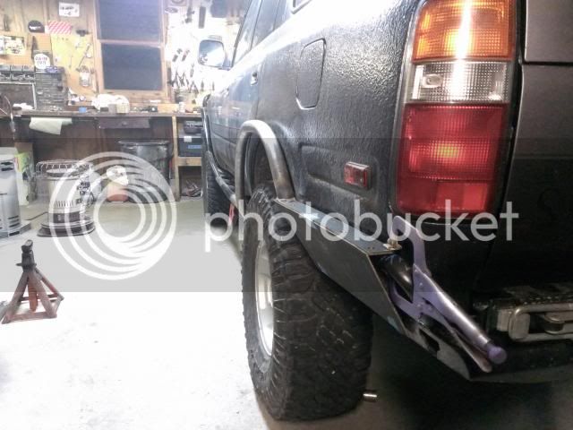

I started on the rear tubes. I was planning on tubing the hole quarter, but plans changed. I bent the pieces but it looked over board on the 80.

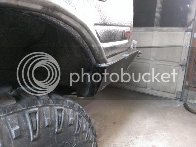

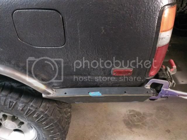

I bent the tube to follow the wheel well from bumper end to slider. I tried to match the design of the front the best I could. So I decided I will make a hoop that will bolt on the modified rear bumper wing for when I go wheeling (4x4 labs rear). I will be putting braces on the wing to frame to stiffen it up.
Its taking some design time but I think it will work out well and look good while not wheeling. Hope to have the driver side done tomorrow except the bolt on hoop.

This pic shows my mock up (cardboard) of the second bumper wing piece. Have to pick up the material for this still

Would that not just fold into the fender if the weight of the truck was applied to it?
I know it's added protection but do you think it's enough with such a long lever arm?

Yeah, it could bend into the body with a strong enough impact. Could be easily addressed. This is what Binks Fab did:

Thanks guys. I need a little push right now. Just finished the driv. side rear. today/night. I will post up some completed pics in a bit. Took me a total of 19 hrs to complete. Pass side should go a little faster since I have the design down not. In the future I will still have to fab up the hoops.

I do believe with the weight of the truck would result in defelction how I have it. Not sure how much and what it would take. I can deflect it while fully pushing about 1/8". I did brace the wing to the frame with 3/8 flat stock also. It is damn rigid right now for how long of a span without anything. A brace in the middle and that would be perfect.
