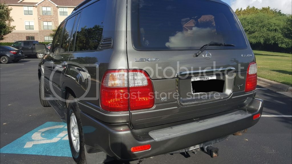

I have always been wanting to get a hundy and I finally found the right one after selling my e36. Picked it up with 144k and alot of maintenance records. She had the 90k service done at 100k so TB/WP should be good for another 100k :). Its been in Texas its whole life so zero rust! The plan with this hundy is to be a camping/ family vacation/ mild off-road vehicle (Which its already capable of!)
Im going to document all the mods/maintenance/repairs I do here. First some pictures!

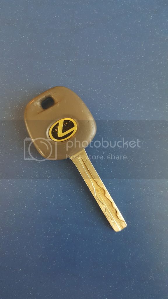

Ok so my wife's main thing is having a remote unlock and locking of the doors. I was contemplating getting a remote start to avoid the hassles of master keys and possibly having to replace or reflash the ECU as I only had one grey non-remote key. Instead I read about how to see if your key is the master key or not.
-Hop in and close the doors
-Find the flashing alarm light (located near the AC controls)
-While watching the light, insert the key in question into the ignition
-If the light goes away immediately then you have a master key!
Luckily the key below was a Master key. Everything on the internet says that this is a valet key but when I did the above it turns out it is a non-remote master key. Also it is a valet key in the sense that it doesn't lock my glove box! So just test whatever key in question with the above method to be sure.

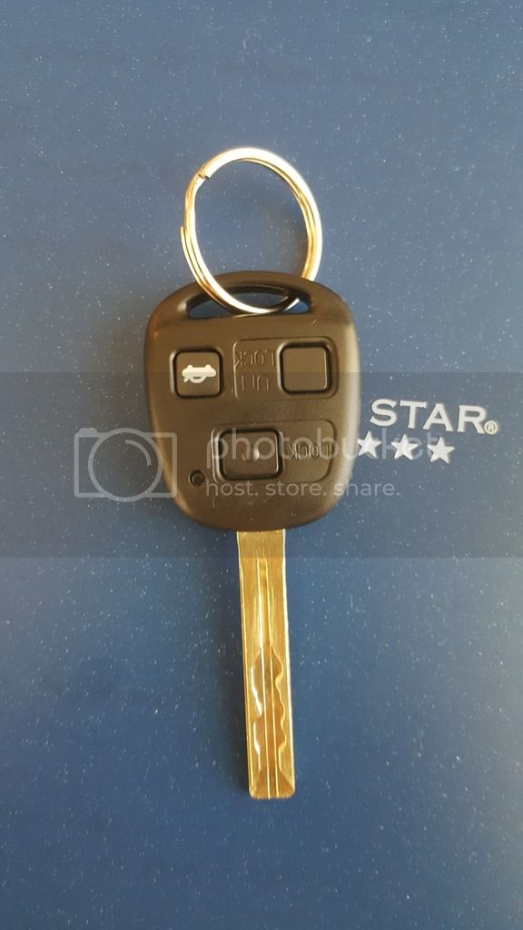

Next I ordered two aftermarket remote keys from amazon. $50 for the pair
Amazon.com: Discount Keyless Remote Entry Replacement Uncut Key Fob For HYQ1512V (2 Pack): Automotive
I then took the keys to Lexus to get them cut. Lexus was cheaper than any one else I called when looking around in Austin. I was quoted by Cothrons $130 (Each) just to cut them the same as the key I have. Lexus charged me $12.95 each and had them done in 10 minutes.
Once I had the two new key I tried to program them. The instructions in the link worked perfectly for me except the second part of the video on how to program the remote.
When I tried to do the remote programing I could not get it to enter the programming mode for the life of me. Several attempts later I recalled that on my old 3rd gen 4Runner I ran into the same issue. The solution: Instead of cycling through lock and unlock with the button on the door, stick your extra key in the door lock on the outside (rolling the drivers window made life alot easier) and follow the instructions exactly. This worked like a charm, the truck entered program mode and I was able to program both aftermarket keys to work with the immobilizer and remote unlock and lock the doors. SUCCESS!
Total cost:
2 Aftermarket Remote keys: $50
Lexus laser cut: $30
$80 is a hell of a lot cheaper than what I was quoted for just one key and programming ($300)
