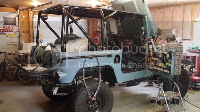

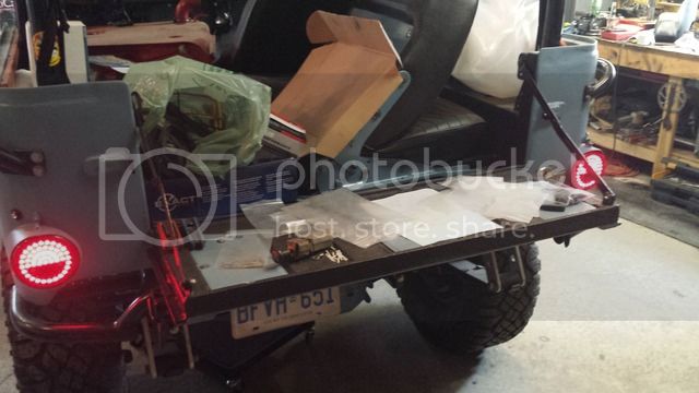

Random pics of the van comin to life.

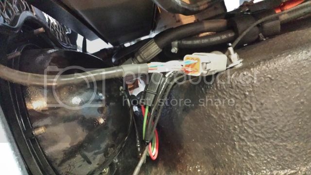

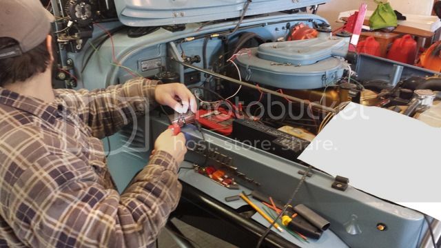

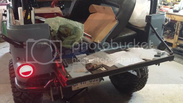

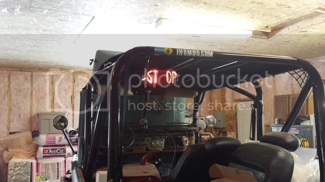

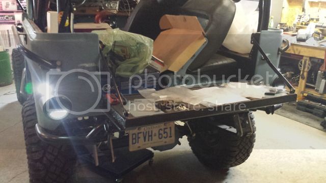

Modified the markers in the bib to have hi low instead of just high so now theyre markers and signals, also got them synchronized with the led signals in the aprons. F/r light harnesses are run and pinned to the 40 pin doisch connector in the firewall as are the horn front bumper light bar and aux reverse lights. Wiring is run from the back up switch gas tank idle solenoid and some of the interior lights to the firewall but not pinned yet.
Were making a nice diagram as we go to keep track of things and he printed a blow up of the 40 pin that were labelling to make things as simple as possible.

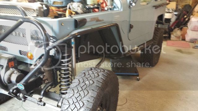

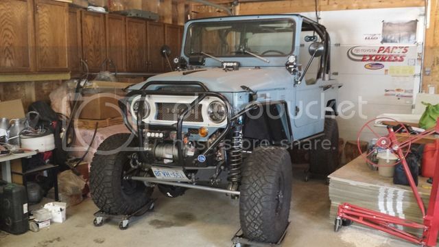

33s got thrown on to get it a little lower.
D
Thanks!
Yup theres a traction bar hangin out back there and so far i have chromo front birfs/ axles on stash. Im curious to see what eventually breaks lol.
