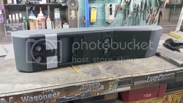

Otherwise ive been dicking with the sixty trying to get it ready for summer. I did find a buddy who has an older suburban overhead console with sunglass pockets and dome lights that i might try to mount up to the roll bar... Should match up allright since its an older squarish one.

Test fit the burban console in the metal tech cage and the whole thing fits surprisingly good. All thats really needed is a trim where the console meets the b pillar hoop. Planning to make a lid for the top of the console so water is kept at bay and a couple attachment points to mount her up.

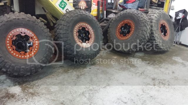

Also decided on a color for the tmr bead lock rings since i dont really like the green thats on there now. Toxic orange/mango tango for the win! Just have to talk myself into tearing the rings off the rims which sounds like a boat load of fun. ..

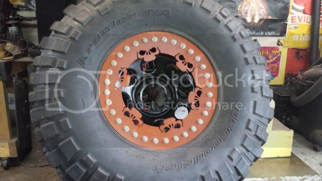

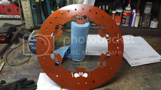

Nothin real huge in the update dept. Been getting the 60 ready for summer with new tie rods and king pins. Finished that and then ripped the bead lock rings off of the new 40 rims. Couldnt stand the ugly green so they got shot with the mango tango and some clear. Got a hawse fairlead for it and am just waiting for the synth line to show up. Might mess with the overhead console today.

I like the orange. Do you have course or fine spline pinions? With fine spline I think the front axle will hold up. The rear will be close to maxed out with those tires. I think you'll find yourself asking for just s few more inches of axle width with big tires like that. But looking forward to seeing what it does as is.
Thanks man. Was s pita for sure, hope they hold air lol.
Front axle is an 86 bj60 fine spline w 529s and i have cromo birfs and axles for it. Rear is a stocker fj60 w 529s but i think i might have a line on an 80 series full floater to swap it out with. For now Im gonna use 1.5" spidertrax wheel spacers f/r but if i get the 80 axle ill just use them in the front. Tires are 39.5 krawlers, not red label like i originally thought but blue label which is a good thing as they might last longer....

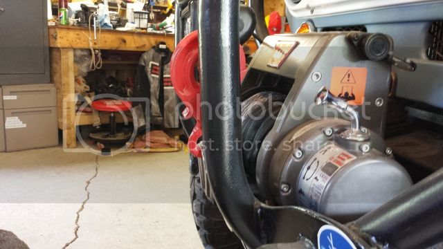

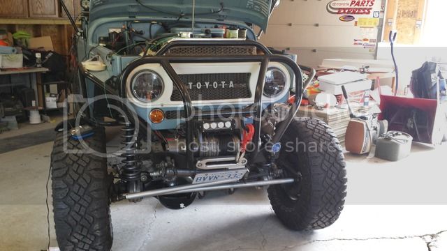

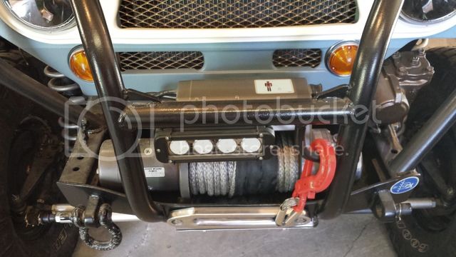

Was lucky and i managed to get permission for a visit with the 40. Didnt do much besides throw the new winch line and fairlead on.

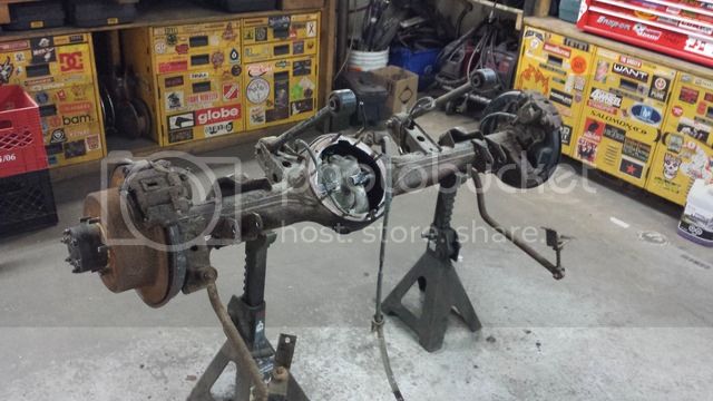

Managed to find a parts 80 series down south with a rear axle and im headin that way with a buddy on tuesday so im gonna bring tools and take a look. Hoping one of the guys in the toyota club down there can check it out for me beforehand. Looks to be a 96/97 80 series w a little front end damage, had trouble understanding the guy i spoke to but what i got was is the 3rd is sold but the rest of the axle is there. Hopefully its what im lookin for.
D
The 80 axle will be a good fit if you have plasma cutter... if not prepare for lots of grinding and cutting. I'm about 6 hours in on cutting all the brackets off mine, and have about an hour and half left.
Yeah ive got a little plasma to hack all that junk off. Just hope the axle is good to go.

Drove 4 hrs down south to grab this jem. Couple buddies had junk to pick up down there also so i got to ride i petes 2015 taco. Everything went smooth and dude charged me 150$.
Planning to cut off the brackets tomorrow, we stopped at tmr on our way back so i got some fancy new shock mounts and leaf pearches to eff with.
Anyone know the part numbers for the shorter third member studs? This thing was locked so its got 5 or 6 long assed ones, gonna check the price if theyre too much new ill rape em from my spare 60 axle....

Go to the hardware store and get some 10x1.25 studs or get bolts and cut the heads off
