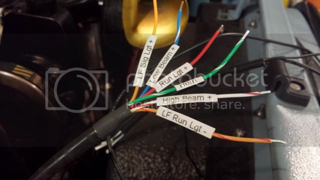

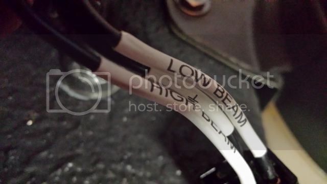

Yeah yeah. Slowly but surely. My buddy has been busy with work junk so we get to work on it one day a week if that. Hes doing a very nice job, got his hands on a shrink wrap label maker so all of the wires are labelled, all connectors are of the sealed doishch sp? variaty and most of the looms have been run. All thats really left is the junk under the dash.

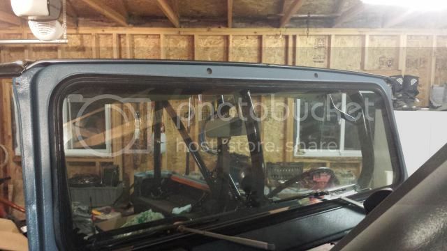

Besides wiring the front got lifted 3.5" with zj coil spacers then after i realized it looked and was stupid we rearranged the spacers so the ds got 1.25" of lift and the ps got 3/4". This got rid of the lean the van had and as a bonus the spacers have lips on them to center the coil spring. The ds front brake line got extended, e brake got adjusted (works mint btw), hood spear got blasted and powder coated, best top window channel got installed... The window channel came with holes for self tappers to secure it to the w/sh frame but since I just finished filling holes and painting I didnt feel like using them. New holes got drilled in the channel that meet up with the hard top bolt holes which makes a lot more sense if you ask me. The irony in all this is that the frame Im using had the self tapper holes drilled in it when I got it but why have 2 sets. Trollhole full bikini in black is on its way which ill probably need since itll probably be snowing by the time I TRY to drive er home.

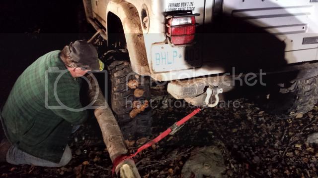

The sixty finally got wheeled last saturday. Did mint but she suffered little more body damage. It now has a nice fist sized dent in the corner of the rear 1/4, the rain gutters are a little more tweaked at the rear corners and a damn stick poked a chunk out of my pass side front fender vent and dented the fender. Oh well it was a pretty great run w good friends. Im just afraid its gonna look like that ultimate adventure dudes crumpled sammy before I get to givin her some love.

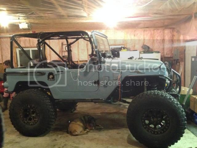

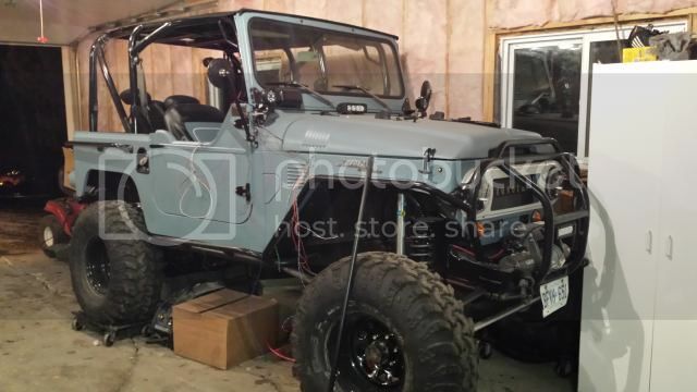

Couple pics of whats been goin on.

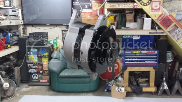

New alt with internal voltage reg.
Wires and such

Bikini chanel
Sixty wheeling last sat. and the 1/4 dent.
Broken jeep axle surfing to get out of the trail.

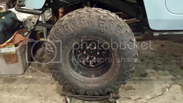

So my buddy rob had a set of 6 to 8 lug adaptors he wasnt using and he dropped them off the other day.... May as well try the 40s from the sixty on for s***s. I wonder how theyll fit. Rims should clear, the steelies on there now are 2.5 bs with a 1/4"spacer up front. The 60 has 4" bsd rims and the 6 to 8s are 2" thick so im figuring id end up with 2"bs if I havent smoked too much crack.
If they fit allright I might just grab a second set of adaptors so I can swap the 40s back and forth. Wonder if the 2f will push em lol. The 529s should make that doable... maybe.

Yeah, wierd spot for sure but we csi'd it and have a sequence of events plotted out that led up to the incident in question. Basically I was lazy and not paying enough attention wheeling some tighter trails. Came too close to a fallen tree and instead of backing up I said fawk it cause Im a genious like that. Tree rubbed along the side of the van then hit the swing out upright and got stuck there pivoting against the rear 1/4. Didnt even stop to look at the damage then, later when I remembered to check near the end of the run I didnt even see it. Came away thinking i was a lucky mofo.... until I saw it 2 days later when the van was in the garage. Oh well, thinking that j lo van ass needs some trimmin eventually anyways.

Well the lawyers got everything settled and I got to go visit the 40 yesterday. Had to help Pete start insulating his garage so I loaded up the 40s and adapters and we tried them on. Gonna have a good aproach with them on lol and the whole 40 looks lower even though its really taller. Looks "right" now. Well soon....

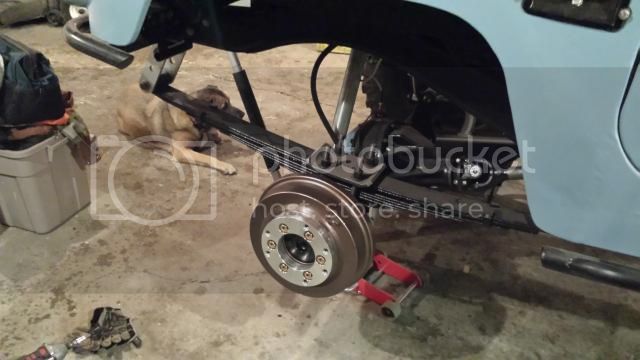

Looks like theyll clear and look sick to boot. Got all excited then tried to throw a front one on and figured out the adapters dont have a big enough bore to clear the hub. Dammit. Gonna bring em to the machine shop with a spare hub and see if they can bore em out a little, now that I got a teaser I wanna run them lol.
Rear
Front

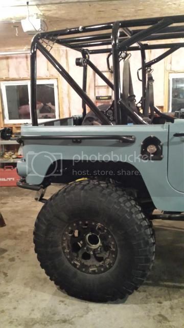

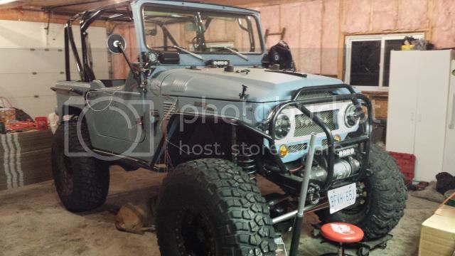

Tried trollholes top on and it fits good. I think my cage must be a little longer than the other cruisers Ive seen with his full length bikini since it just to say reaches the c hoop at the corners. Otherwise fits great.
Best shot I got w the top on..
