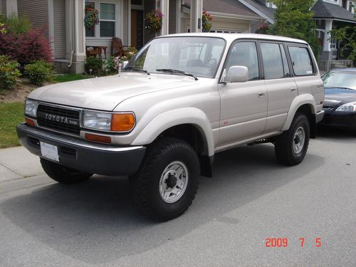

Installed the 2.5" lift yesterday and the 33" BFG ATKO's...looks much better. I'll probably look for swaybar extensions though.

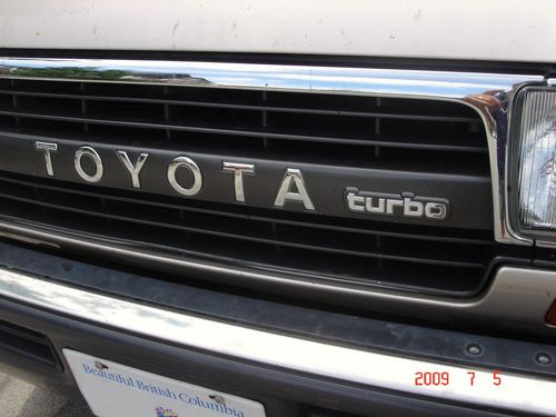

The TURBO badge on the grille is a small clue that what's under the hood is no ordinary FJ80...:)

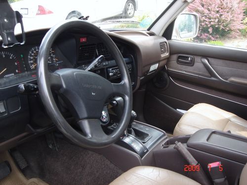

I also installed some mint JDM door panels to replace the original ones that were brutally butchered with the nasty aftermarket vinyl panels...why anyone would do that, I don't know. When my daughter is a little older, I'll swap out the vinyl aftermarket seat skins with a leather kit from Aatlas.
After seeing Tapage's gauge pod install, I decided to do something similar using a Glow Shift universal dual gauge pod. I like the install...clean and easy to see...but there is a bit of glare on a sunny day when the sunroof is open. ISSPRO is still by far my favourite brand of gauges.

WOW what a difference a lift and tires make.
Looks awesome.
Now for the snork and bullbar
nice .. ! ISSPRO turned in my favourites gauges too ..
I have a grey auto console mint at home ..

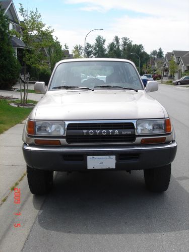

Stone, vehicle is looking nice. I see you have fitted the VX Headlights and bumper and Grill - nice find! My VX-Ltd had all that stuff and it really modernises the vehicle compared with the 4 square headlights.

Actually, my grille and lights are regular North American spec combination lamps. I just ordered the Turbo emblem from Japan (through Japan 4x4 via G&S) and stuck it on there. Sheldon does have a brand new Oz spec headlight set with the four square lights...but I prefer the combination lamps myself.

Shows how Specs vary from Country to Country. The wheels, headlights and bumpers you have are VX/VX-Ltd Spec for 1990-1992 but without some other options... I noticed you had std aircon (ie, no climate control, hence I assumed that you had changed the wheels, bumpers and headlights to the jap spec! Does yours have the toyota front and rear diff locks, speed sensitive steering and sunroof?
Anyway, nice looking rig!
