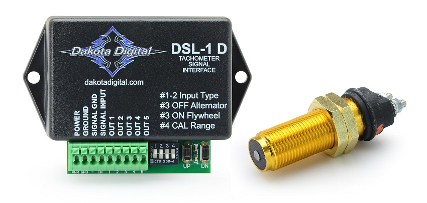

The Dakota Digital converter was the route I was planning on going. After speaking to them they said I needed a tach to calibrate it. I did not have a tach that would work on a diesel so for the same price I ordered the Tiny Tach with the intention of using it to calibrate the Dakota Digital. I ended up selling the Cruiser before I got around to it.
