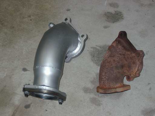

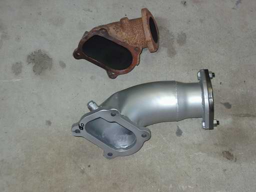

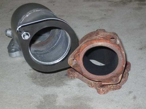

Hows the rig going? I really enjoyed reading about this swap, I have a factory fitted 12HT in a HJ61 (living down under has its advantages!!) my fuel economy is pretty good, averaging 9klms a litre but work is 25 mins away and mostly highway driving (I have a 5 speed manual also). If you can look at putting an after market dump pipe straight on the turbo, a 3" exhaust with straight through muffler and a quality free flowing air filter will make a difference.
My cruiser may not be fast, but it is comfortable, tows my boat and all my gear when I go away on holidays, and with the long range tank (190 litres) I dont have to stop as often when driving 3000klms to Darwin from Cairns... :)
That dump looks sexy! I actually have a 2.5" straight (well, it has a bunch of bends to follow the original 3FE exhaust route...but no muffler or anything) pipe...not sure I really need to go 3"...but maybe when I need a new exhaust.
Glad I read the whole thread first:lol:
Amazing swap there Stone. How much $$ in parts (engine incl.) thus far?
Go 3" if you can, and if possible get an aftermarket dump pipe or make one up. Makes a BIG difference to spooling the turbo up quicker...
