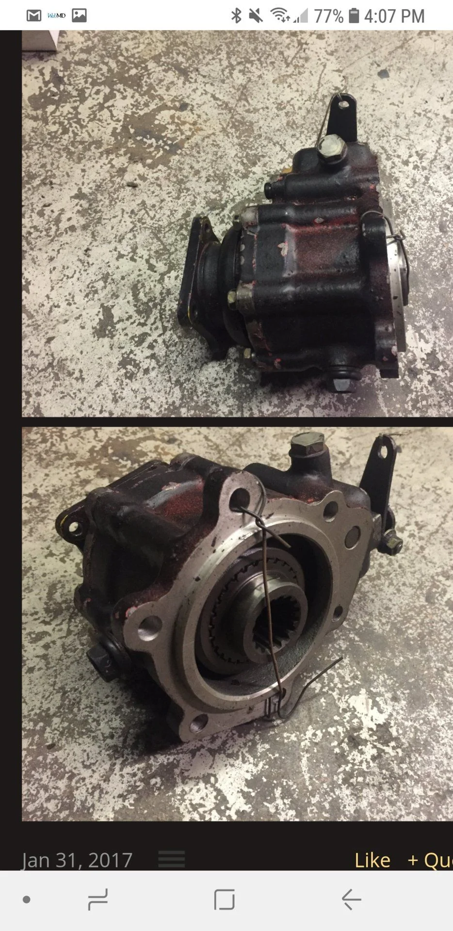

My understanding is that there is just one gearbox, but the PTO shafts can got the front and/or rear of the vehicle.
No there is a second style the bolts to the back of the transfer case and the common style that bolts to the side. The split transfer case not only has nineteen splines the transmission tailshaft does not extend past the transfer case housing and not sure the rear was ever made to fit the with a five speed .
