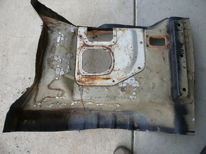

On the 79-82 City Racer sells a raised inspection cover to handle that. On my 79 plan a more extreme solution.

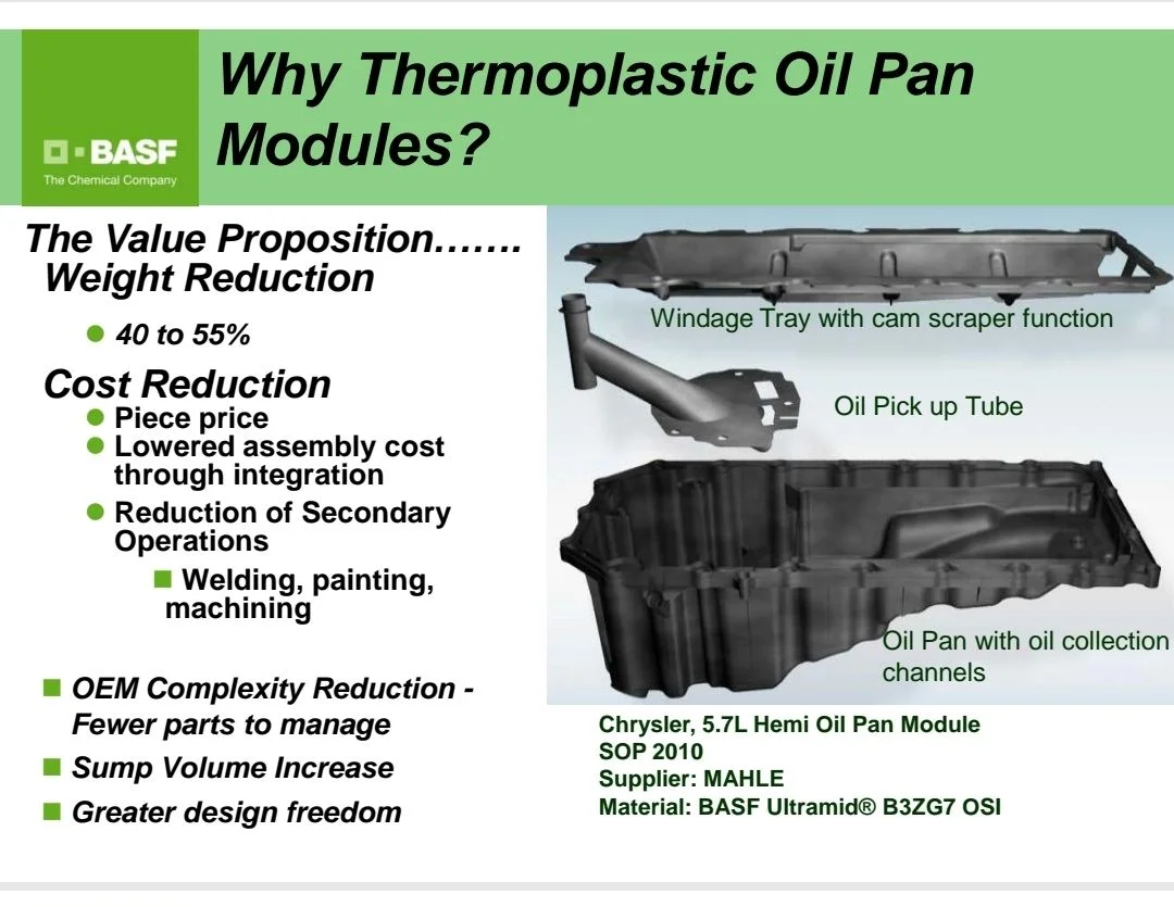

Here is an example of a plastic engine part exposed to high temp oil and underbody conditions.
Agree. I think the current thin metal cross sections near the top would have to be thickened and ribbed/gussetted for strength, so the plastic version would not be 100% visual identical to the metal stock one. So more engineering would be needed.
