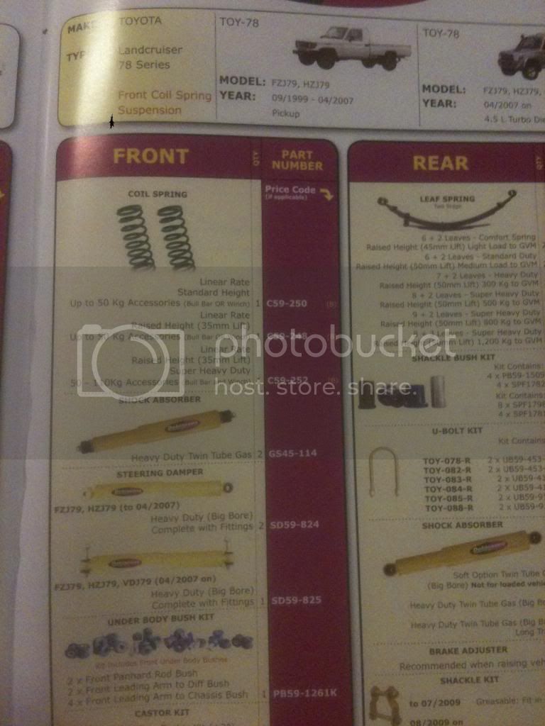

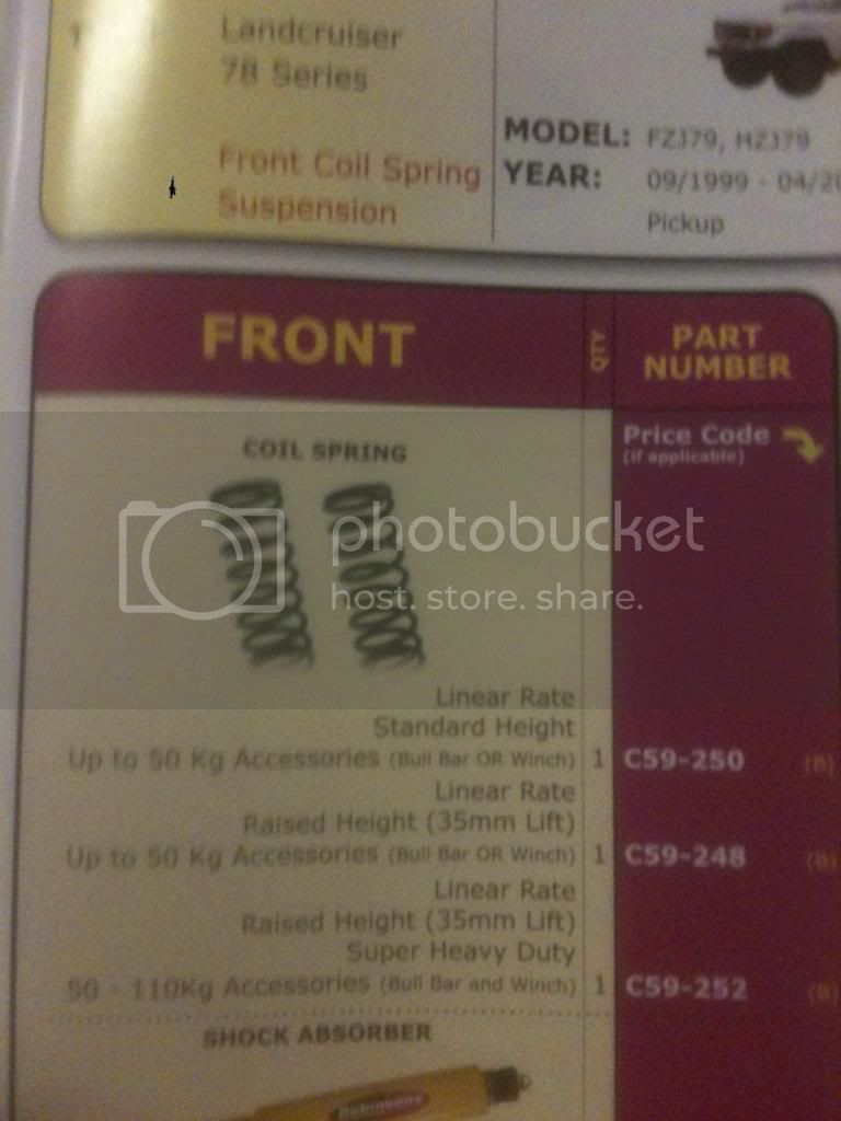

Some front spring considerations and ideas:
Above is from Dobinsons.......just posting for reference.
I also have this brochure downloaded from dobinssons website.
Where is the location of Dobinsons dealer in Malaysia?
