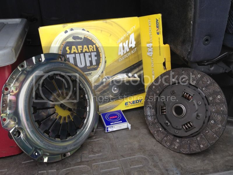

The Clutch...

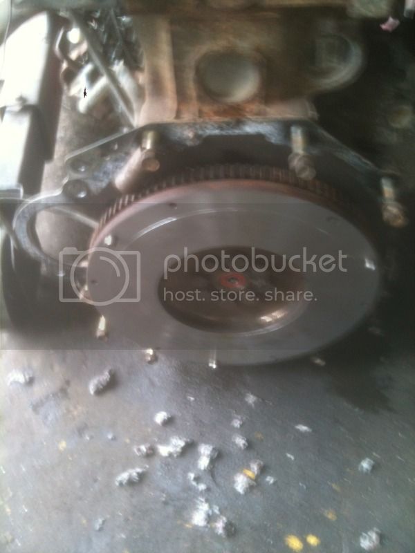

Flywheel skimmed:

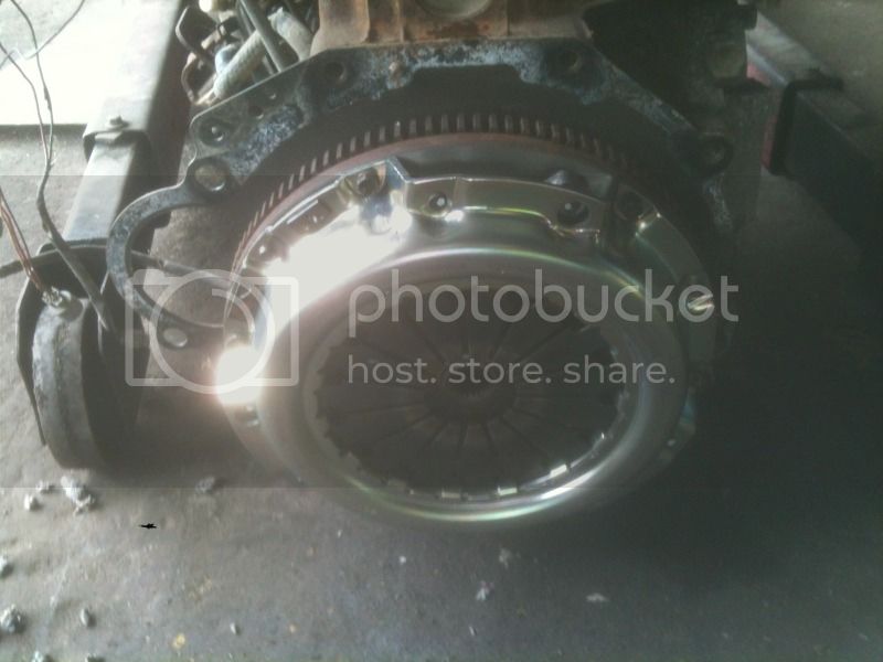

Clutch on:

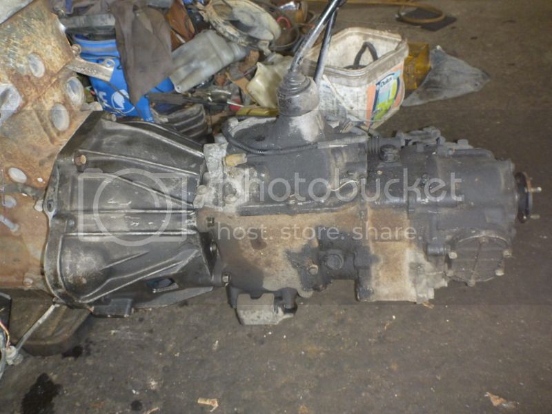

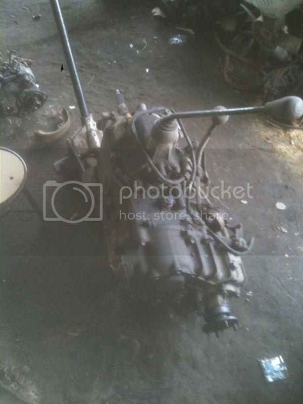

Gearbox:

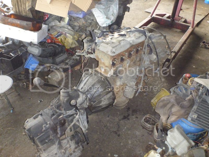

Clutch installed. Gearbox bolted up to engine.
Nice clutch disc and cover!:D
How much did you pay for the tax??:hhmm:
11" or 12" clutch disc?:confused:
Did you order it online or friend from Aus??
How much is the cost?

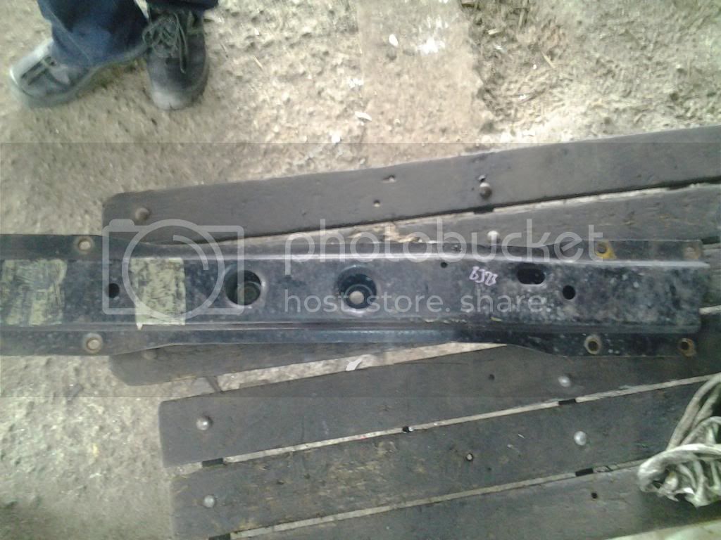

Not so common item here.

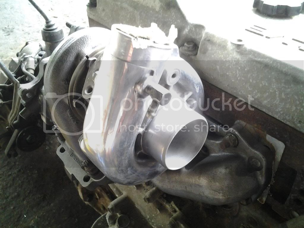

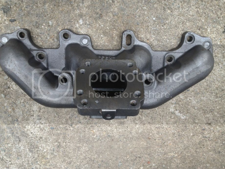

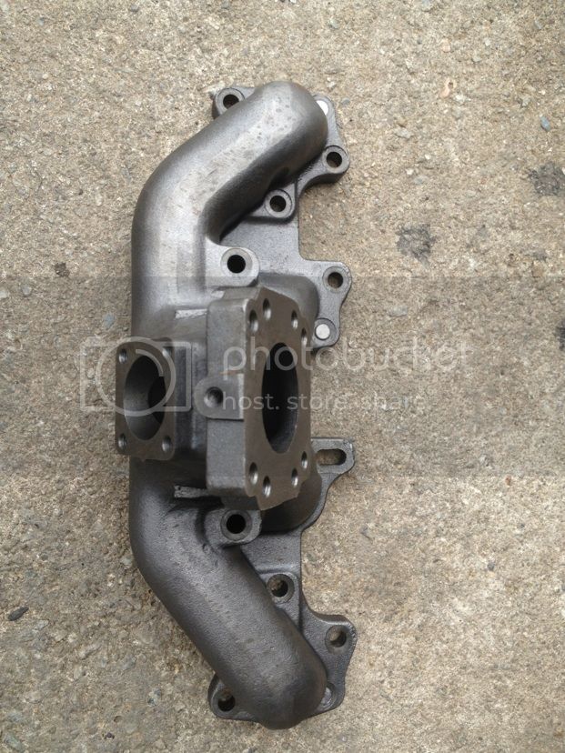

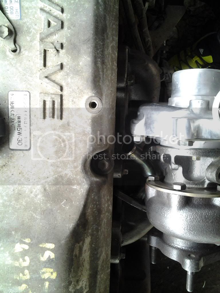

The new manifold arrived about a month ago. This is specially made for 14/15b engines:

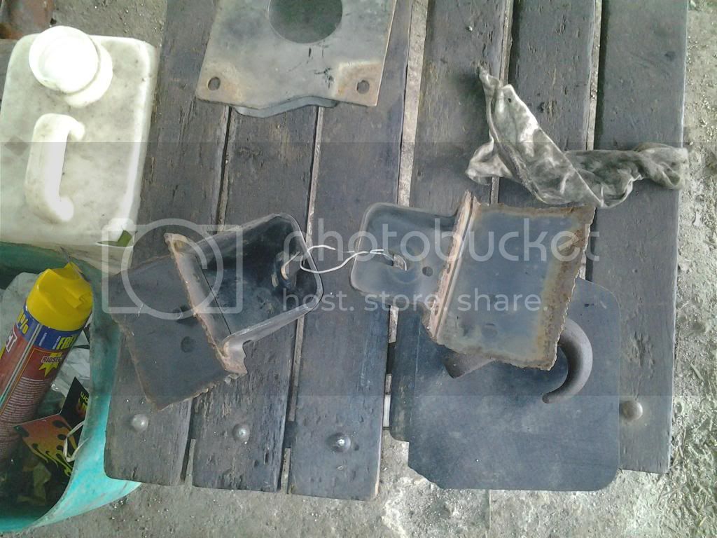

Engines mounts and cross member, from a BJ73:

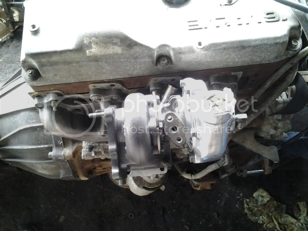

Turbo and manifold bolted up:

Where did you buy the custom made manifold? And the cost of it>:confused:
