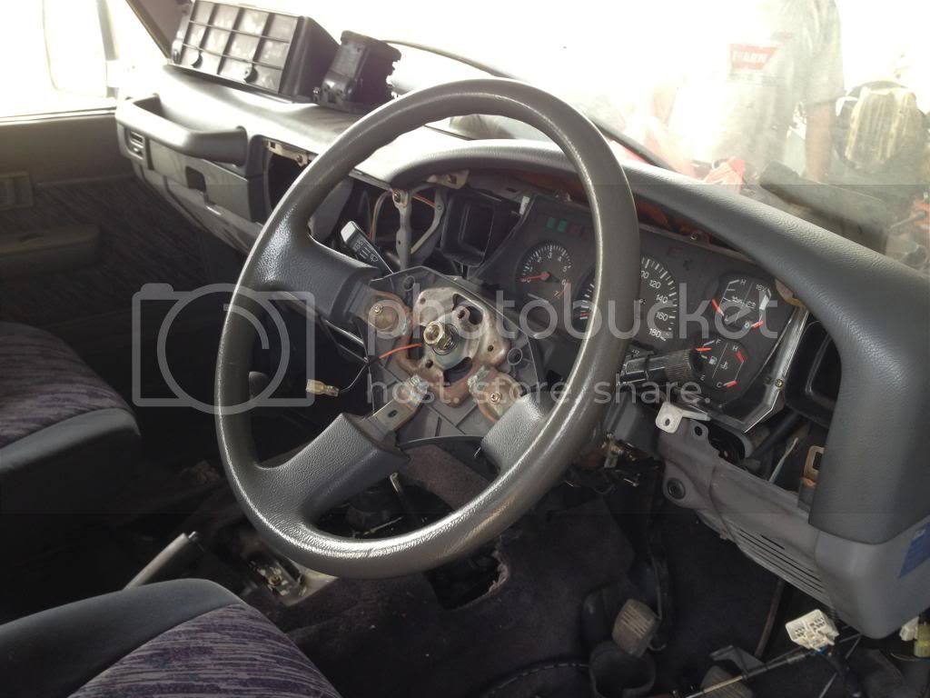

The dashboard is back in:

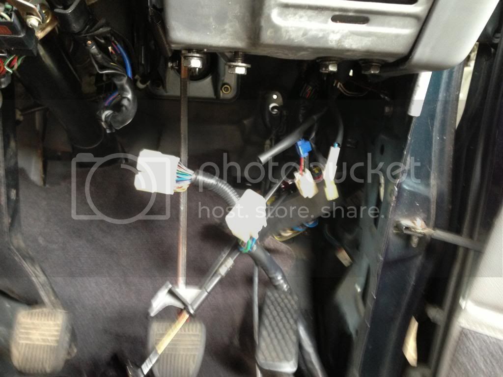

Servo pedal installed for the clutch:

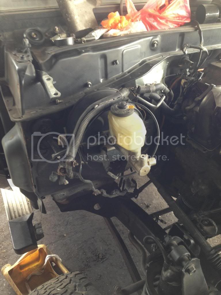

Gearbox from inside cab:
Wiring loom is also well on the way:
