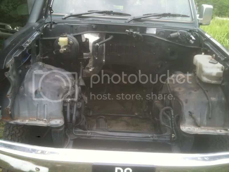

Dash taken out for wiring.
Planning a slow buildup for expeditions.

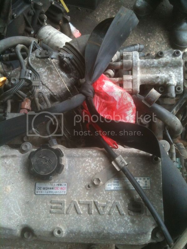

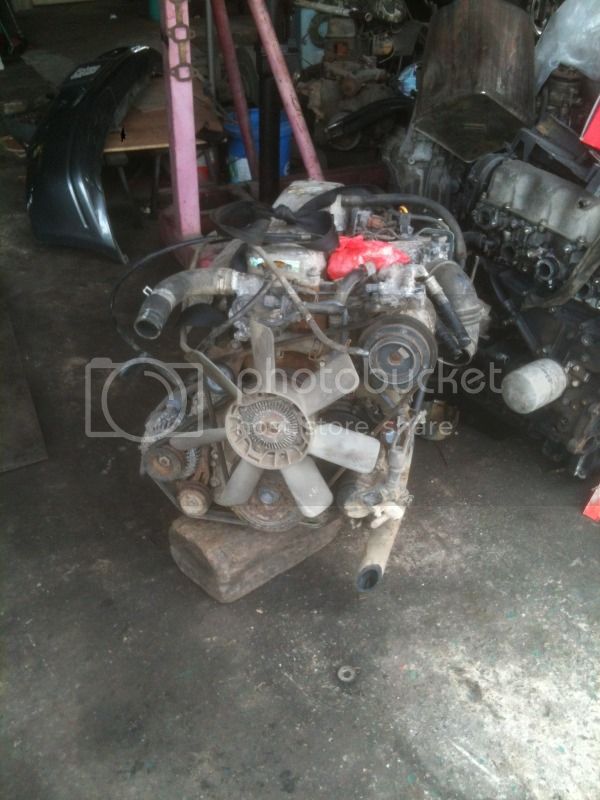

As promised here's 3 piccies of the 15b engine.
Next fuel pump has to come off and be sent to Sabah for mod and tuning. Also a turbo to be sent for same process. This will take about 2 weeks.
Gearbox is present and is from a 60 series having a 3B. H55F.
What is the mileage of this engine?
From Dyna truck or megacruiser?
KK is the "notorious" place of this 15B, everything mod to them is at the finger tip.:steer:
Didn't see your box?:confused:
Km was 170k. This is from a truck. The units from the megacruiser are far too expensive now.
